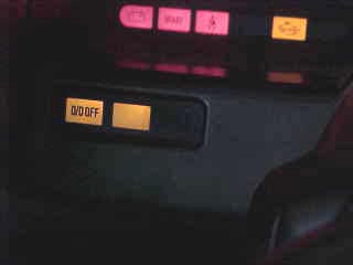

1. Have the engine at normal operating temperature, in P with the overdrive switch on.
2. Start engine. The AT light (1.) should go out after 2 sec.

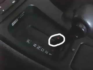

4. Move selector to drive D by using the Push Release button (2.). If not equipped, use the brake pedal

12. The codes will begin to flash. There�s one long flash that signifies the start of the sequence. Following should be 10 short flashes. Then it repeats.
1.AT light
2.Shiftlock
