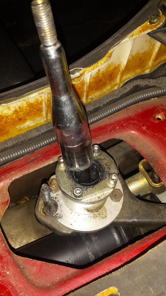

expected to find broken rubber shifter mount but it was ok
Slothboy2
20:16:22 05/12/18
The fork support bracket has a bolt that pushes up through

check this out. Whatever used to be here looks disintegrated

not an OEM shifter, looks like a Z1 short shifter.
itsa300zx
19:50:22 05/14/18
Solution: ZSpeed Solid Shifter Kit

My Z1 short throw shifter did the same thing in about
