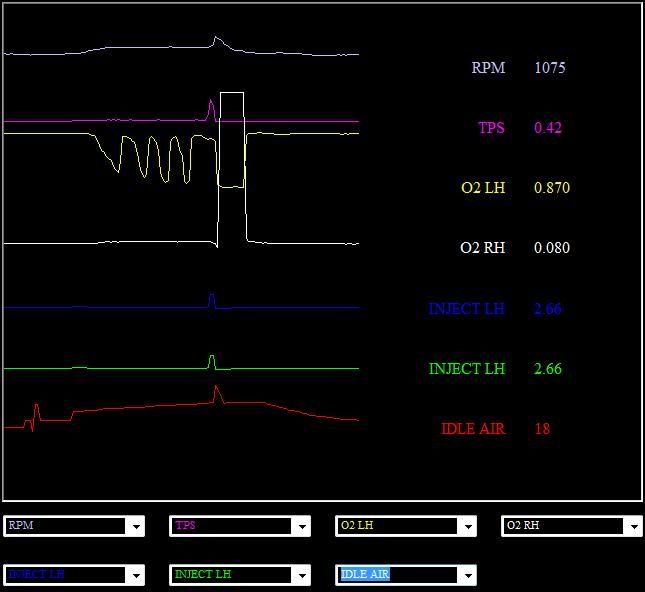

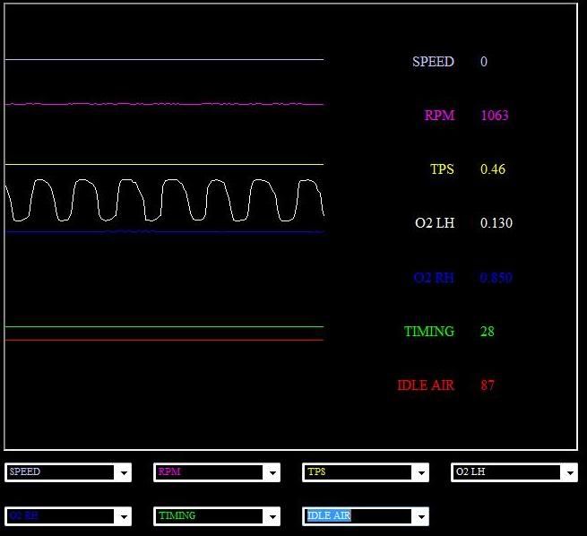

For instance here is a picture of when my NA O2 sensor was bad (about 3 years ago)
You can see LH running sinusoidal like it should, RH is flatlined.
