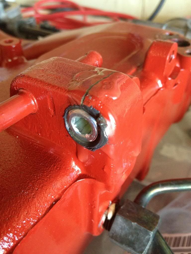

Message This is how I know that you shouldn't overly tighten the NPT plugs on the manifold...
I filled the crack on this plenum with epoxy and had no problems. Luckily I have multiple upper plenums laying around so I'll probably put on a different one this time around.
