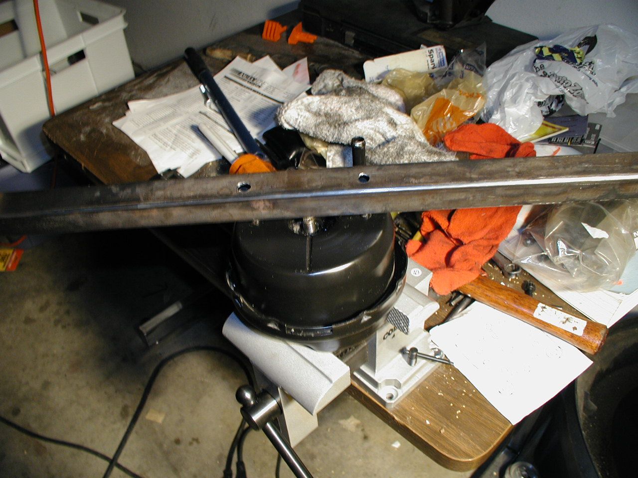

Message if it is below spec, the reaction disk inside the booster has fallen out.
The rubber disk sis to the right of center in this pic:
The booster can be separated and reassembled by twisting the booster apart:
When this happened to my booster the clutch pedal would flutter.
