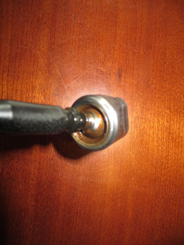

Message the wheel bearing but a worn tie rod end where it joins the HICAS eliminator. this worn bearing allowed several mm of postponing of the tie rod end.
replaced tie rod end with a new one and problem solved. Oh well, replacing the rear wheel bearings was fun!
