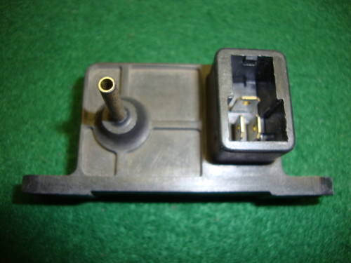

I found out that the boost sensor that is in the FSM test procedure is actually the boost sensor used in the Z31 300ZX. The boost sensors in the Z32 are also the same boost sensors that are used in the Skyline R32.
Here is a picture of the boost sensor used in the Z31 which is the same one depicted in the Z32 FSM test procedure.
Here is a picture of the boost sensor used in our Z32's.
