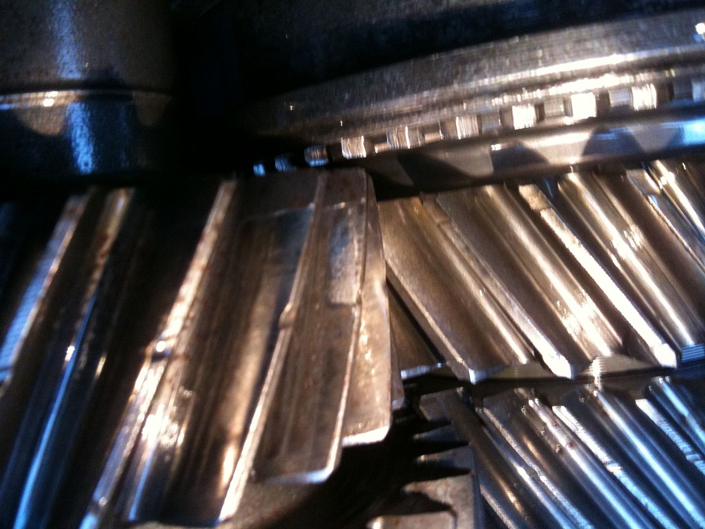

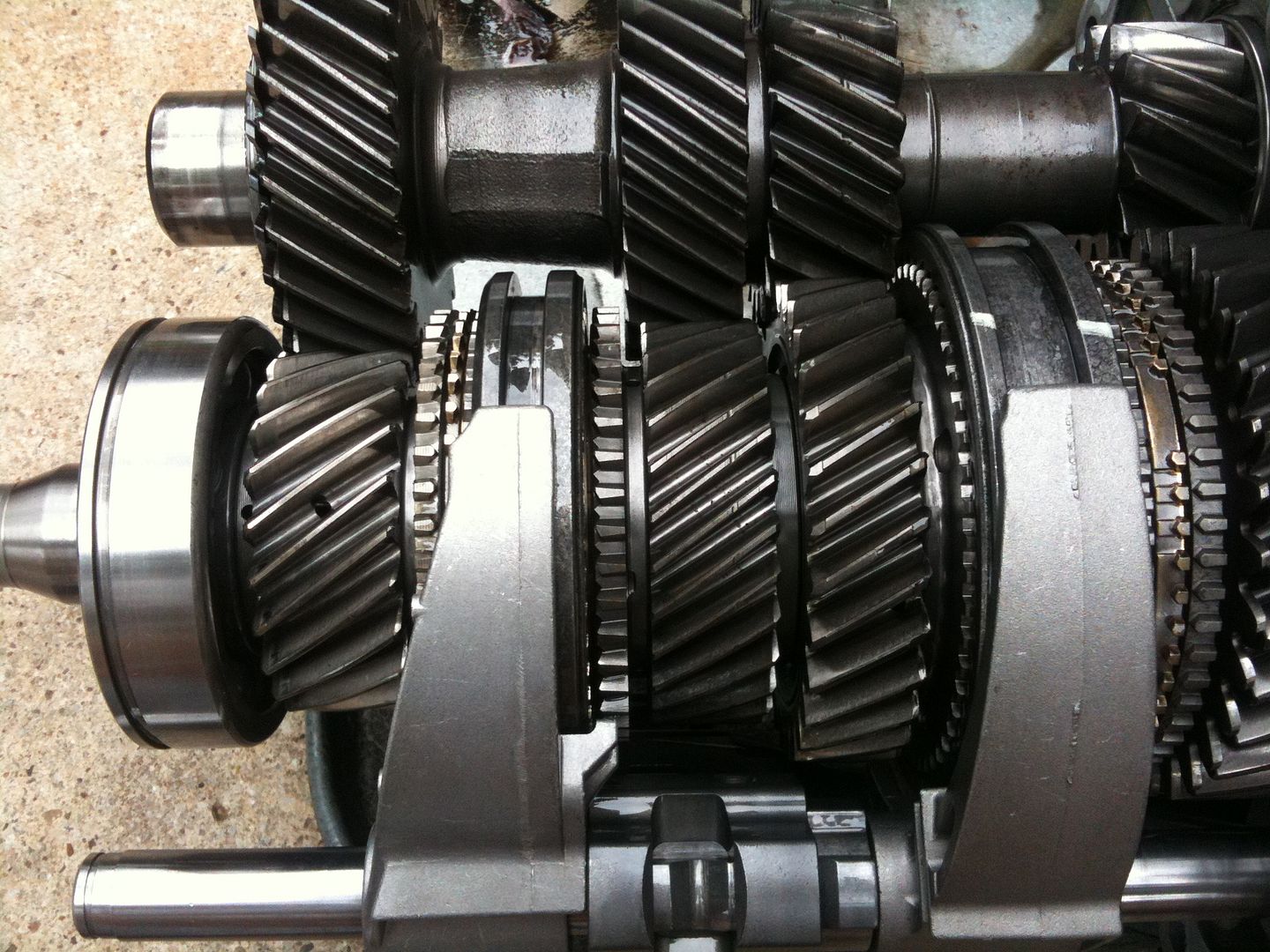

Message I pulled apart my transmission...I see some unusual wear on some of my countershaft gears
All of the wear seems to be on the countershaft....wondering if there is some sort of defect in the hardness of the countershaft in some of the 98 spec trannies?
I'll order another one, and may have it WPC treated while everything is apart
