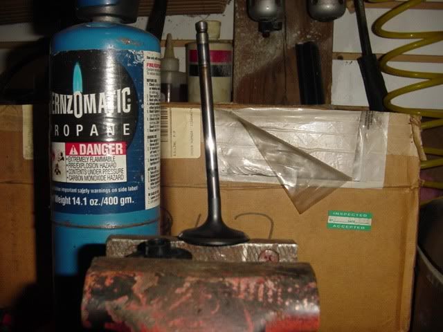

TwinTurbo.NET: Nissan 300ZX forum - I had 0psi... found a bunch of these.. (see pic)

bent valves... 1 of many

I had 0psi... found a bunch of these.. (see pic) -

yup that is what i am expecting to find (n/m)

Before you go too crazy here - have you verified that

compression gauge is good.

Bend valve or timing timing is off just enough.

2nd,.Check T-belt first. Numbers are too strange. (n/m)

I like the idea of timing being just a little of.

If your timing belt is off some teeth, it means that a valve

Well thank you all guys. This discussion was very helpful.
