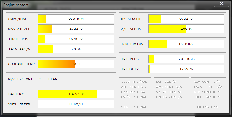

Note: I know in this screenshot it shows that the TPS's idle switch is off, it's actually on (as verified in Nissan Datascan). This is the trial version of Conzult, and doesn't show any of those switches/sensors.
I've tried putting conzult in work/support mode (base idle adjustment), and disconnecting the AAC connector, etc. I've cleared Self-Learn, and reset the ECU.

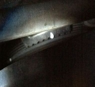

Here's where the timing light lands (I marked the indicator on the (stock) crank pulley and 15 degrees on the timing belt cover thing):

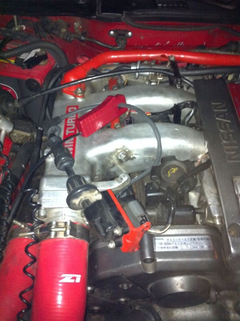

I've tried getting the timing from the PTU loop, the #1 coilpack connector, and using a high-tension (spark plug) wire between #1's coilpack and spark plug, exactly as described in the FSM:
The "CYL #1 --->" arrow on the induction pickup is facing the correct direction.
