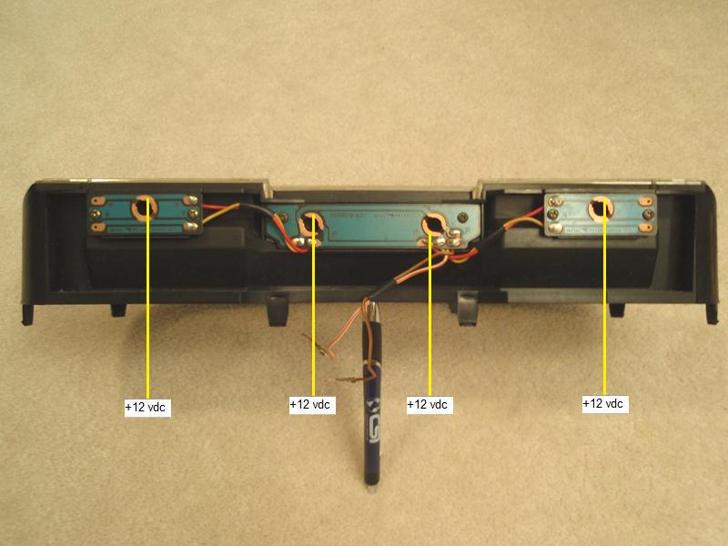

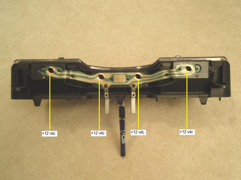

Message These are +12 vdc locations for two types of gauge clusters for the five large lamps in the back of the gauge cluster. Replacing these with colored LED lamps will change the color of the numbers, tick marks and lettering but the needles will stay red.
These are +12 vdc locations for the 5mm lamps along the bottom of two types of gauge clusters which are used for back lighting.
