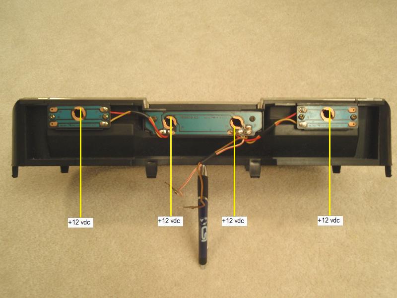

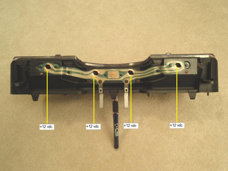

Message Here are two types of gauge clusters. I have marked the +12 vdc locations. The lamps for these locations are 5mm NEO5-x from the vendor in my write-up. You will also need to do the LED lamp swap as shown in my write-up.
