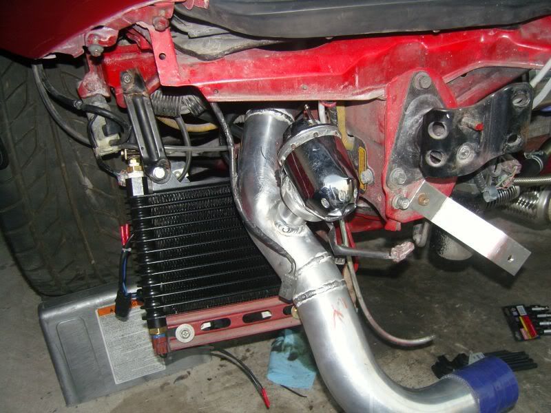

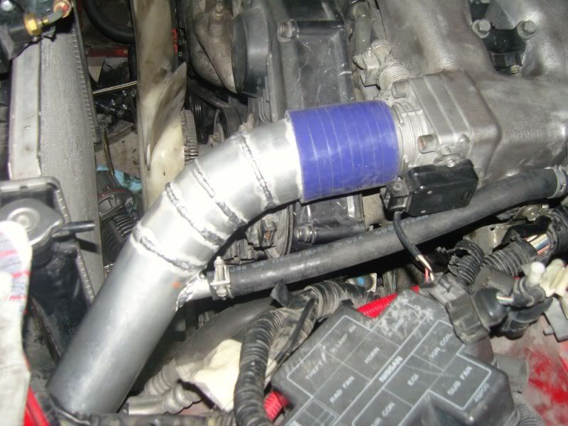

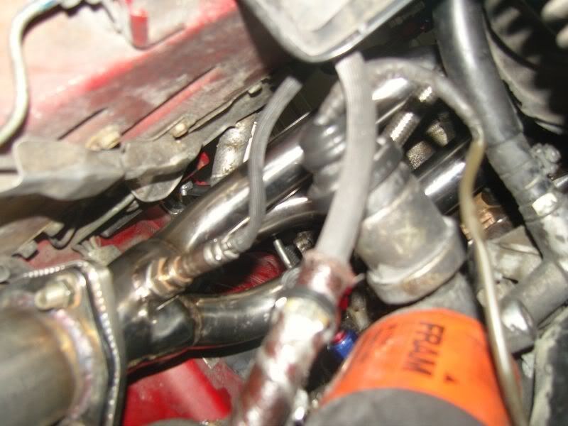

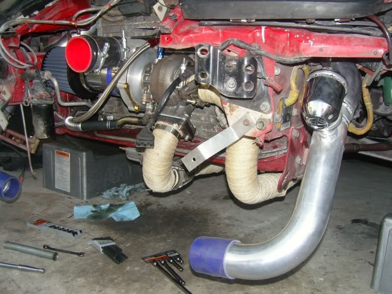

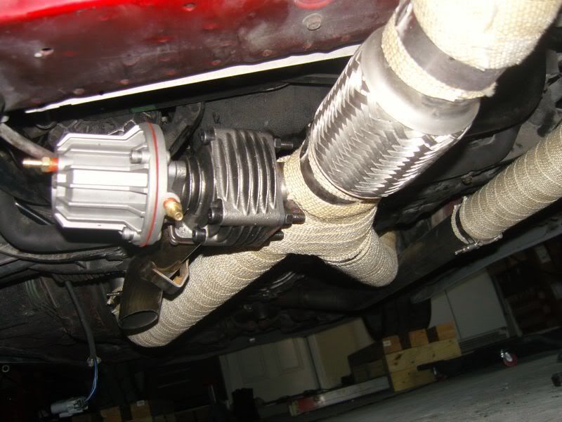

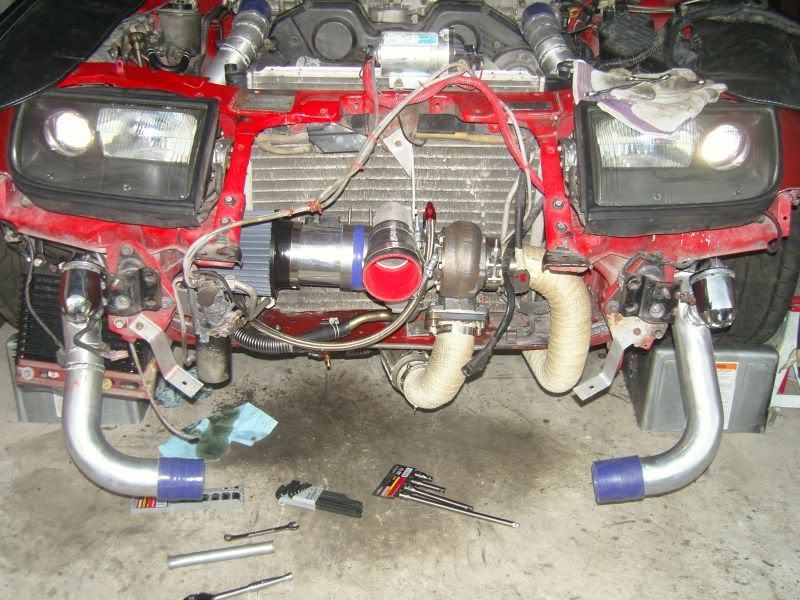

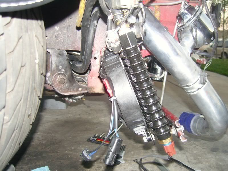

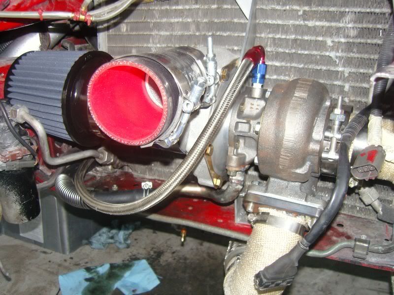

Message Just a quick update....she is nearly ready to fire up!!
Things left to do:
Heat shields.
Wrap aluminum intake wipes
Make air duct from fog light cover to oil cooler.
Re-postion water/meth pump.
Connect air air hose for boost control.
Connect all wiring connections.
FILL WITH OIL!!!!
I had to tilt the turbo very slightly so the air filter would clear the A/C ...tank...thingy...accumulator...arr..you know what i mean.
Possibly i will fire the bitch up tomorrow if she's a good girl...
