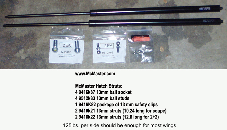

4x 9416K87 13mm ball socket
4x 9512k83 13mm ball studs
1x 9416k82 package of 13mm safety clips
2x 9416k21 13mm struts (10.24 long for coupe)
or
2x 9416k22 13mm struts (12.8 long for 2+2)
The 125lbs PER SIDE are firm and are enough for most ANY wing on the market. The 150lbs per side are stiff and will take some force to close. Anything more then that is OVERKILL and not recommended unless you have an especially heavy aftermarket wing - typically this is NOT a case of "bigger is better".

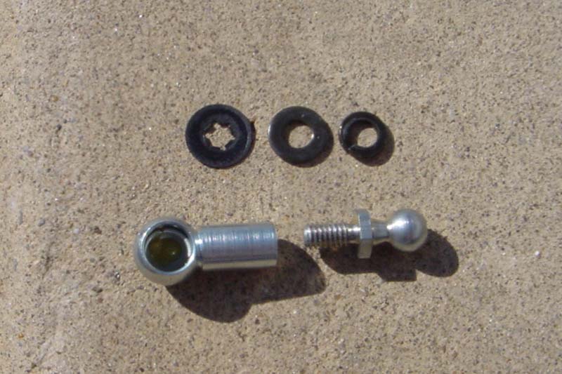

2. Save the stock lock washer, flat washer & plastic washer from the factory struts.

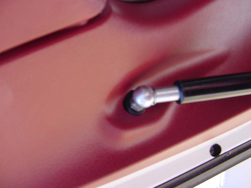

3. Install the McMaster 9512k83 13mm ball studs using the 13mm deep socket in all 4 stock mounting locations. Be sure the reuse the 3 washers listed above and I like to add a drop of Loc-Tite to the threads. They are a snug fit, be sure not to cross thread or over turn it as the hatch metal is soft.

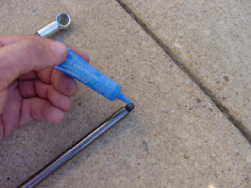

4. Apply Loc-Tite to the ends of the McMaster 13mm struts and screw on the 4x 9416K87 13mm ball sockets.
5. Snap the 4 struts over the 4 ball studs you installed in step 3. The stock struts are mounted so that the gas cylinder end is on the hatch and the moving rods are attached by the 1/4 windows.

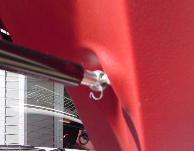

6. Slip the McMaster 9416k82 lock clip's straight end into the 2 holes on the side of the ball socket.
7. Swing is closed so it snaps over the shaft of the ball socket right under the round head. Repeat on the other 3 ends.
