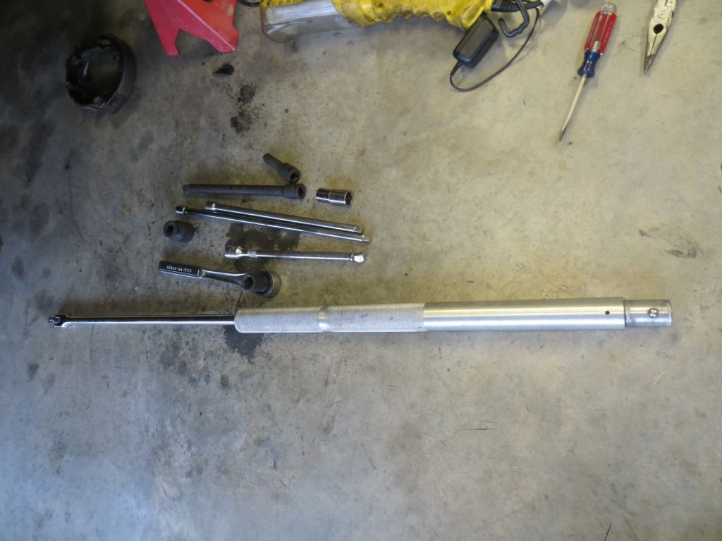

basic hand tools, pliers, screwdrivers, hammer, socket set including 36mm and 27 mm, multiple socket extensions, impact wrench helpful, torque wrench, Long breaker bar

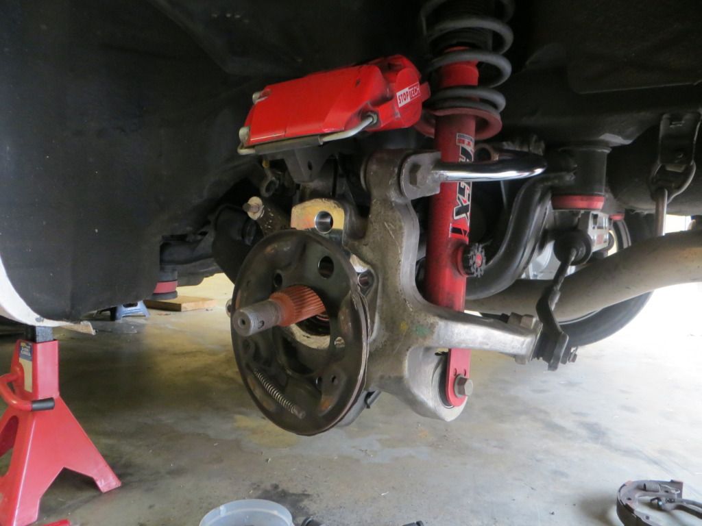

3. Remove caliper and support it with wire or zip tie to prevent tension on brake line. Remove rotor

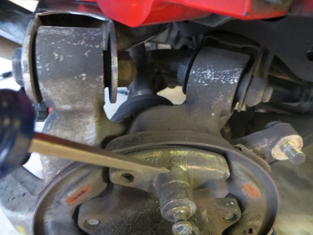

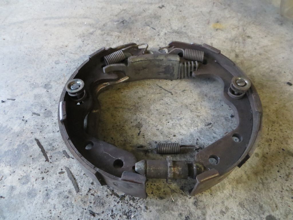

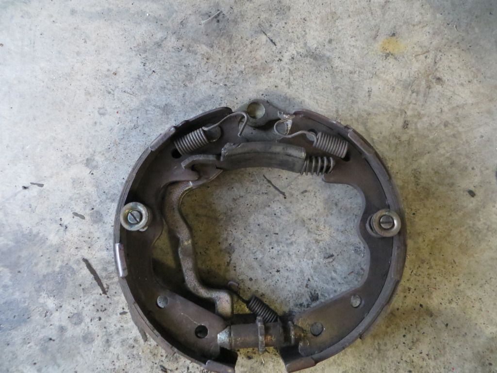

4. Remove parking brake components- i suggest taking pictures from several angles for later assistance in reassembly
here are a couple of pictures for reference
5. Use a piece of wood and a 3 lb sledge hammer to knock axle inward

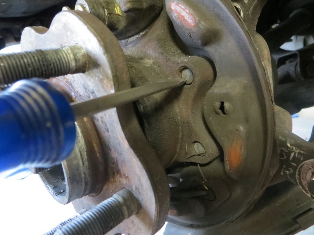

6. Remove the 4 19mm hub bearing retaining bolts. This is the most difficult step. There is not enough space to use a thick walled impact socket, only a standard socket will fit. While pushing the half axle inward, a standard 19mm socket will fit over the bolt. Use various combinations of socket extenders and a breaker bar to remove these 4 bolts.
7. Remove the 27mm nut holding the brake anchor. This required a 3 Ft. breaker bar and half of my jack handle.

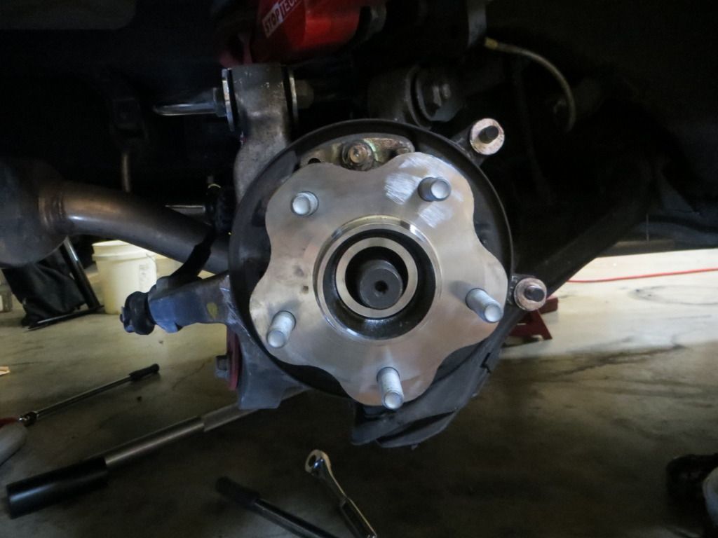

the wheel hub will now come off

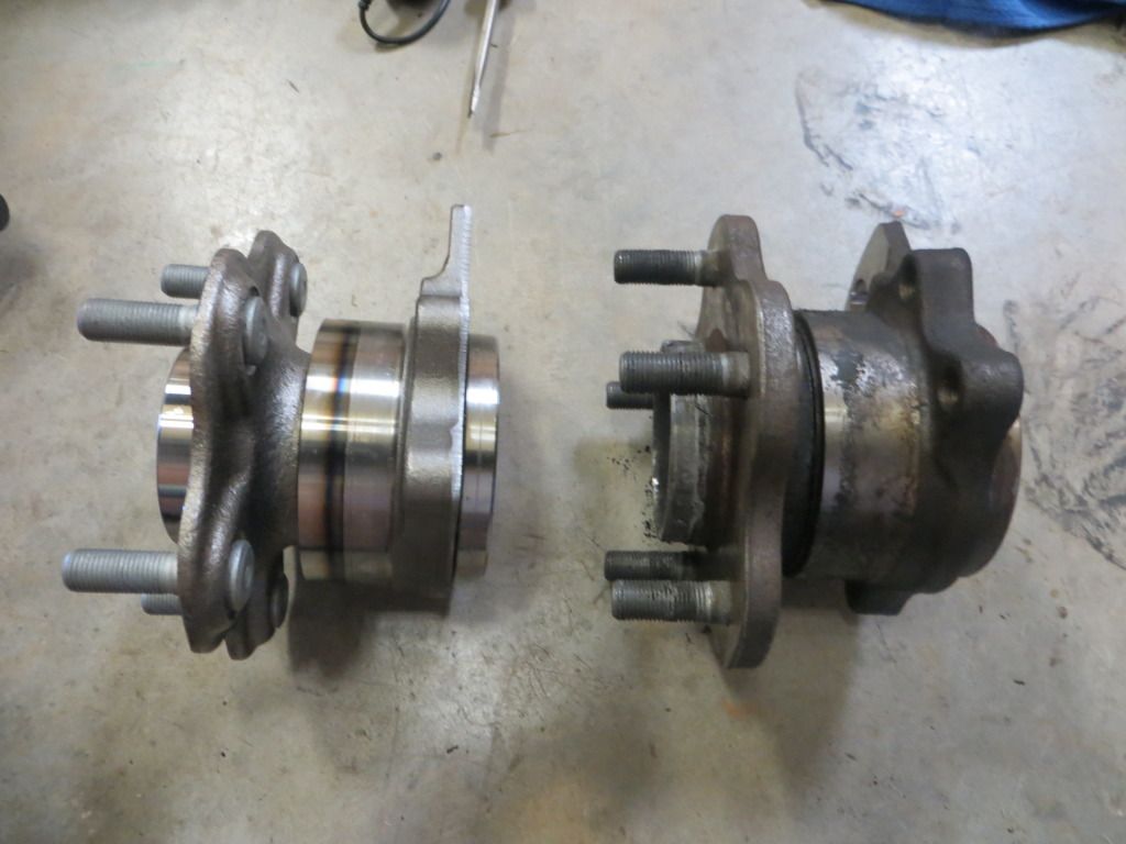

8. Have the bearing pressed onto the hub. I replaced the hub as mine was scored
9. Replace the hub/bearing assembly. FSM torque spec for 19mm bolts 58-72 ft/ lb . Torque 27mm brake anchor nut to 159-224 ft/lbs.

11. Reassemble parking brake
