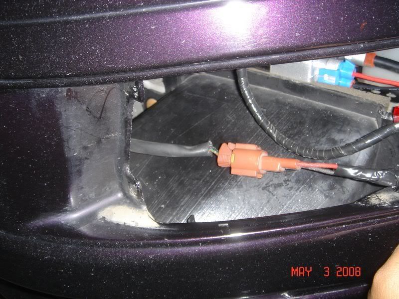

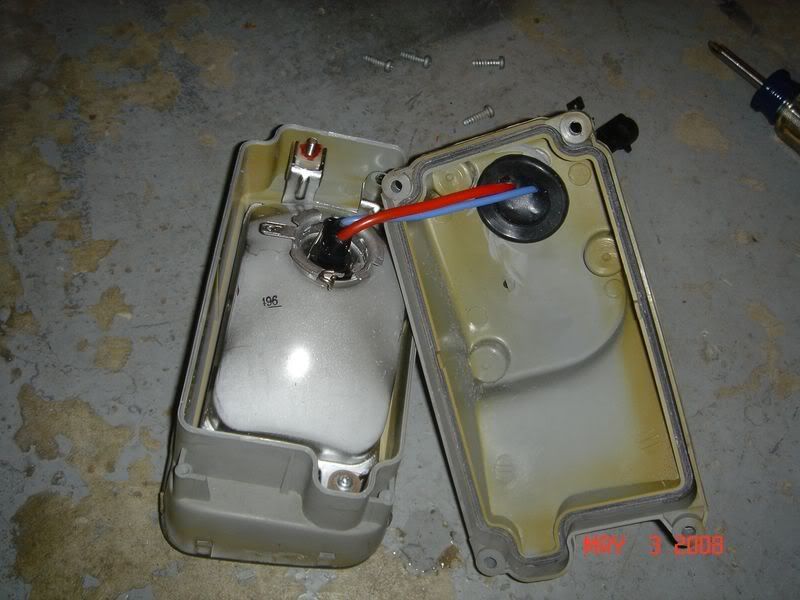

Message Install is pretty easy. All you do is dremel out the back of the fogs where the original connector is and then use the provided grommet in the kits that I sell. You then put some female spade connectors on the plug that was originally on the fogs and you connect those to the ballast connector. From there, put your fog's back in and your done.
I have had alot of people asking me how the install was on the fog's because they herd it was Hard to impossible to have H.I.D's in the fog's but this is proof on how to do it and that it is really not hard by any means.
