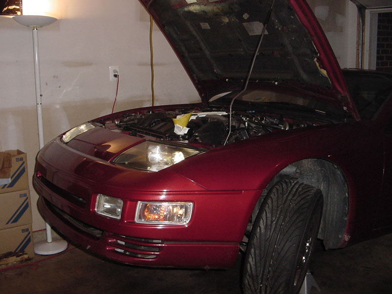

The patient, John's 90 TT:

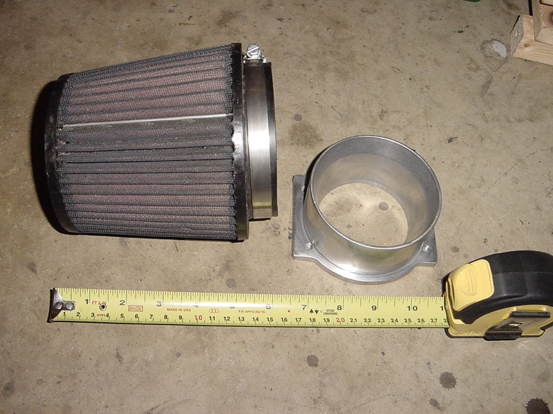

"Just say No to ghetto eBay filters", this thing is dinky compared to a JWT Pop.
"You know you fucked up when you have a Polak under your hood."

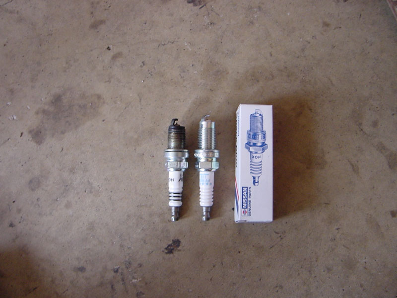

"Mommy - why do Iridium plugs suck? Becasue they are too damn short:"

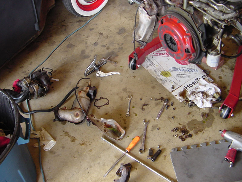

Anyonw know who makes a clutch w. a red cover?

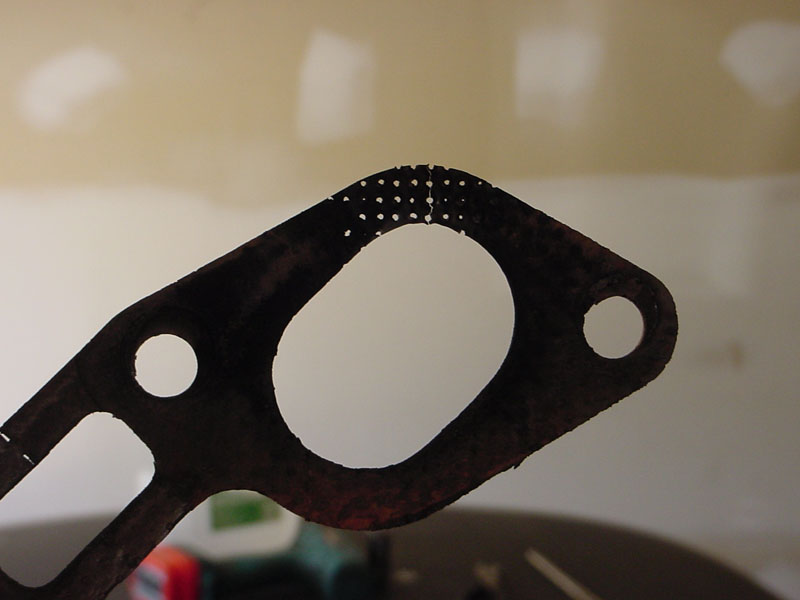

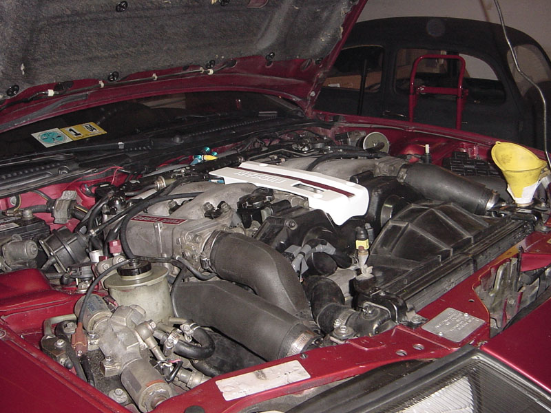

The reason for all this in the first place: blown out exhaust manifold gasket:

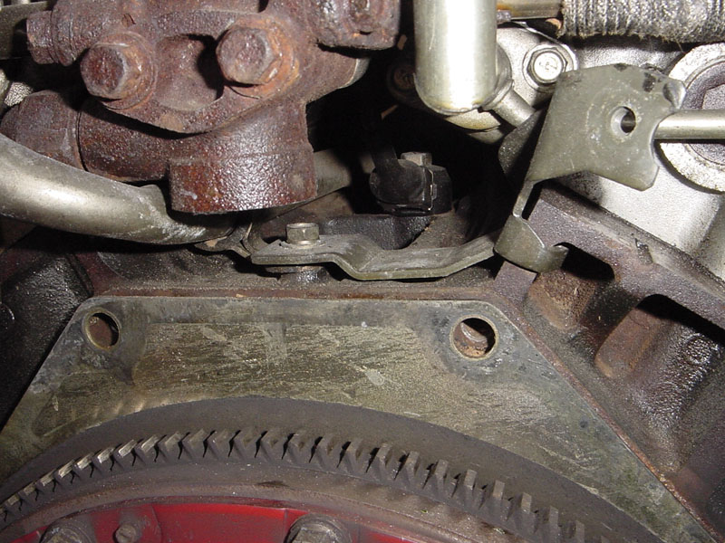

Ever wonder where the detonation sensor hides?
Try not to drop that:

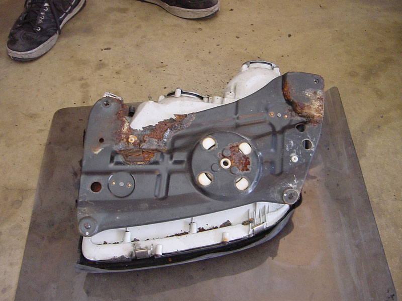

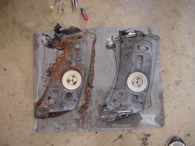

Anyone ever seen this kid of corrosion to a head light mount?
Installed and ready:

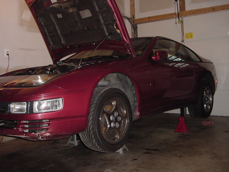

Sporting a new (used) fascia that even was the correct color.
All in all this project took about 3 days, I worked all 3, Kaz 2 and Spee did the tranny reinstall.

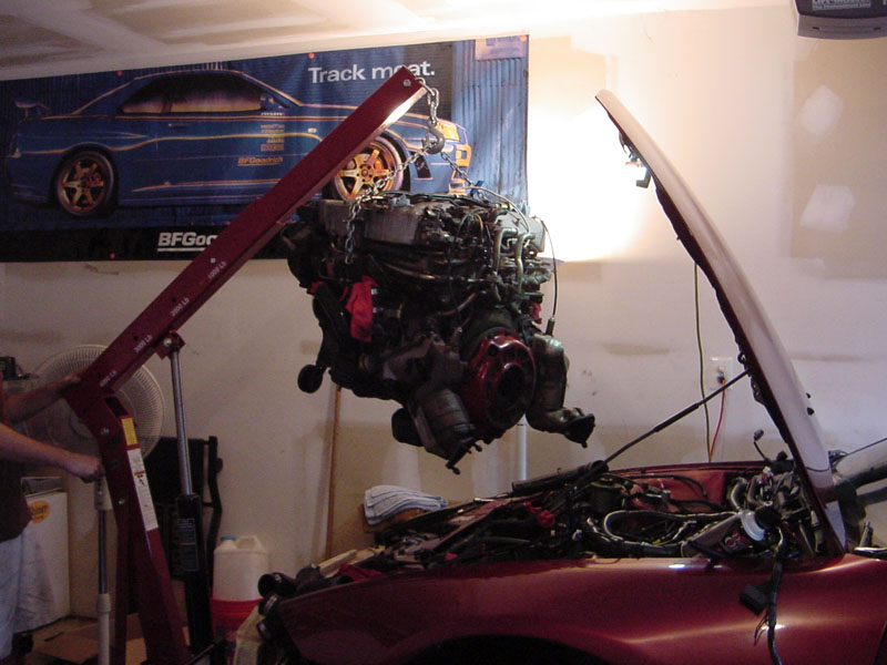

Remove engine

remove & repair both head lights, install HID under fascia, replace fascia

We found a lot of cut corners on this one, and it took a bit of time to fix the things we found... including a LUG NUT in the engine bay (none missing on the car's wheels) for those of you "take of the timing belt cover" types. Car test drove well and pulled 9 and 15 lbs w. out issue, so far so good.
