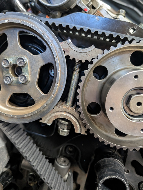

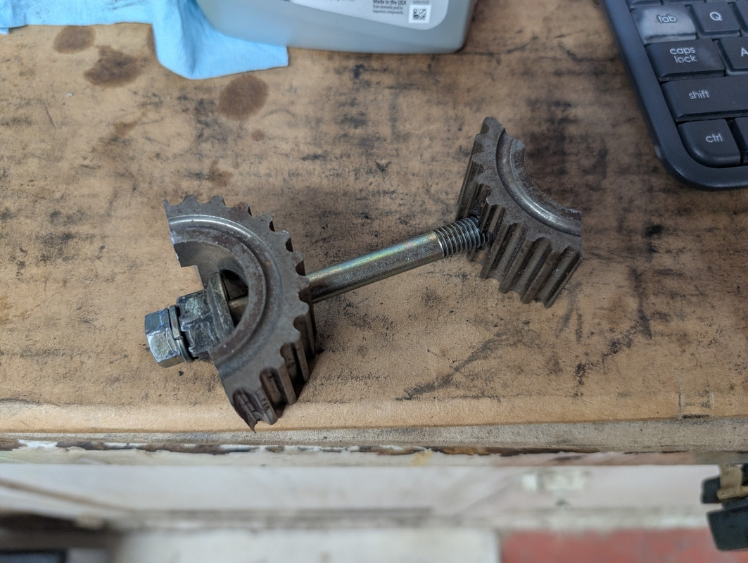

Message Made one for a recent cam seal job and it worked great. I used what I'm pretty sure was a spare long bolt from the main trans bolts, also used a big castle nut as a washer. Happy to have it in the tool chest for sure, just need to clean up the edges on mine.
