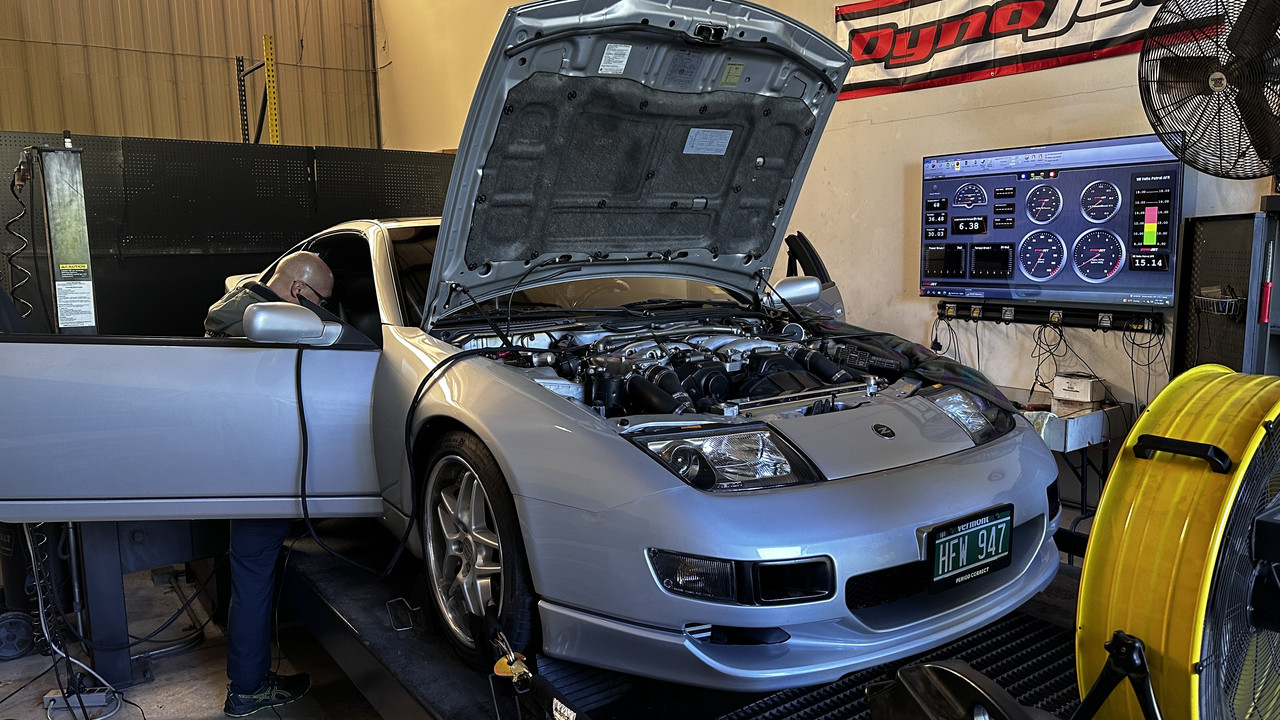

Message Since Seb & Greg were going to be back on the east coast, I couldn't pass up the opportunity to get a tune after the most recent updates to the car (turbos, Haltech, crank trigger, fuel pump, etc).
I drove from VT to DE this past Friday (8.5hrs), got tuned Saturday morning and drove back Saturday afternoon (7.5hrs).

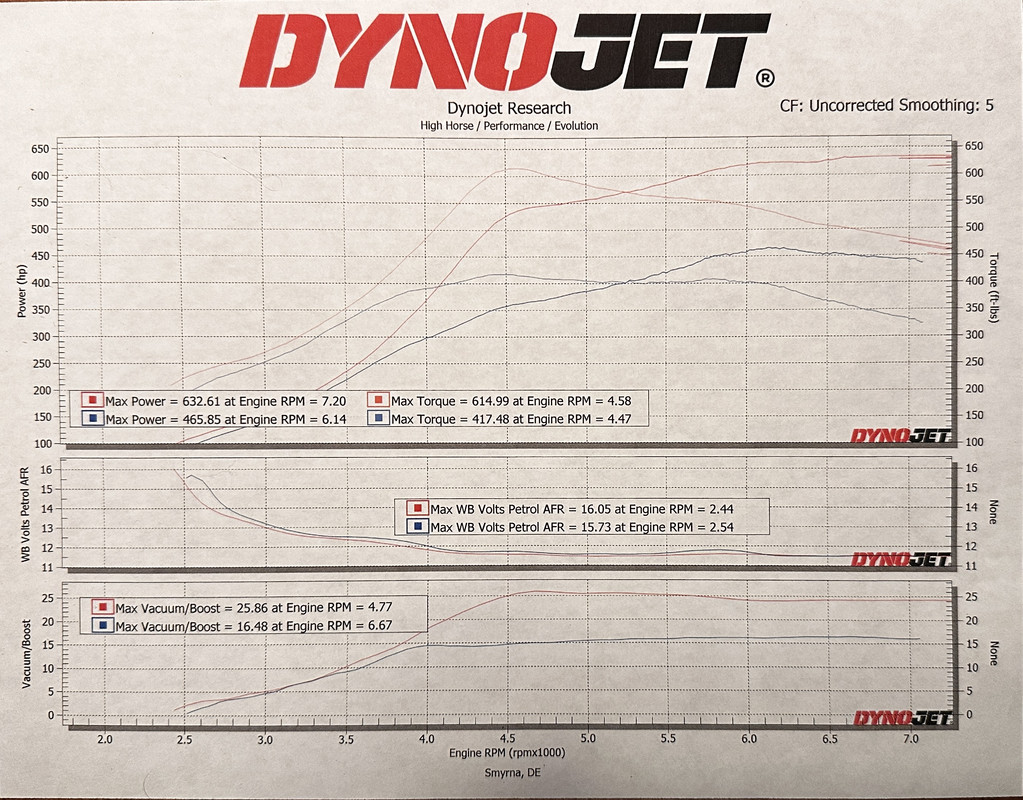

Overall, she performed great. No drama besides the JWT clutch starting to slip a bit at 600whp/tq. Otherwise car runs better than ever. Thanks to Tony for organizing and the SZ team for the excellent work, as always!
High boost (25psi) was on e85.
Lower power was the baseline we started with.

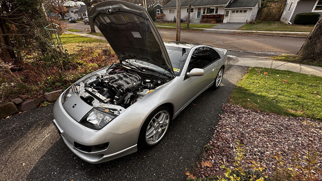

One last wash for the season once I got back.
