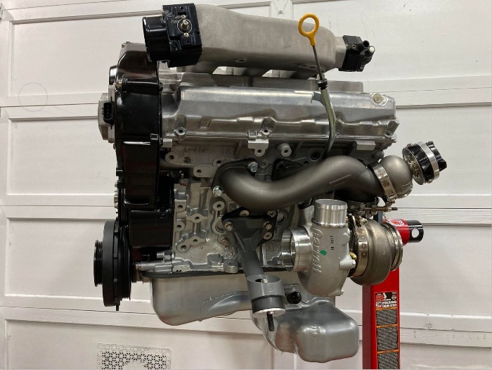

As I mentioned in my first post, I am currently working on mass producing a v-band exhaust manifold kit for Z32. As this point, the first set of manifolds has been completed. CNC machining jigs have been built, CNC programming finalized and casting have been machined. These manifolds have no weld-on flanges on them. V-band flanges for both the turbine and wastegate side are machined into the casting.
I am attaching a couple of pictures to give everyone an idea of how things are positioned. Driver side is displayed in photos below to show a reverse rotated turbocharged with compressor discharge port pointing up to eliminate a 90* adapter that is used in that location from the factory. Manifolds are mirrored, so the passenger side will be a mirror version of what you see here.
