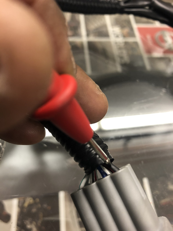

Message Black wire with red stripe at the injector subharness connector ...
9430935-E-2-BA8-4892-A792-CB8-E1-FC30965

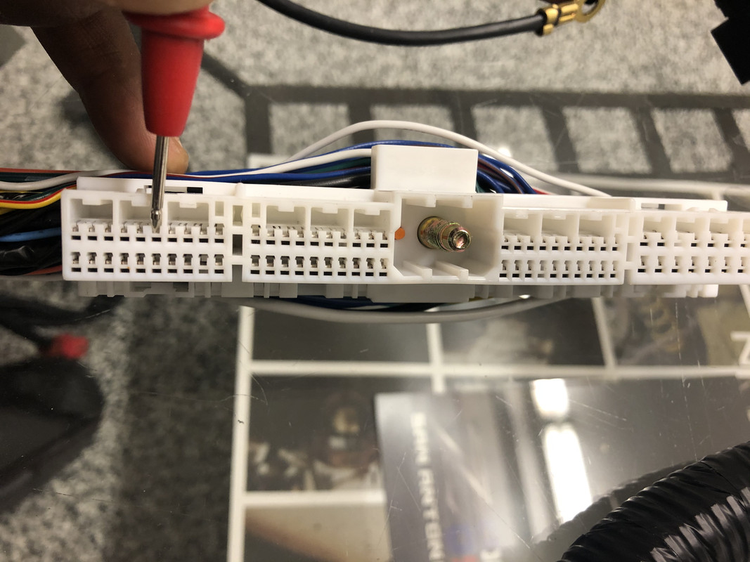

...with continuity to pin 45 ...
497-CC32-D-66-C0-429-B-A395-B4-AADEC80-B27
...matching black wire with red stripe on the back of 45...
01-D7-E064-89-C0-4-FB1-8-B08-F3-CC49-C0865-A

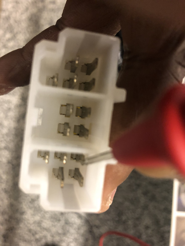

...and continuity to this pin on connector F2 (also black w/ red stripe, soory no pic)....
380455-DA-C92-F-488-C-B71-E-0-DD2-E2-D587-CF
