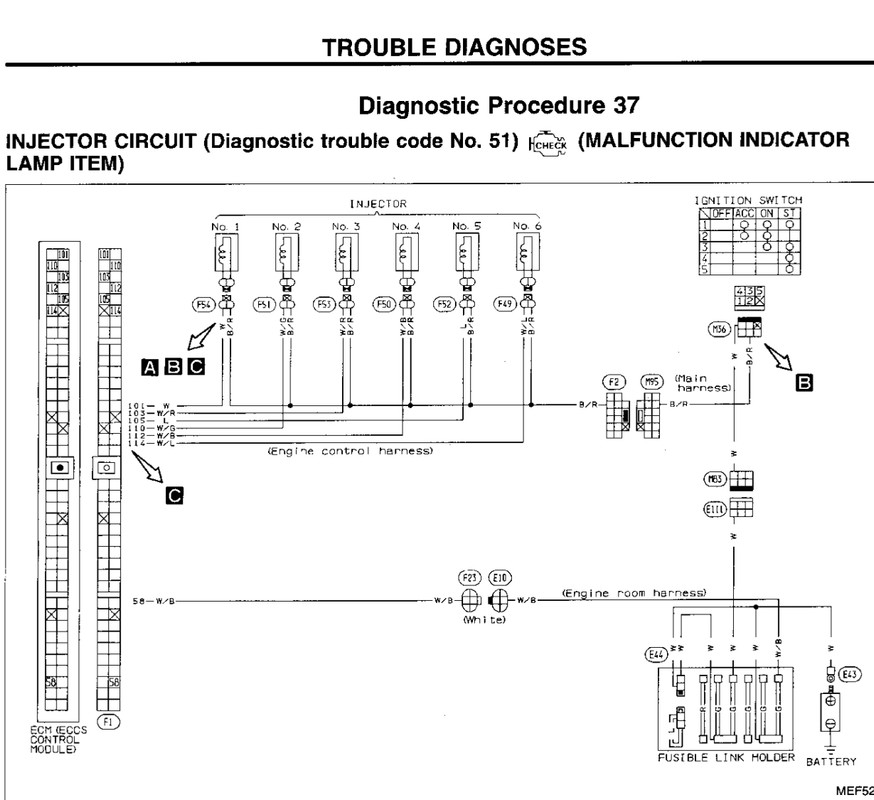

Message I pulled this from NicoClub's online 95 FSM.
It shows switched power coming from connector F2 and makes no reference to pin 45 whatsoever...
Anyways NICO is another common source that now contains conflicting information that would lead you in the wrong direction if you have a WS harness....
