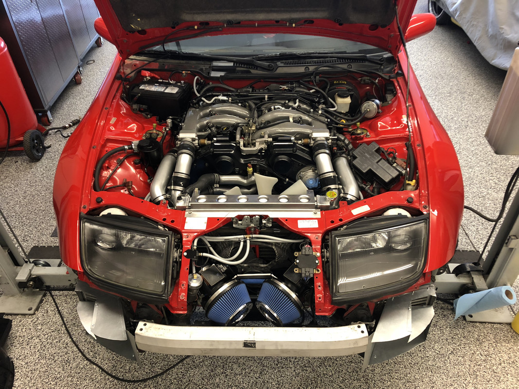

Message Yes you can keep the OEM bumper and splash shields. You might have to adjust the lower pipes a couple of time but they WILL fit.
Ash makes a set of fiberglass IC ducts for both ASpec and JSpec fascias.
No you cant really re-use the OEM ducts as they will block of 20-30 percent of the Massive.
And if you are a super keener dork (like me) you can always DIY your own ducting from aluminum or galvanized sheet.
