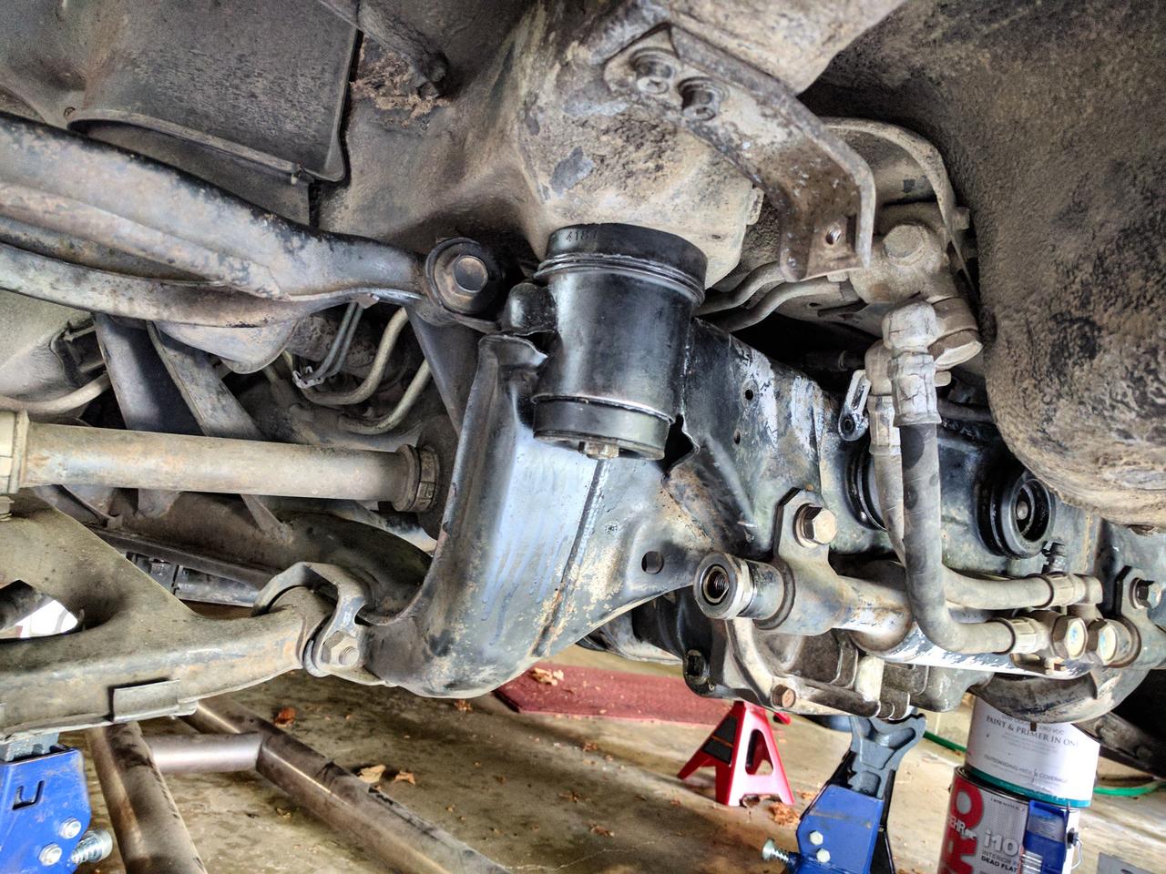

TwinTurbo.NET: Nissan 300ZX forum - Here's a pic of my ES bushings showing the extra lip

Nothing bad to say about my ES bushing installation
Polish
12:38:51 10/21/18
A couple people have had problems with them being too
Gordo NA2LS Daytona
17:47:57 10/21/18
Correct. Neither Whiteline are a proper fitment.
ConVerTT
09:47:21 10/22/18
Here's a pic of my ES bushings showing the extra lip -
nissubaru
21:13:37 10/21/18
Do the ES bushings make the ride harsher than OEM?
ZXoltan
09:27:06 10/22/18
Not harsher but definitely more firm.

Interesting, the left looks very similar to stock
Polish
16:44:16 10/22/18
Similar yes, but 10 mm too short in the body. (n/m)
ConVerTT
17:49:24 10/22/18
would adding subframe spacers work? (n/m)
