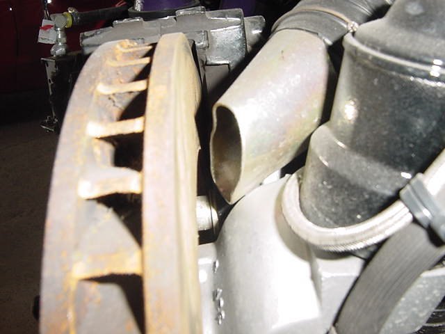

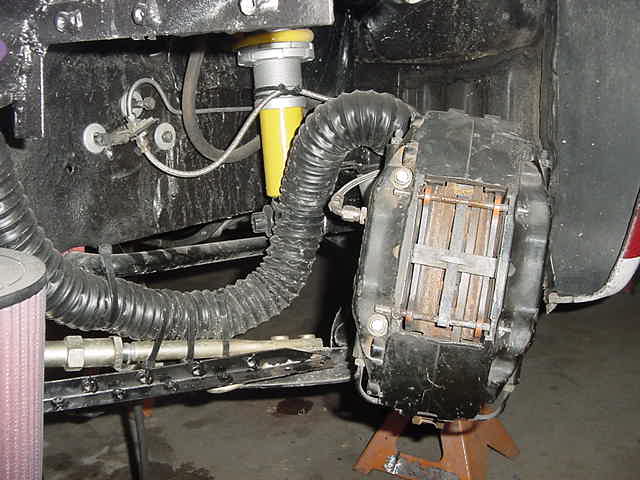

Message Here is my setup on my raceZ, someone made it years ago.
Seems to work well. Had the temp paint on when put in new rotors, got up to recommended temp but did not overheat. Brakes remain consistent for the normal 6-8 laps.
