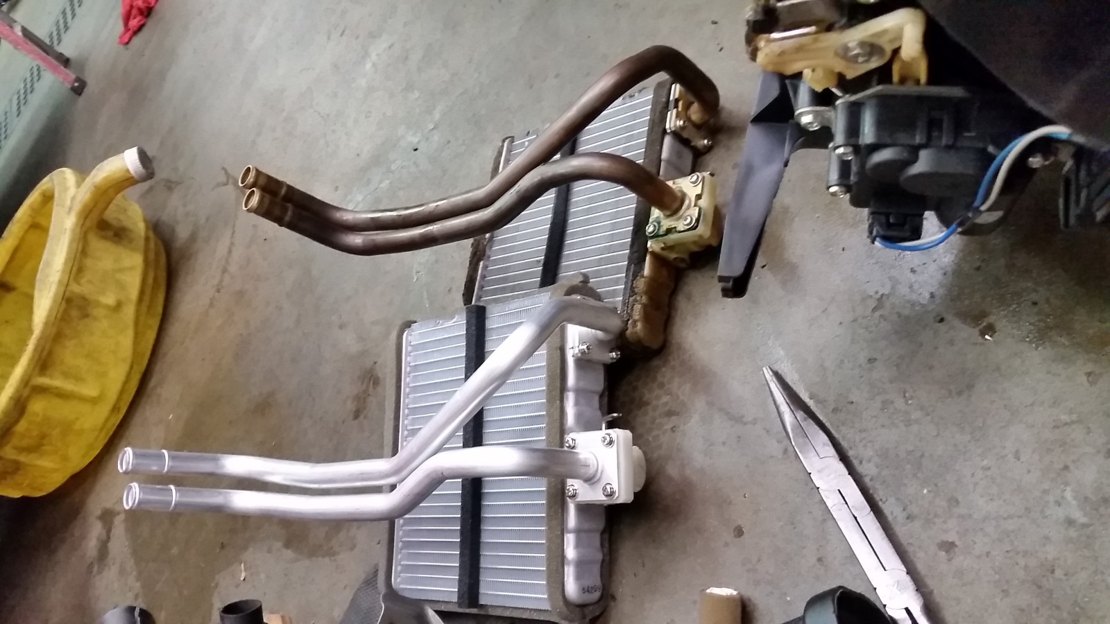

Message 1. clogged w. rust and sludge - no heat
2. leaking vanes in the core or tubes - leaking out of lower vents
3. leaking flow valve - leaking out of lower vents
Other problems could be the mode door motors being dead or stripped threads and inoperational defrost for example.
A new core comes as an assembly w. new tubes attached.
Here are a bunch of photos from an install last year:
[ http://www.yugobernie.com/images/Cars/Stuart_Dvorkin/Heater_Core/ ]
