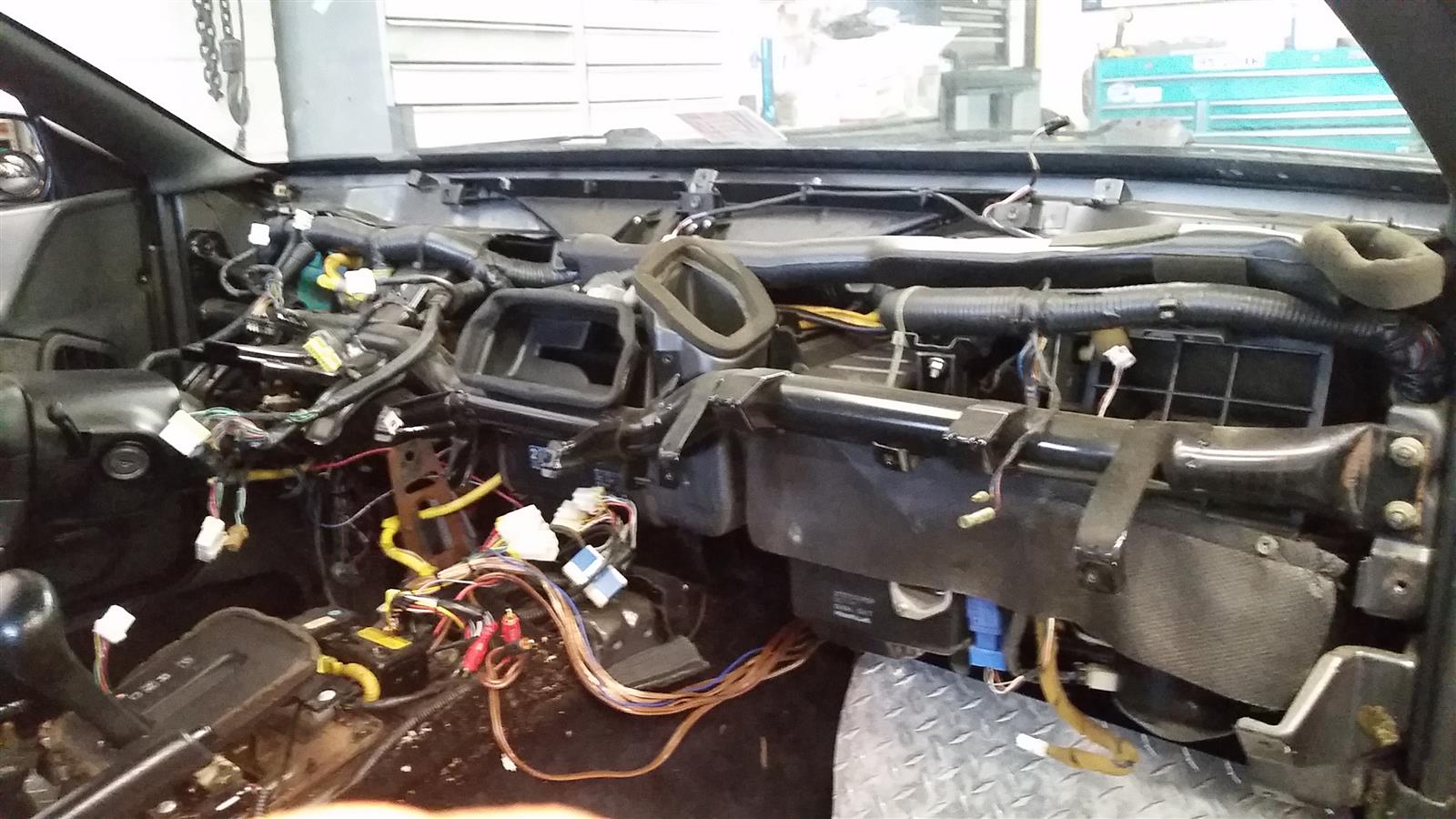

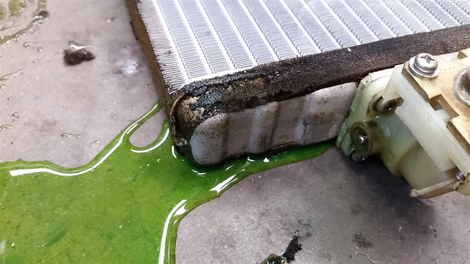

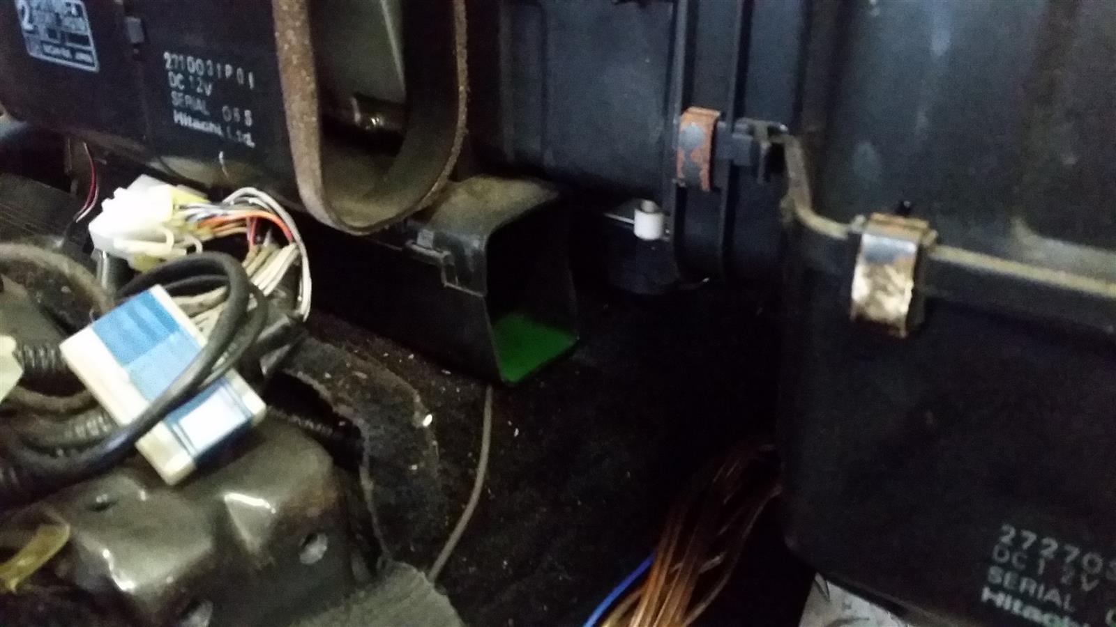

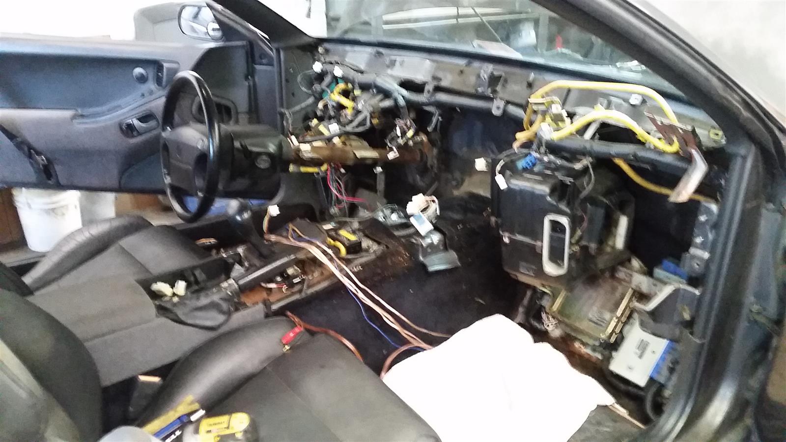

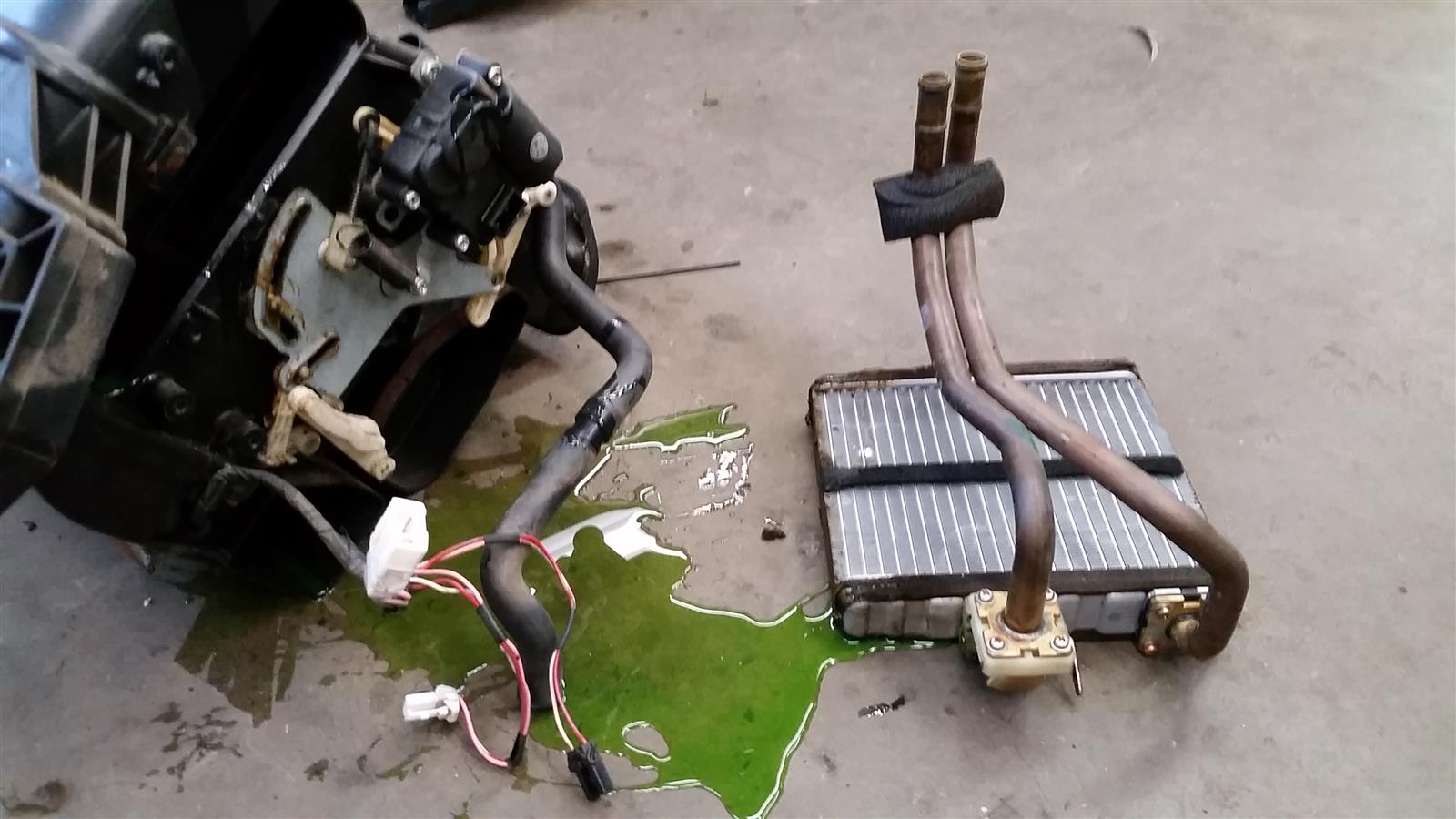

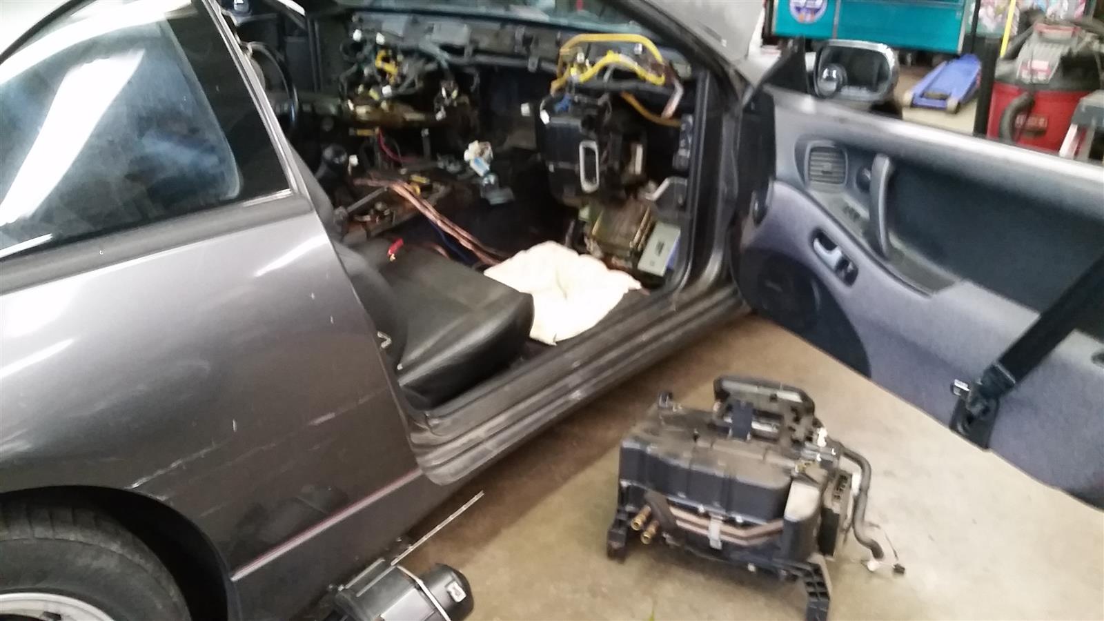

Message Once the dash is out you can unbolt the heater, AC and blower from the inner firewall and wiggle them to the left. The blower motor will come out 1st with a down and twist movement. If you need a motor I have some here. What's your symptom - single speed, noisy or doesn't work at all?
Here is a few pictures from the other day that might help give you an idea
