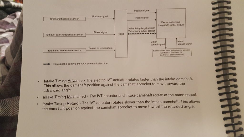

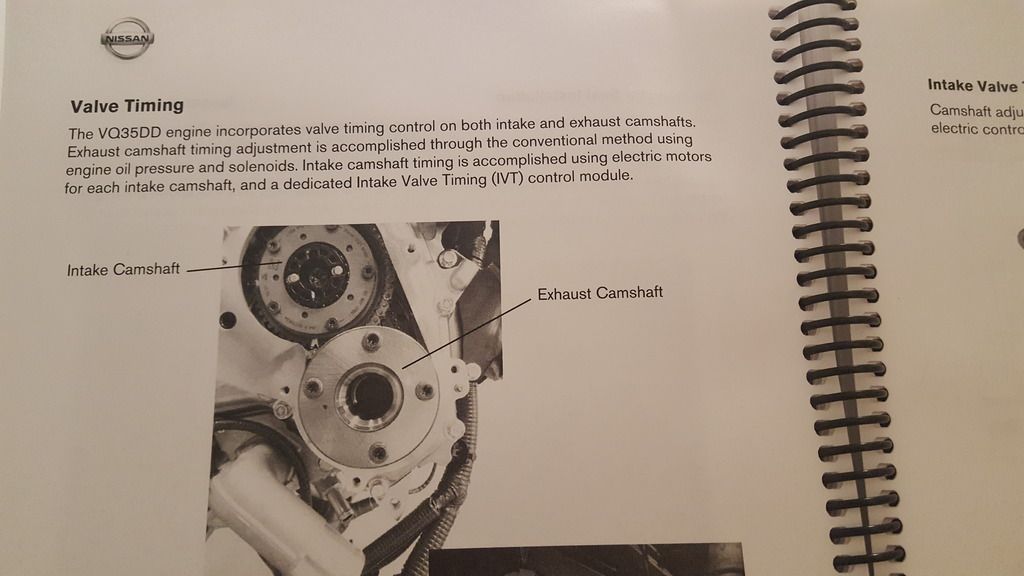

when you ask a motor to speed up faster than the cam I just see issues in the long run lol not sure if it's the same in the VR or not though, but I'd assume it's probably the same
