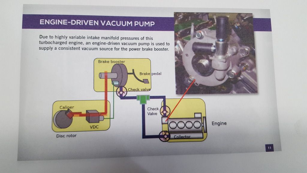

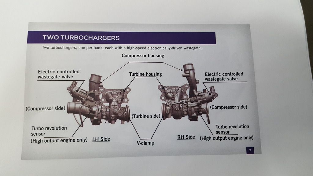

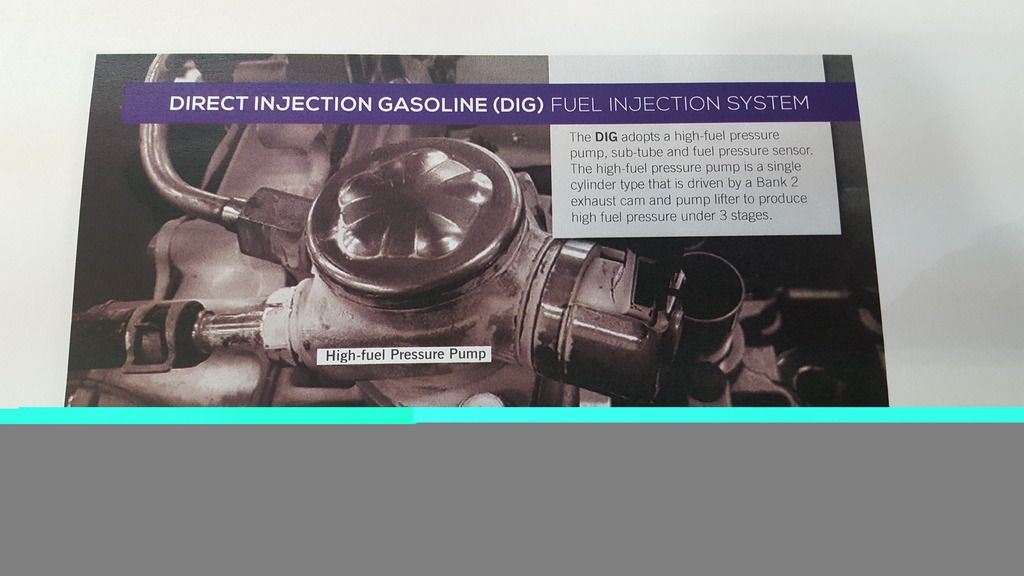

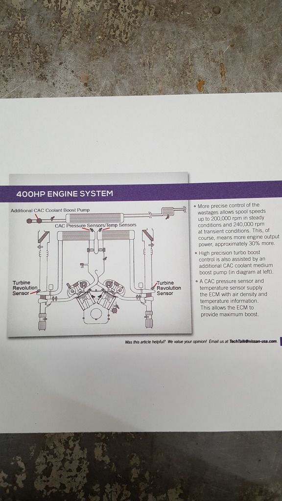

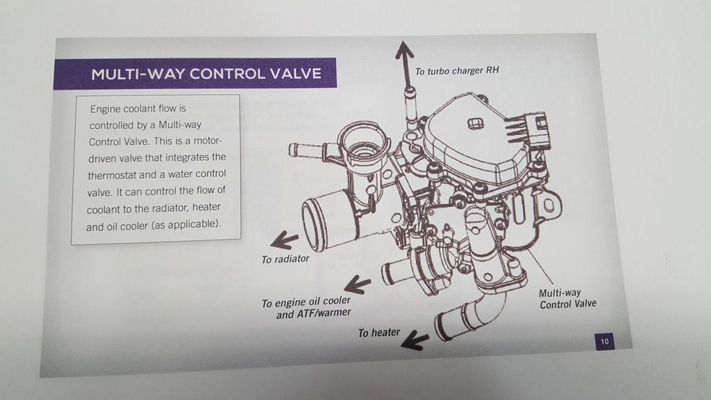

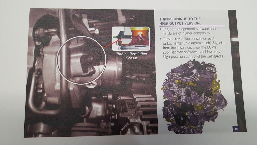

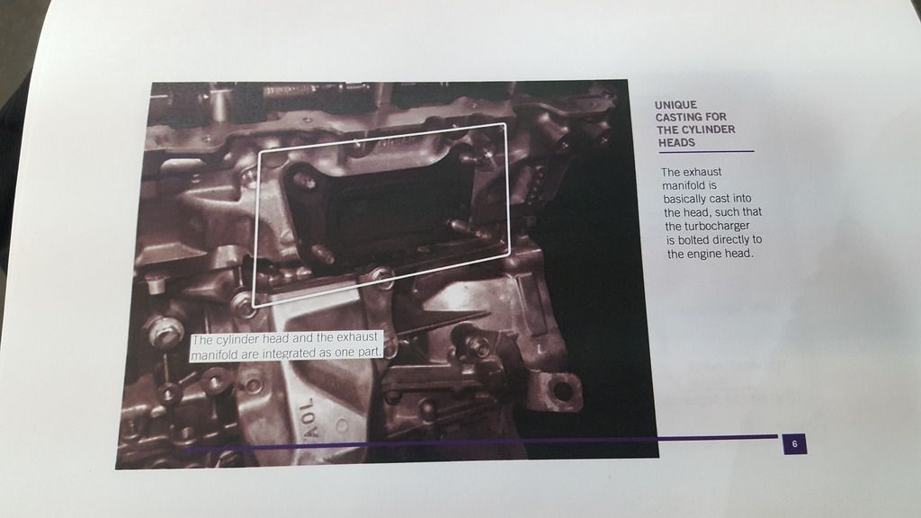

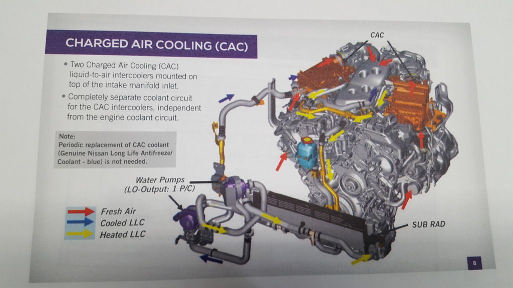

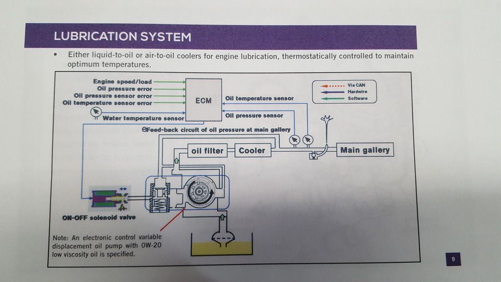

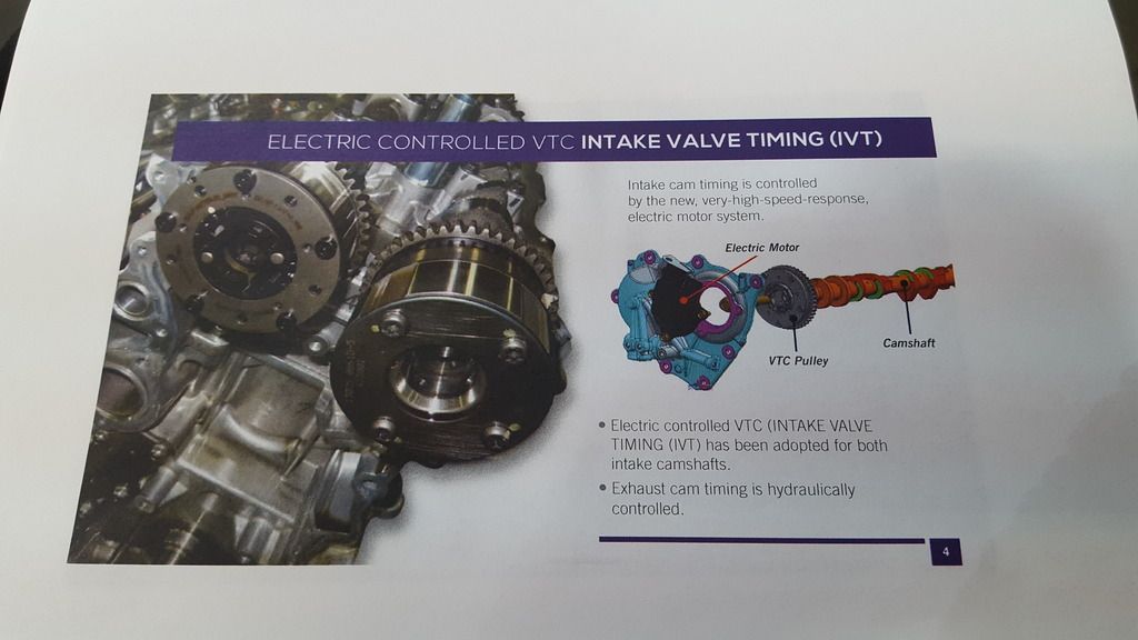

Message Had spare time at work the other day so I decided to see what TSB's have been released for this engine. This one gives some general information about all the different components.
