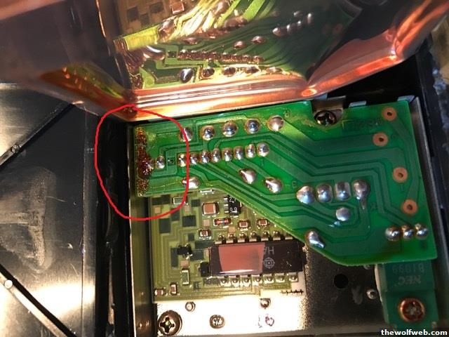

This maf is burnt up right?

Or is that brown solder flakiness normal?

Looks more like circuit board corrosion or some other kind

Corrosion? Might be salvageable. Need to be cleaned up

Looks like old flux (n/m)

Looks like the normal protective varnish
