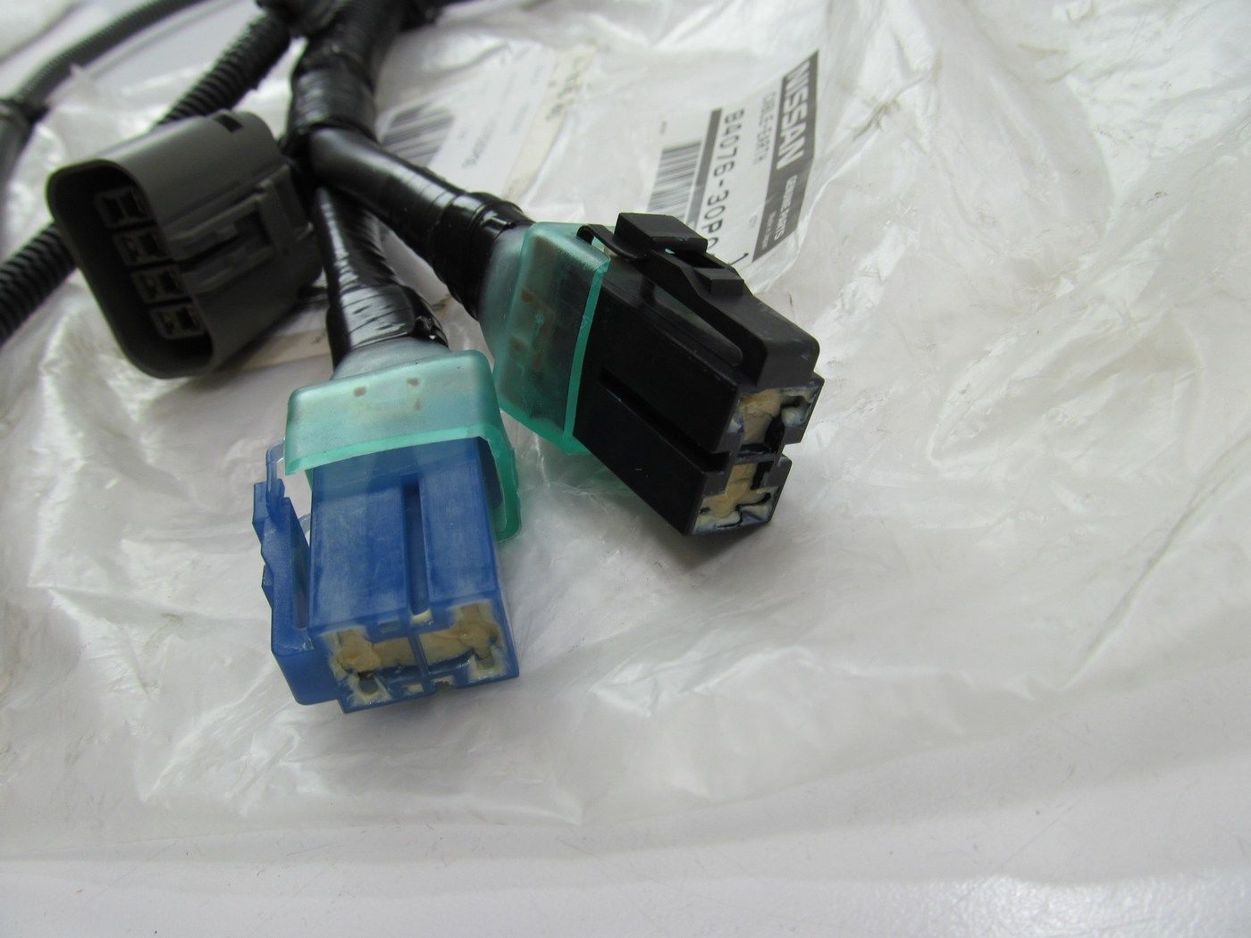

Message It comes packed w. grease for a reason, just like these 2 connectors on the trans harness. The connector isn't sealed from the back. If you remove the packing it will corrode and create problems for yourself.
