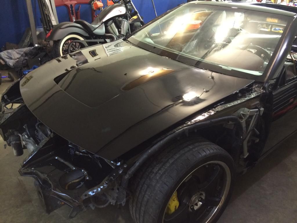

TwinTurbo.NET: Nissan 300ZX forum - My modified stock hood
Alan(MD/NJ)
on April 22, 2016 at 11:53 AM
963
Could be
posted by BlackholeZ
on April 22, 2016 at 10:51 AM
To assist with cooling
Uploaded with
ImageShack.us
Dual front mount intercoolers
Alan(MD/NJ)
19:04:45 04/20/16
Nice! I thought about this before, after seeing it on a GTR

Nice. Do you have any pictures of the piping ?
lymon
00:07:16 04/21/16
Not yet. Waiting on my custom plenum (n/m)

My concern is with getting sufficient airflow

I would be extremely surprised if
ZXRider
19:36:31 04/21/16
wondering if adding additional SMICs (4 in total) would work (n/m)
Jiro
19:45:43 04/21/16
Piping will almost be the same as
Alan(MD/NJ)
19:47:32 04/21/16
If it works, that's fantastic
ZXRider
20:09:28 04/21/16

If front mounts where so bad
Alan(MD/NJ)

Because Nissan didnt stack radiator, ac, and oill cooler
Red Hawk (CO)
01:26:28 04/22/16
nissan engineers didn't arbitrarily pick SMIC over FMIC
12:05:09 04/22/16
There is a practical reason for this though
