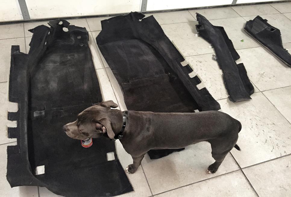

Interior stripped

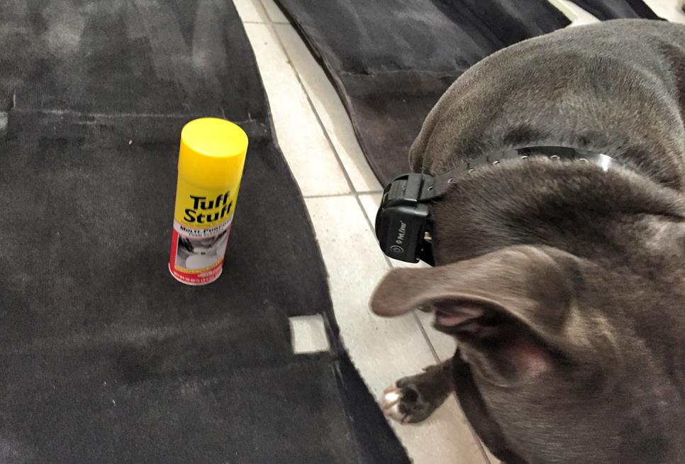

Cleaned it with Tuff Scuff first with help from my assistant

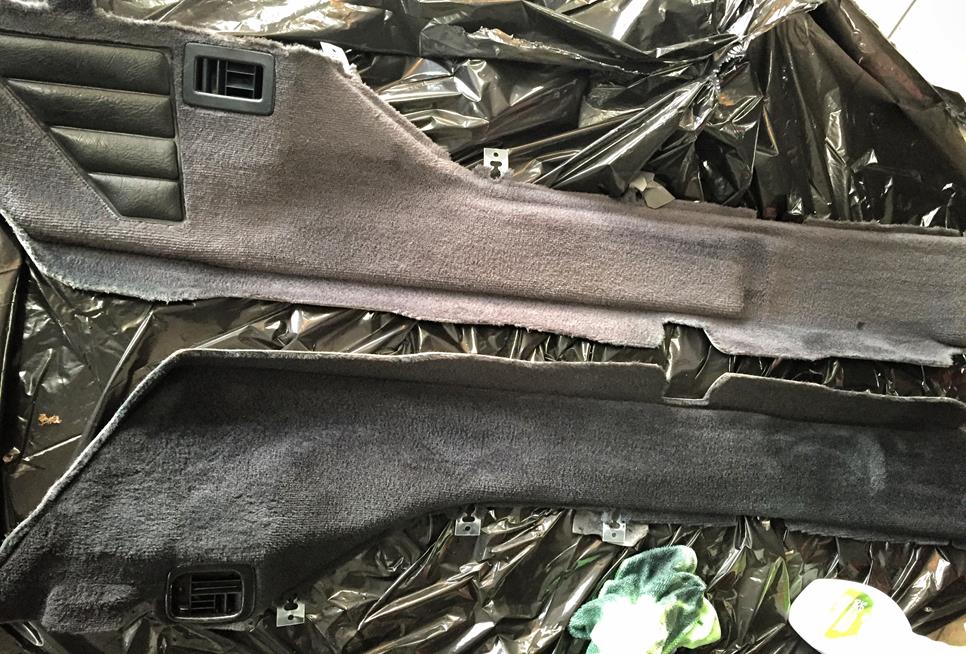

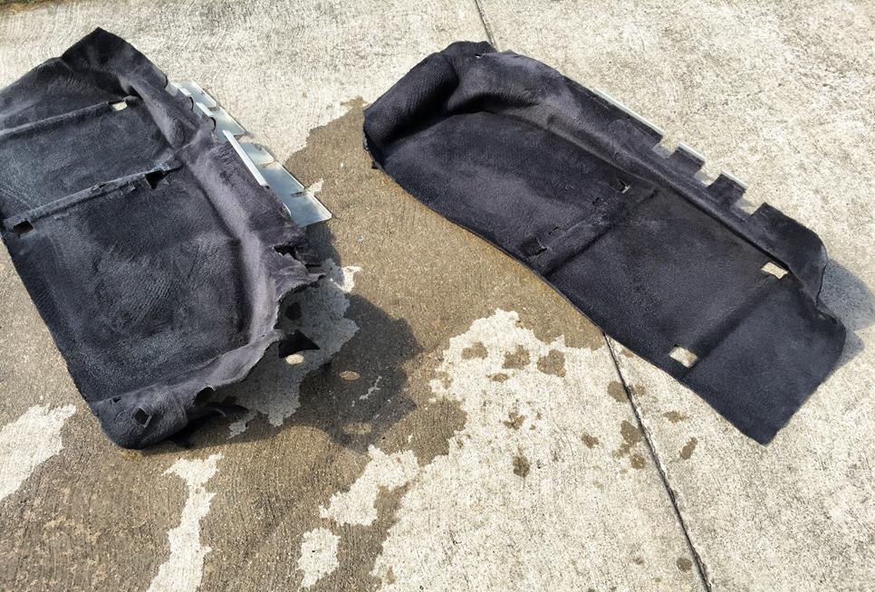

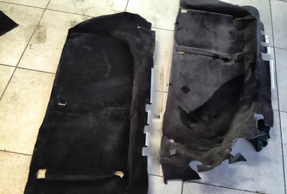

Before / After
Left is done....right had some over spray on it the top of it is before...
The pics don't really even do it justice. It looks brand new and feels great. I am anxious to see how well it holds up. But for now I couldn't be happier with my $4 upgrade :)
