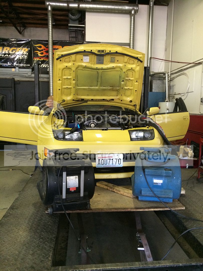

Got the car loaded up on the dyno and let Greg and Seb work their magic. I had a single tune done on 92 octane along with cam gear tuning on both the intake and exhaust cam gears.

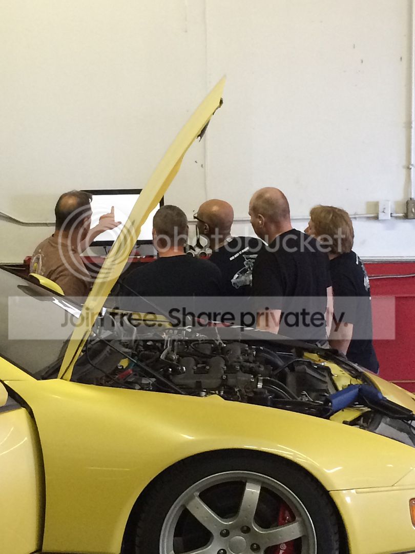

Greg pointing out and explaining the hp/tq changes after making adjustments to the cam gears. He's got this down to a science. He only had to make a few adjustments to dial in the gears.

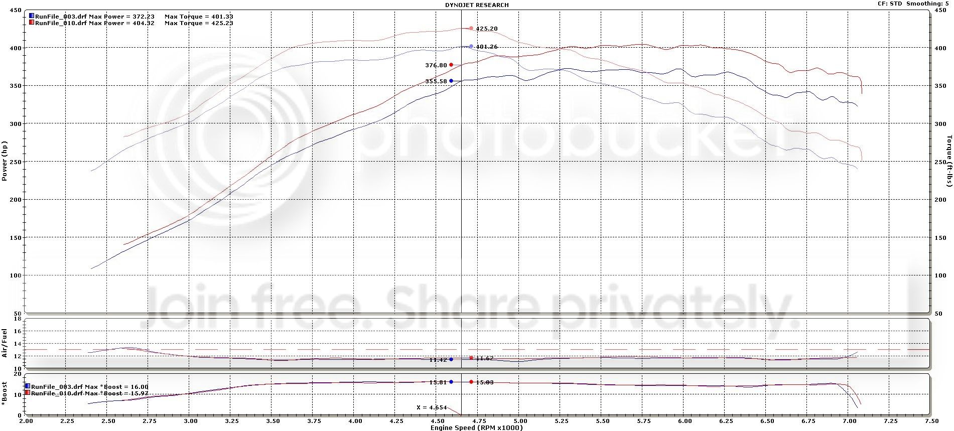

Here are the results after 10 pulls on the dyno. All runs were done on WA 92 octane fuel. I removed a few of the runs that were baseline and boost controller adjustments.

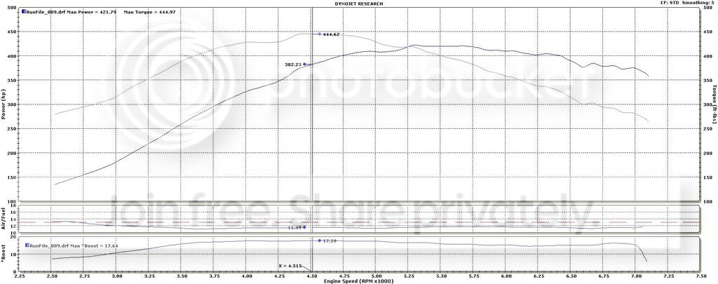

This was the 9th pull but sadly there was some detonation so Greg/Seb pulled back the timing and turned down the boost a bit.
