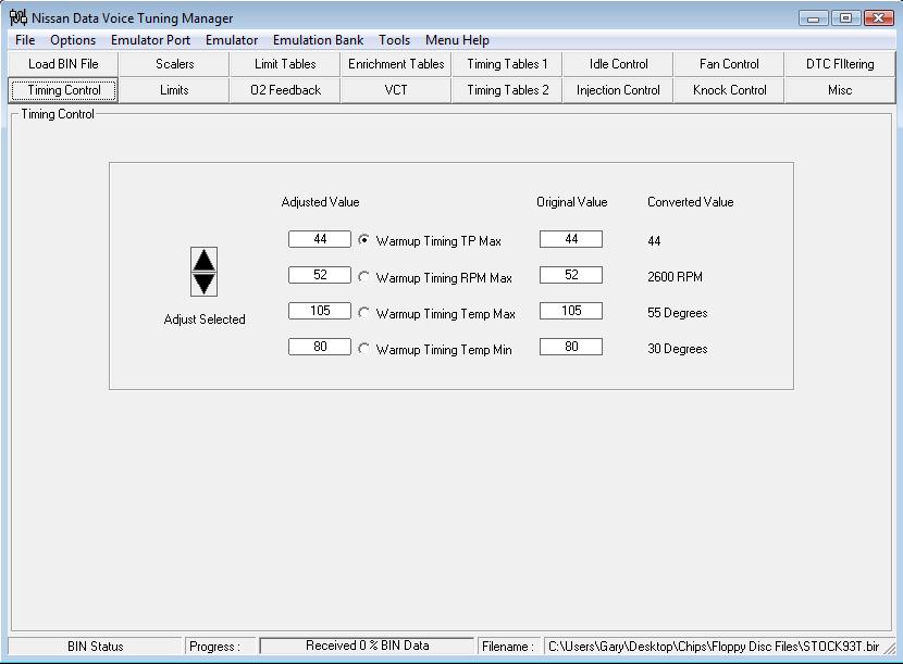

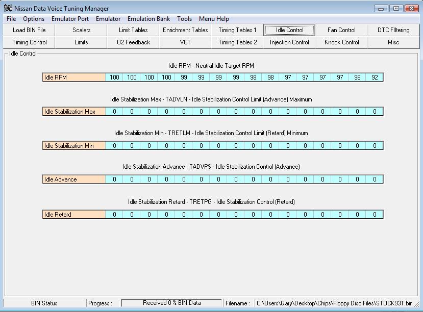

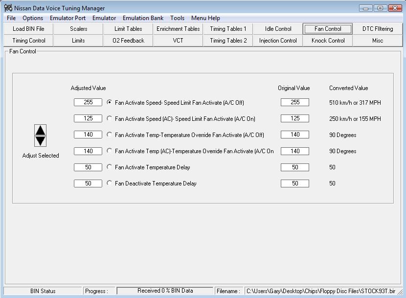

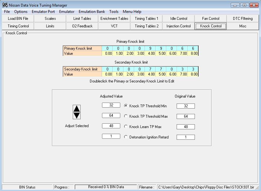

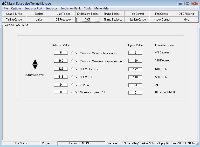

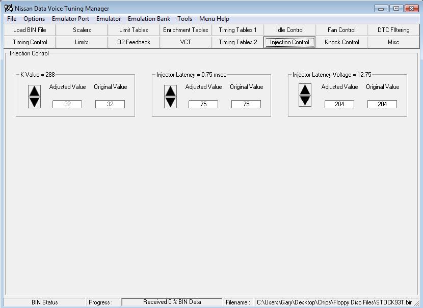

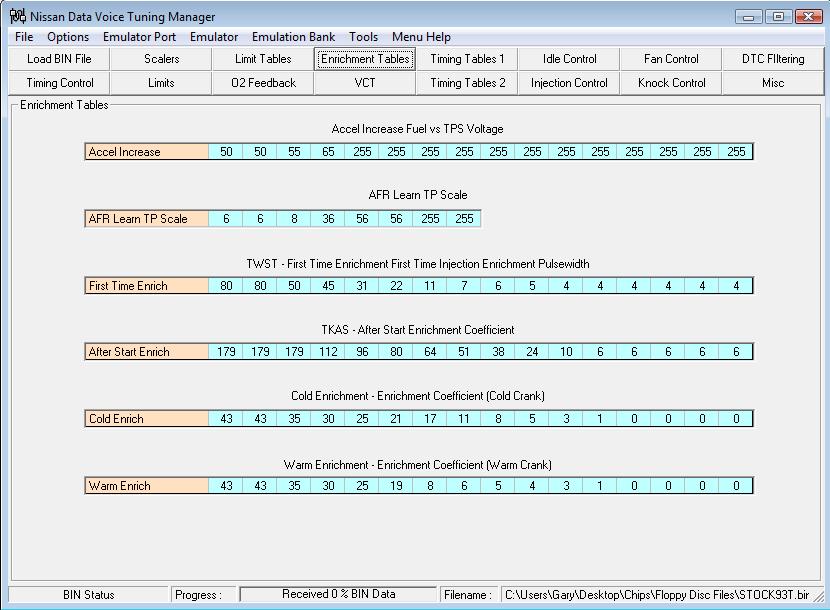

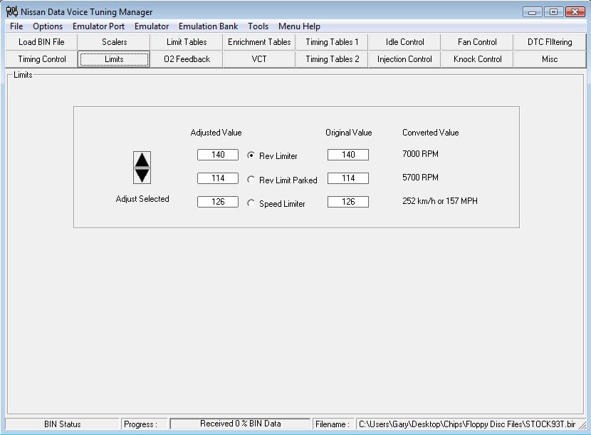

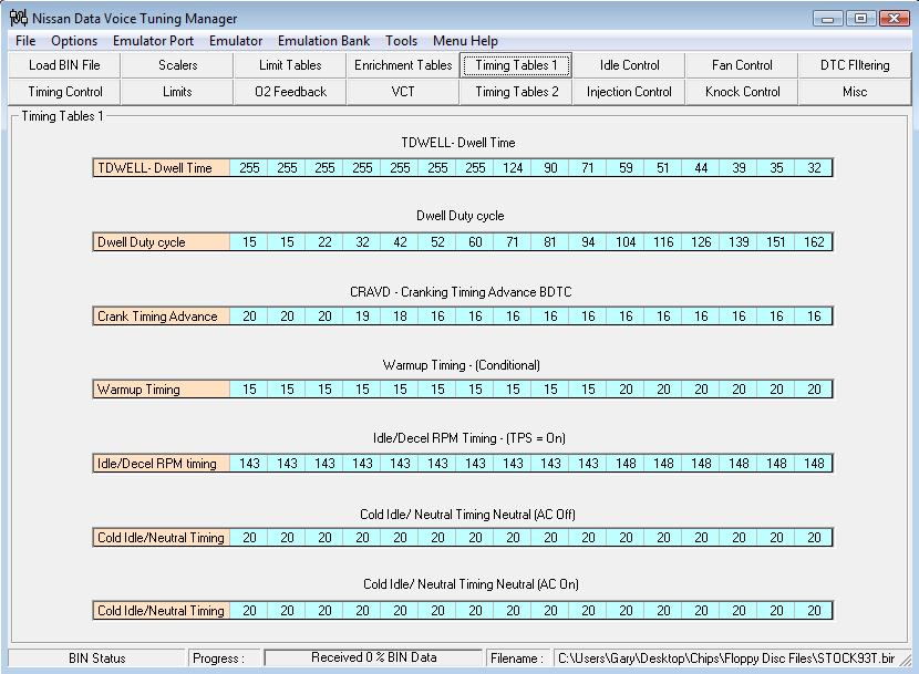

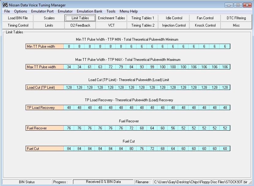

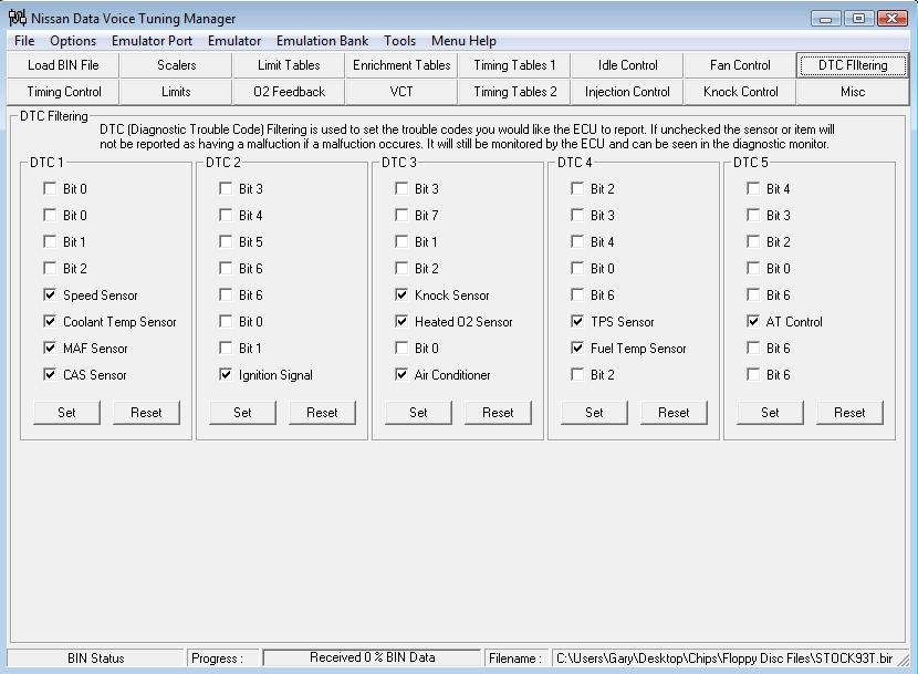

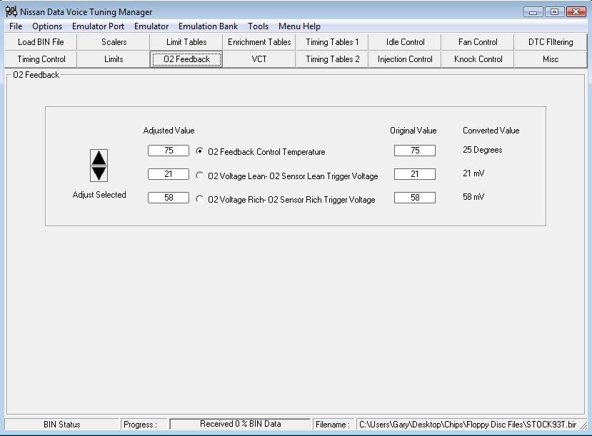

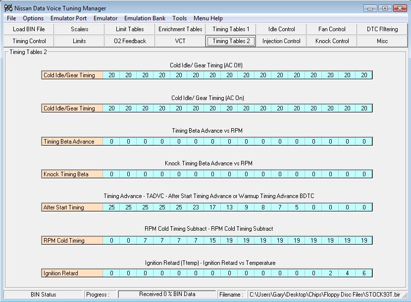

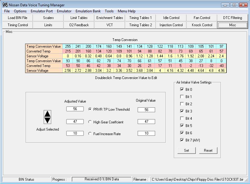

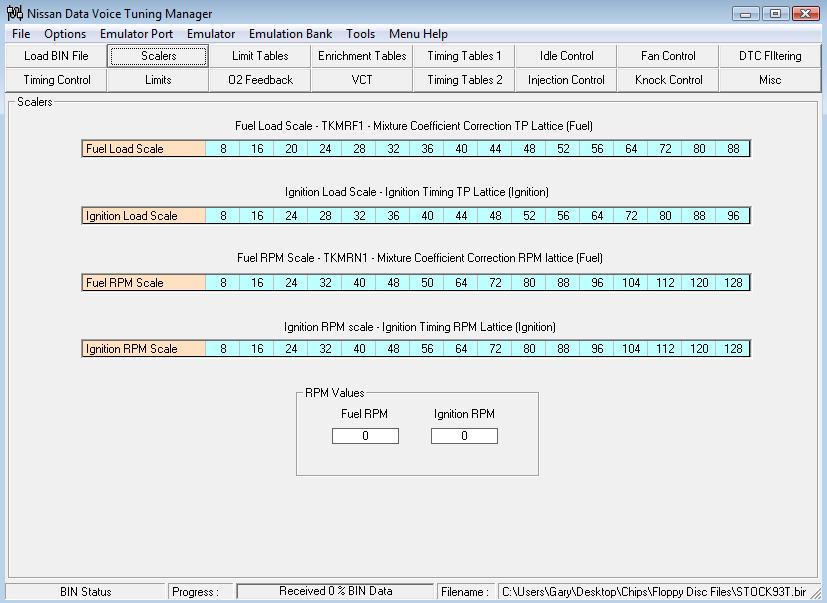

Here are some more screen shots of what the tuning manager part of my software can tune on the fly in real time.
