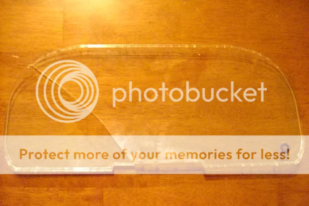

Message This is the "glued in" lens that I managed to crack while trying to remove it from the cluster.
I went through all this hassle because I was trying to install the Z1 chrome gauge rings. The small ones needed some sanding to get them to fit in the rings. I think that there is an ever so slight difference in the diameter of the holes in these glued in clusters than in the other clusters with the snap-in lens which caused the problem.

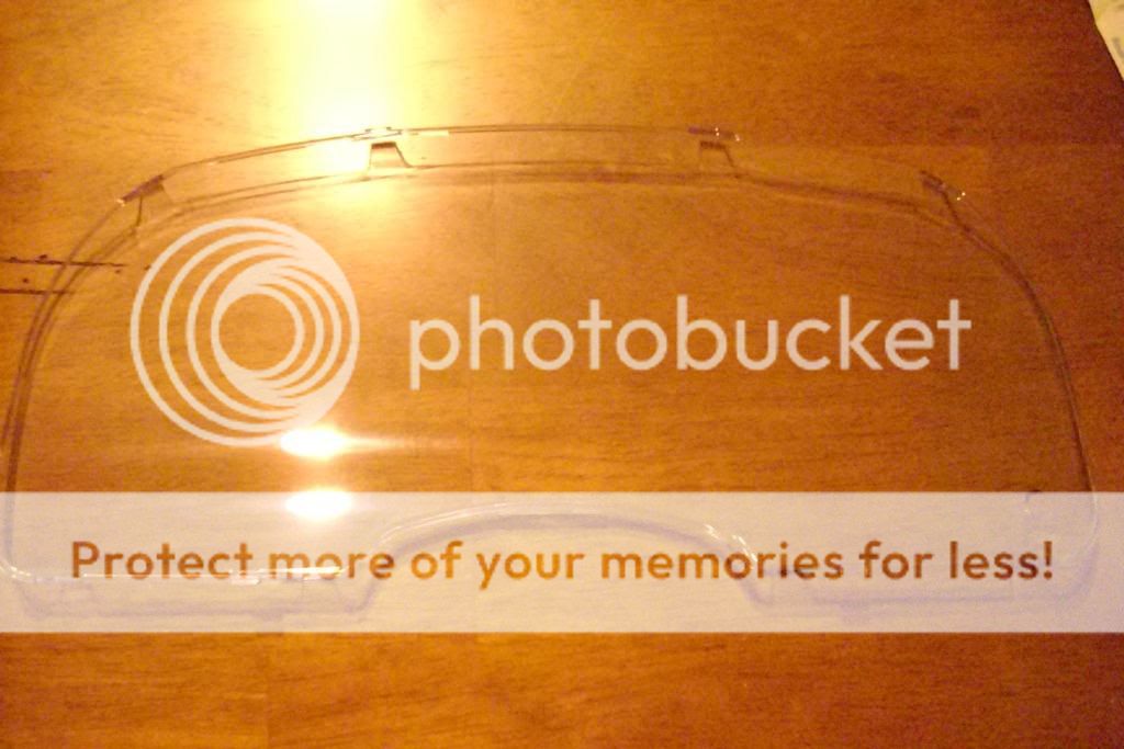

This is the lens I ordered from Coz. It was supposed to be for a '90 model year, but not for mine apparently. Note the snap-in tabs around the edges. My life can't be that easy though.

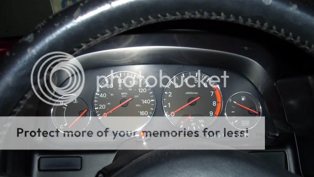

It was a big PITA but I got it back together again thanks to a scrapped cluster with a clean lens I was able to cut out and glue back into place on my cluster.
