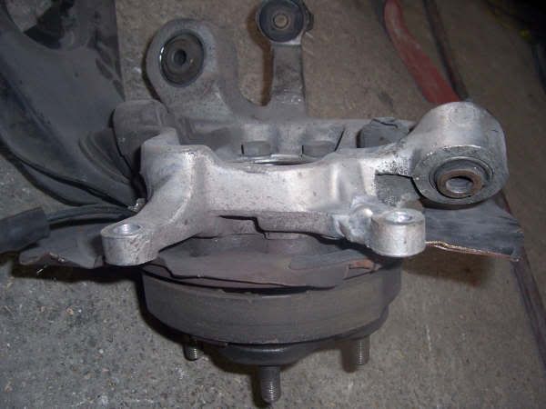

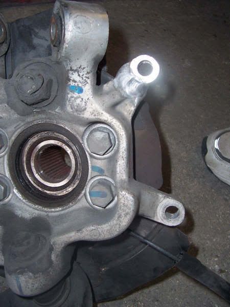

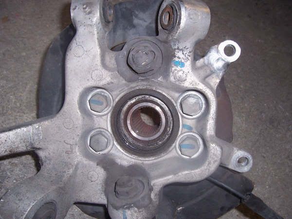

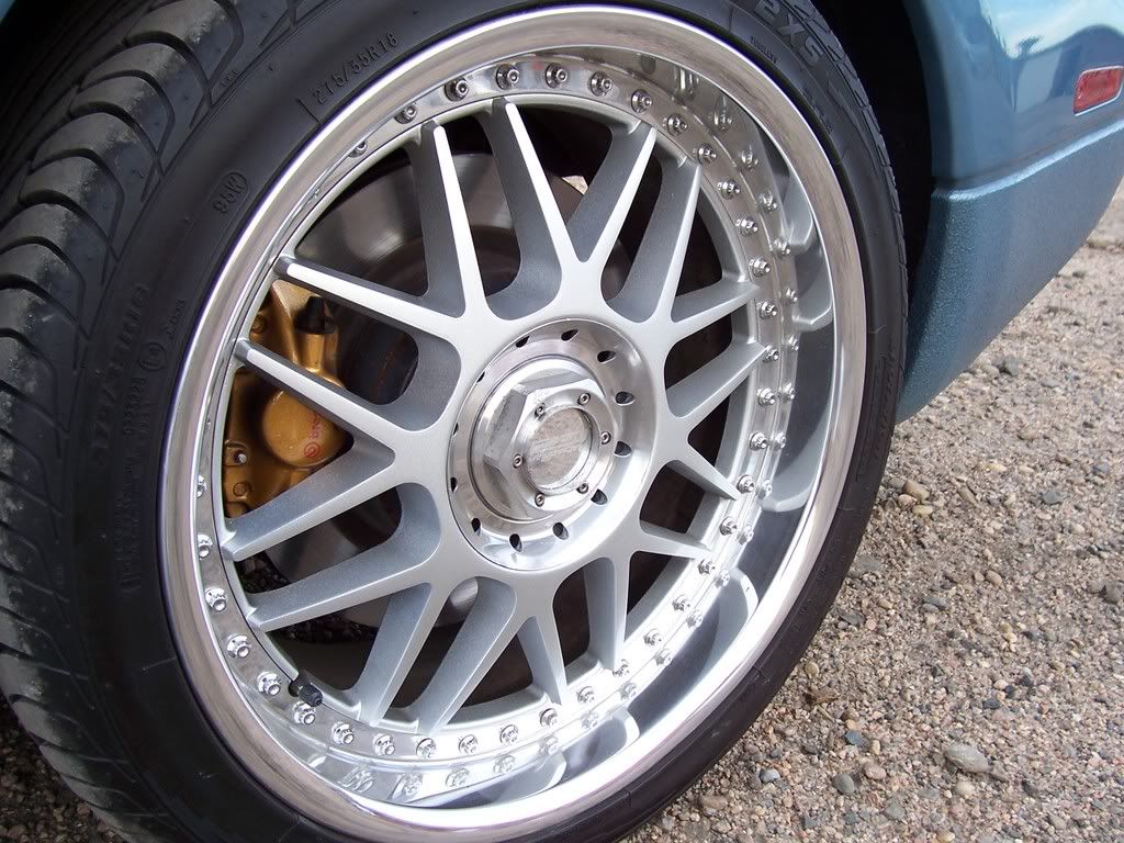

Message bolt on. You have to move over one of the mounting tabs like this.
