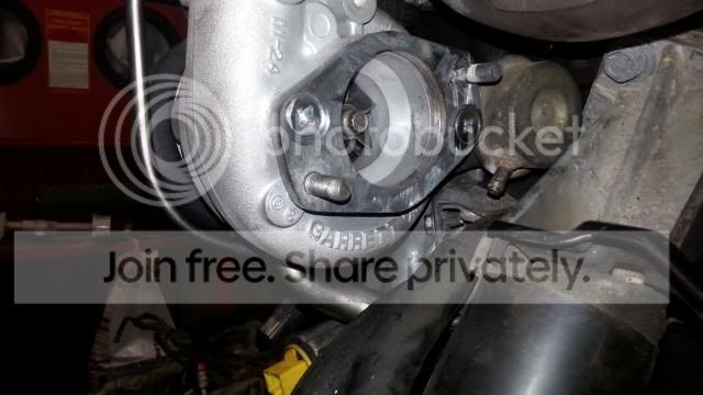

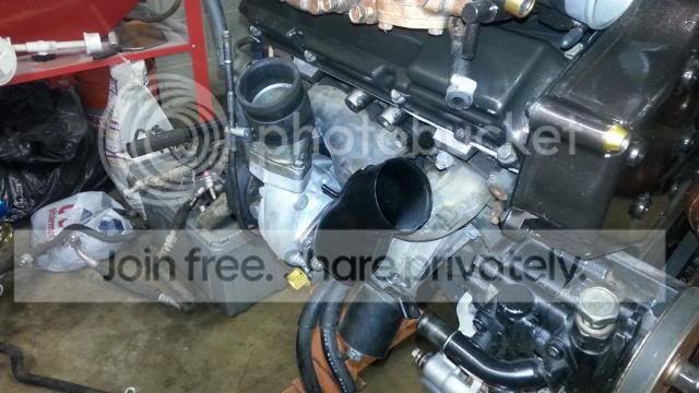

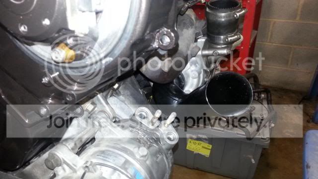

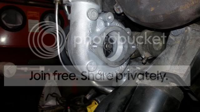

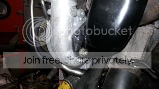

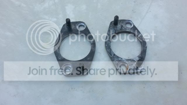

Message Sooooo i got a set of SR20 turbos which are an upgrade when used on the VG motor. I did however run into a problem that i did not anticipate. The inlet flanges are machined at a different angle so on one side, the intake pipe sticks out too far and on the other side it will not bolt on at all coz it does not clear the motor mount. So i had to make these little brackets to clock the pipes to the correct angle.
