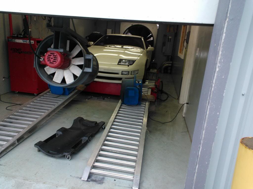

Message That dyno has very poor cooling capabilities, you're probably getting heat-soaked and the ECU may be pulling timing due to knock. All of the runs I've seen done at that shop were quite low.
