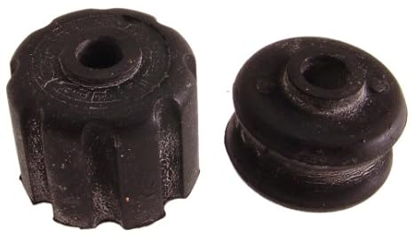

Message Just doing a sanity check on the rubber parts that should be changed when changing out the shocks. Is there anything I am missing or wouldn't really need to replace? I want to get this right the first time :) I know Z1 has a "kit" for $250, of which most of the cost seems to be from new mounting brackets which I would think can be reused unless I'm missing something as to why they would need to be replaced.
Starting from the bottom up:
Fronts
54050 that goes inside the dust boot
54055-Z32001 dust boot
54320-Z32001 Right side strut insulator
54321-Z32001 Left side strut insulator
54329-Z32001 Insulator/gasket
Rear
55240-Z32001 Dust boot
55248-Z32003 bumper(Courtesy says not available in USA anymore)
55034-Z32001 spring rubber
55338-Z32001 gasket/insulator
56217-Z32001 bushing
