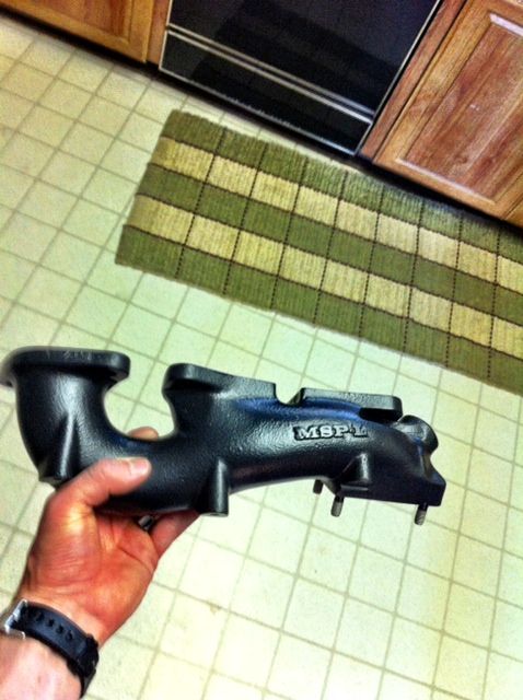

I made arrangements with SpecialtyZ to do a full build on the motor. While I was hanging out on the waitlist I had my 3" downpipes (which I just recently found out are probably AMS :( DPs ) and MS Manis ceramic coated at a local shop in Washington.

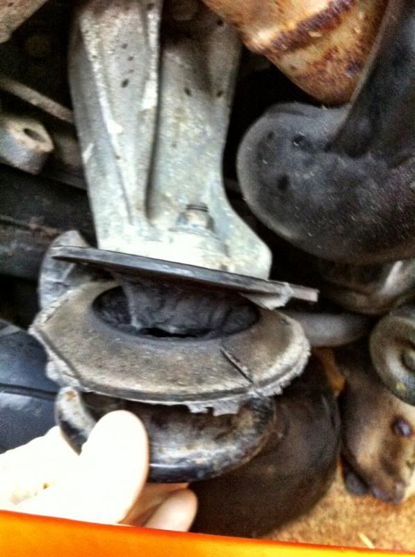

Also found a good excuse to buy BDE motor mounts :D

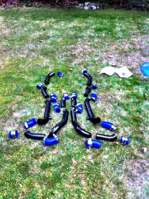

Also went ahead and bought 2.5" intake piping and a triple plate Exedy clutch kit.
