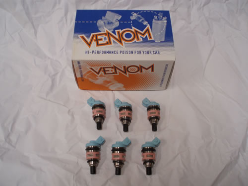

Now as for your injectors (pictures would help on your part) but from what I can see you are simply WRONG.
Stock 370cc injectors are purple with age they typically fade to a grey color or even brown color.
Stock 270cc injectors are red, they don't usually discolor much, at most they get a little darker.
Venom sells 370cc injectors which are light blue colored, these are often sold on eBay and other on line stores.
I'm willing to bet that is what you have.
To me it sounds like someone replaced dead injectors with the aftermarket blue ones, which is why they pop out so easy. The original injectors are the brown ones and they all likely flow 370cc.
All the rest of your post is just made up drama.
Stock 370cc new (right) old (left)
Stock 370ccc used
Stock 270cc
Venom 370cc
If you want to know for sure have them flow tested.
