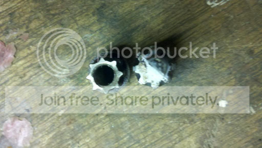

ForceFedTT (SoCal)
00:45:19 01/01/14
Do you have the new one installed? (n/m)
Alan (TN)
01:45:25 01/01/14
Yes, all installed

You need to check the spline on your CAS. Worn spline
Alan (TN)
14:14:16 01/01/14
I checked it yes, it only has about 2,000 miles on it

What material is this made from?
bartz32tt
10:08:52 01/01/14
The replacment is Chrome Moly

Sorry but I don't recognize this part
SammybTT(TN)
10:22:17 01/01/14
Here is a link that discusses this issue and the cure
Brad(RI)
10:42:18 01/01/14
I guess the photo threw me off
SammybTT(TN)
11:37:43 01/01/14
it doesn't have to get worn down exclusively for the reasons
12:40:21 01/01/14
The misalignment issues is theoretically limited to early
Brad(RI)
13:35:15 01/01/14
The grease is in there more to seal out moisture

VERTTZ
11:16:17 01/01/14
according to JWT early 90 models if it results from the
12:59:46 01/01/14
Ah. Well I just read that all of the JWT camshafts come with
VERTTZ
16:53:32 01/01/14
If your cam mount is misaligned you're likely to
ZXoltan
18:17:21 01/01/14
I would think you could still have this happen, but that
20:24:25 01/01/14
I had to replace the spline in a set of JWT cams. I believe
Alan (TN)
22:22:19 01/01/14
They don't unless its a newer change they made.
Woody75 (Denver)
10:30:54 01/02/14
Per JWT current web page, All billet cams come with the
Brad(RI)
18:21:03 01/02/14
