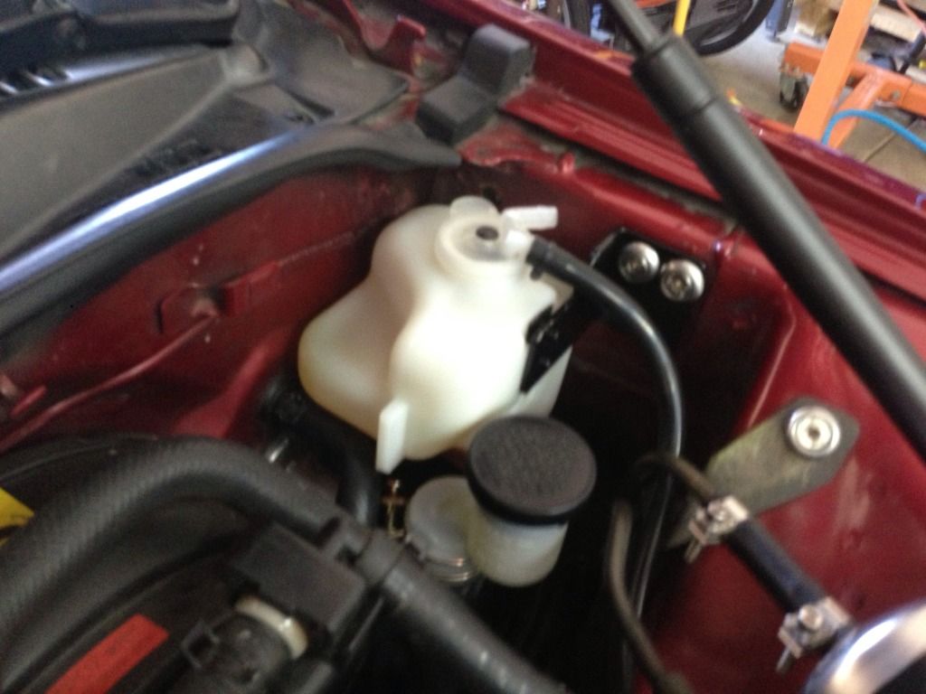

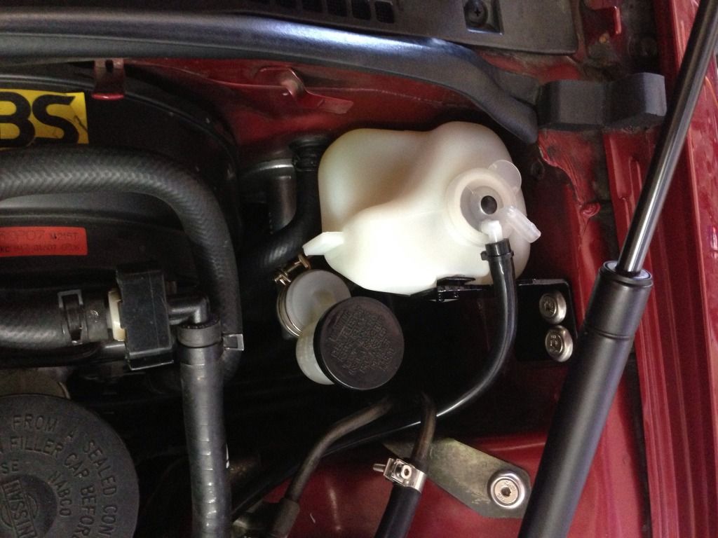

I believe it. I put a overflow reservoir in my engine bay so -
Evan_Wright (Ca)
09:18:10 11/10/13
Details? What tank is that?
09:51:05 11/10/13
It's from a mid 90's toyota tercel.
Evan_Wright (Ca)
11:06:15 11/10/13
Excellent idea, thanks for the info! (n/m)

Seems a bit high. How does the return to the radiator work ? (n/m)
ztunerz
10:37:26 11/11/13
The cap has a hose that goes down to the bottom of the
Evan_Wright (Ca)
12:35:13 11/11/13
Great, that works (n/m)
