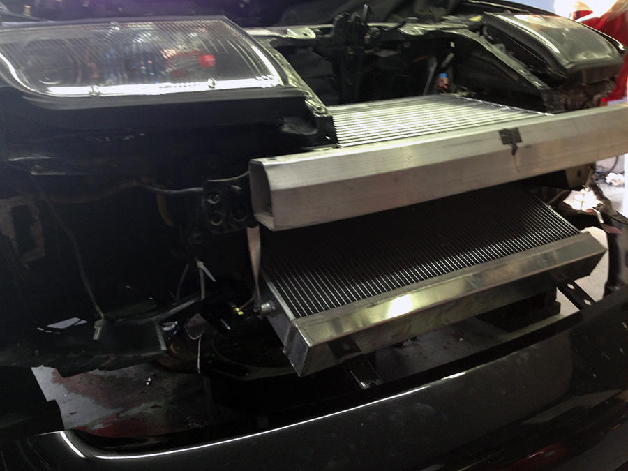

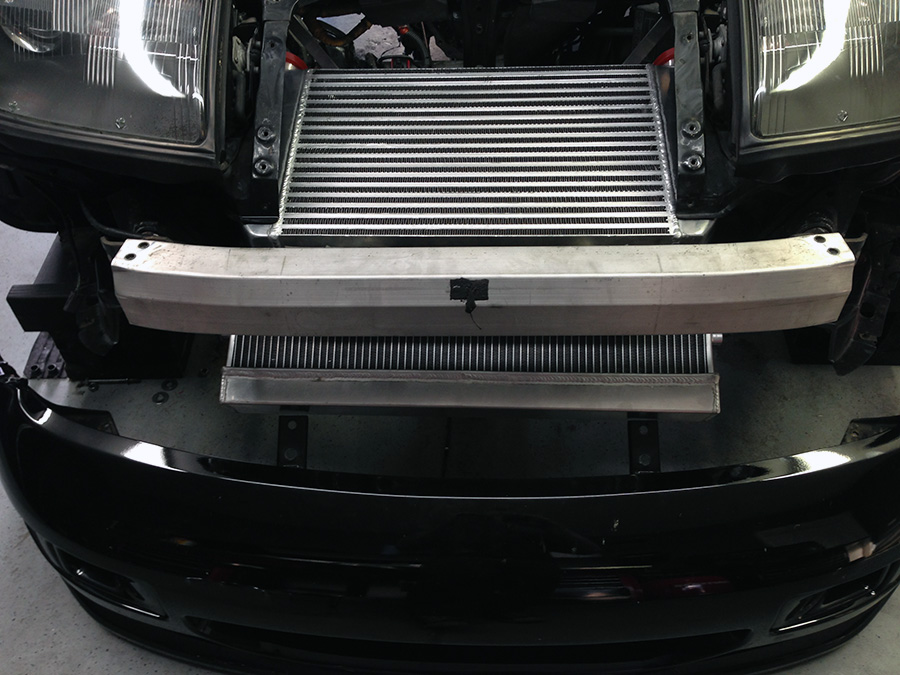

Custom intercooler / radiator setup

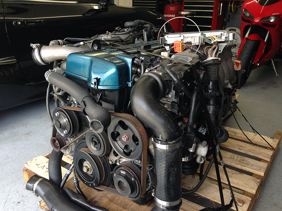

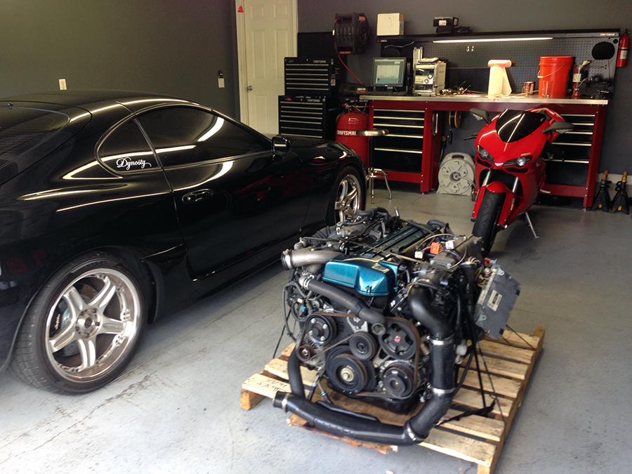

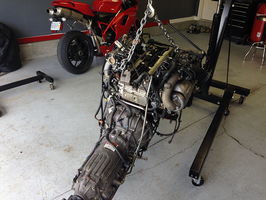

arrival of 2J

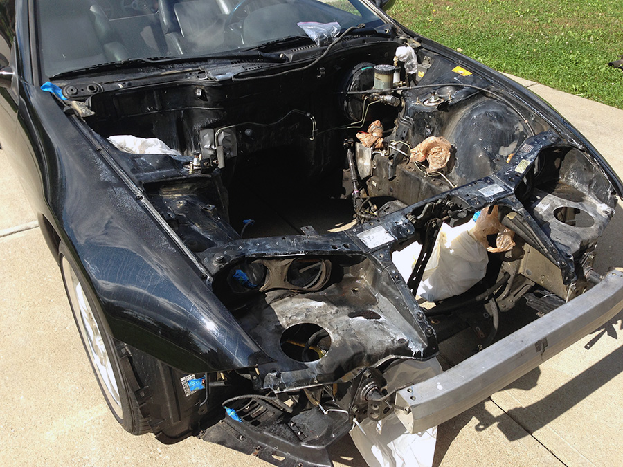

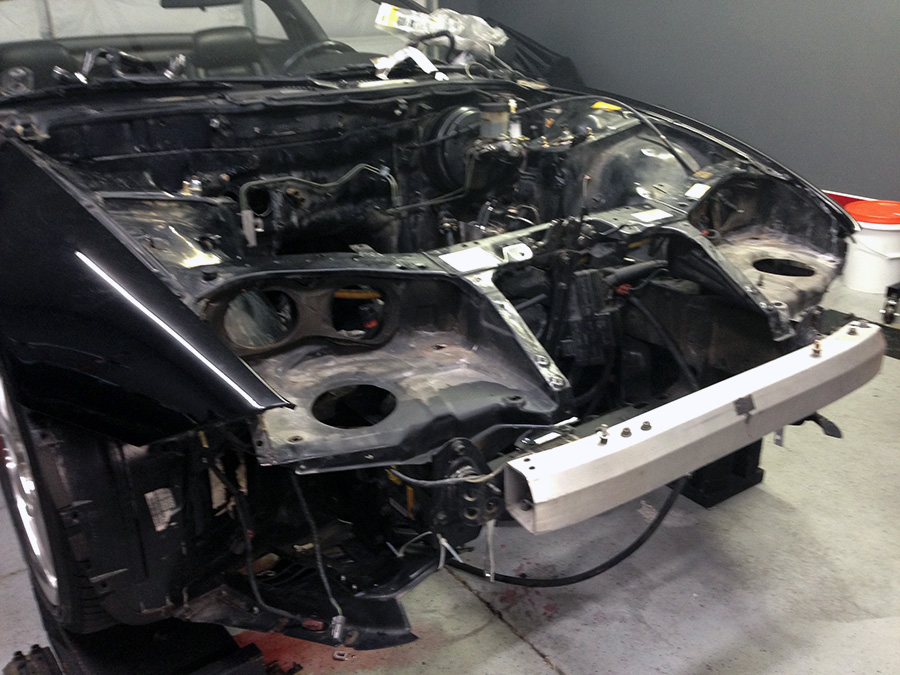

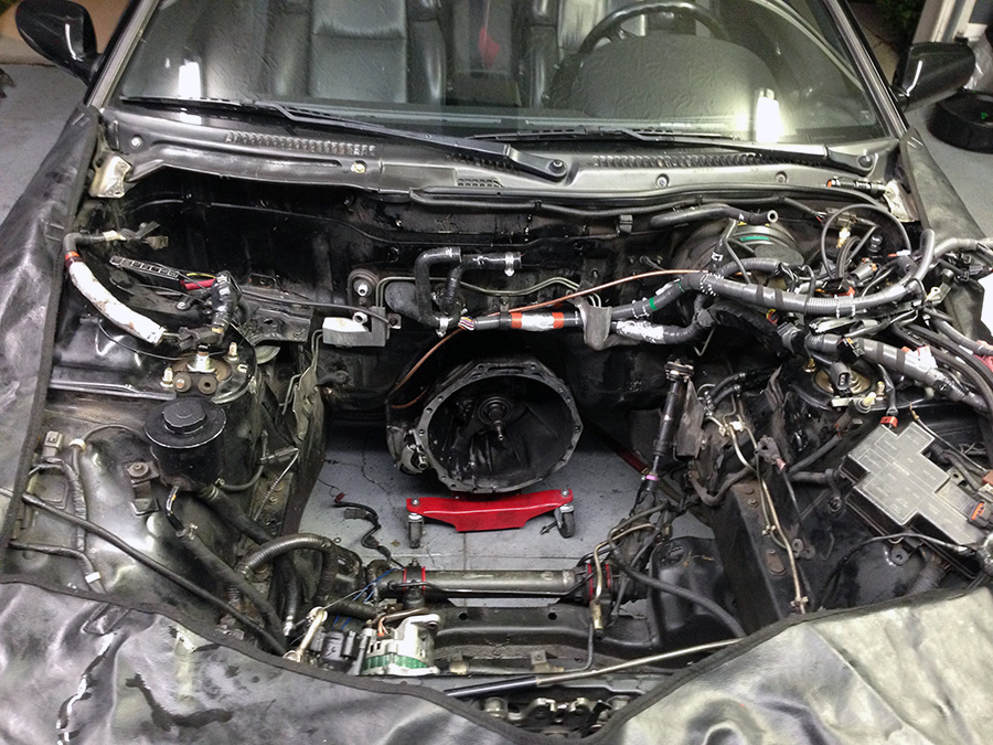

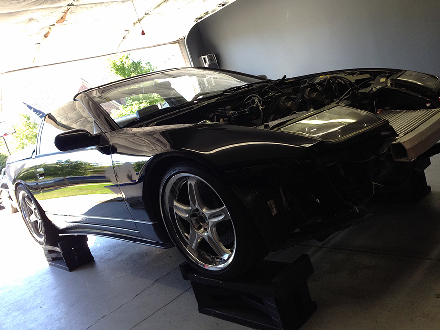

Starting to prep the Z

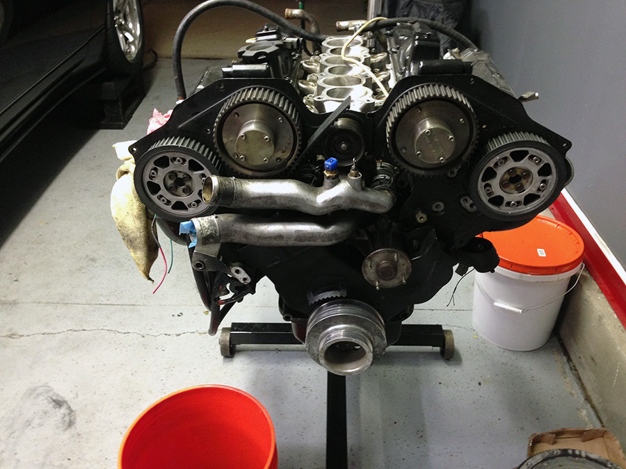

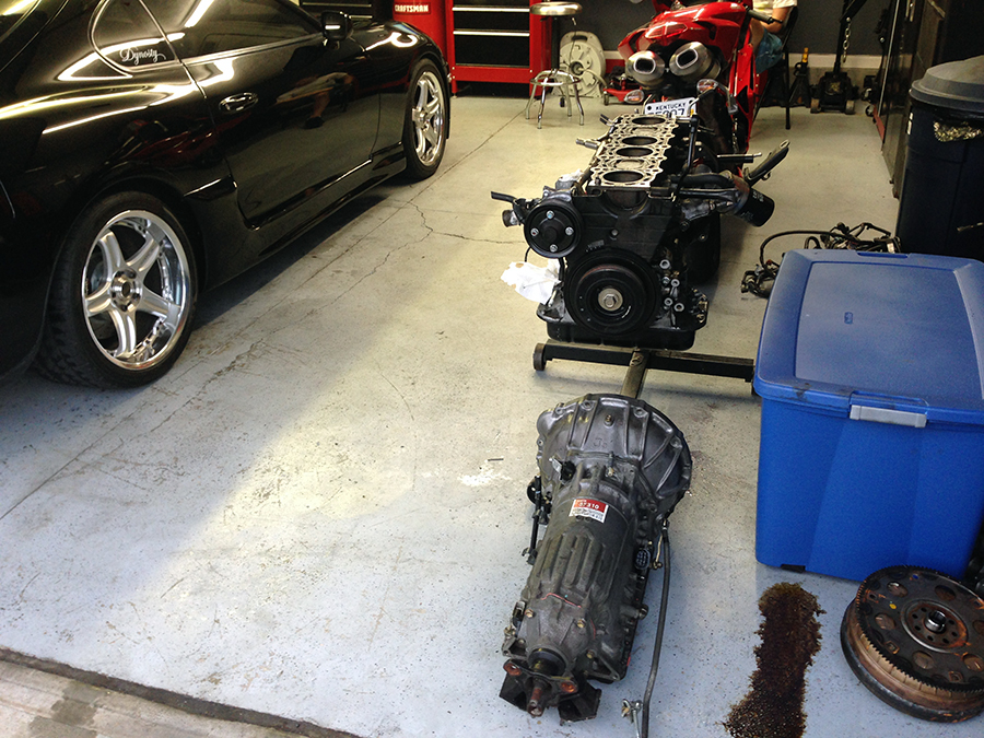

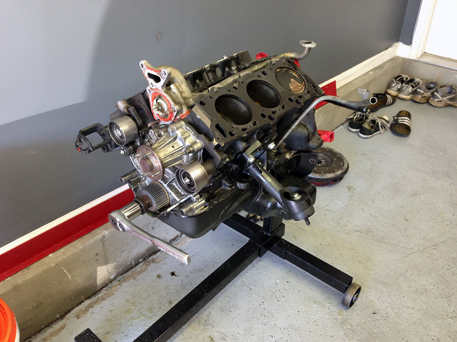

VG Tear Down

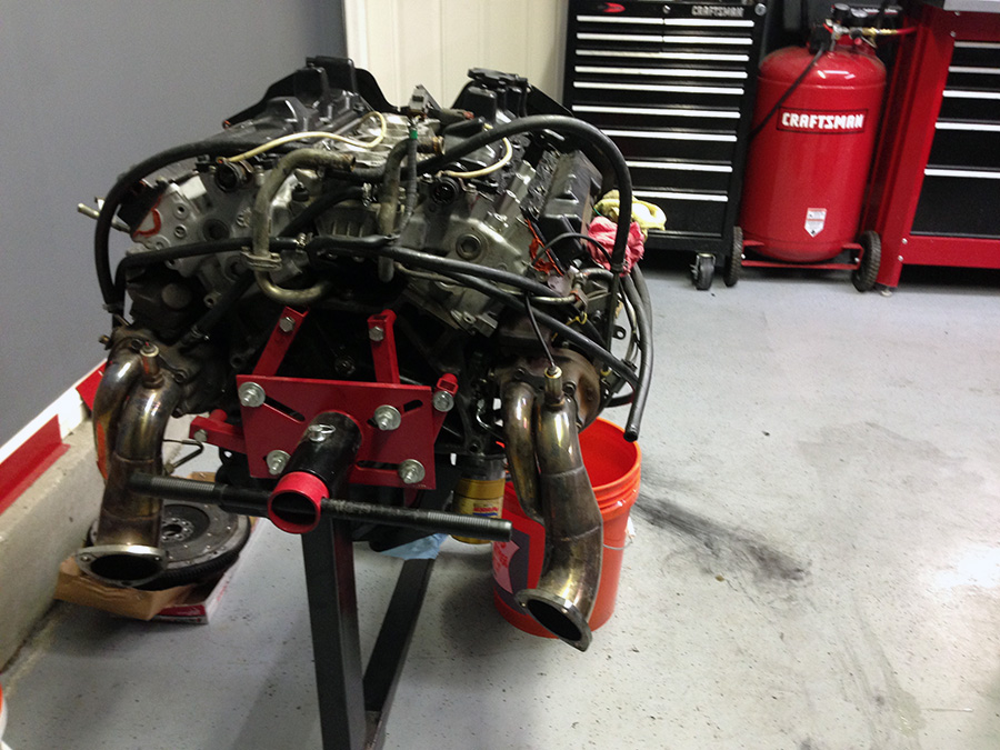

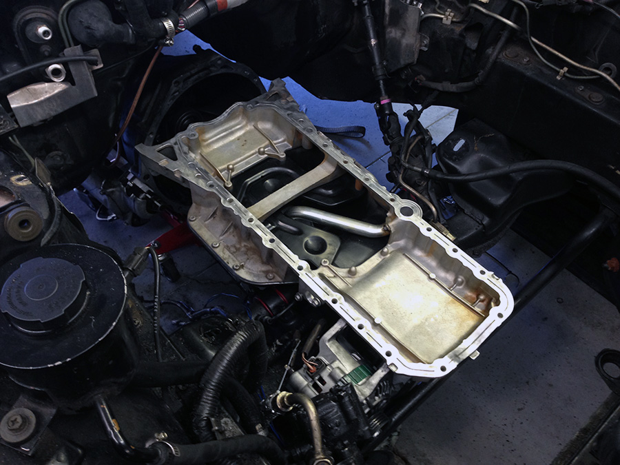

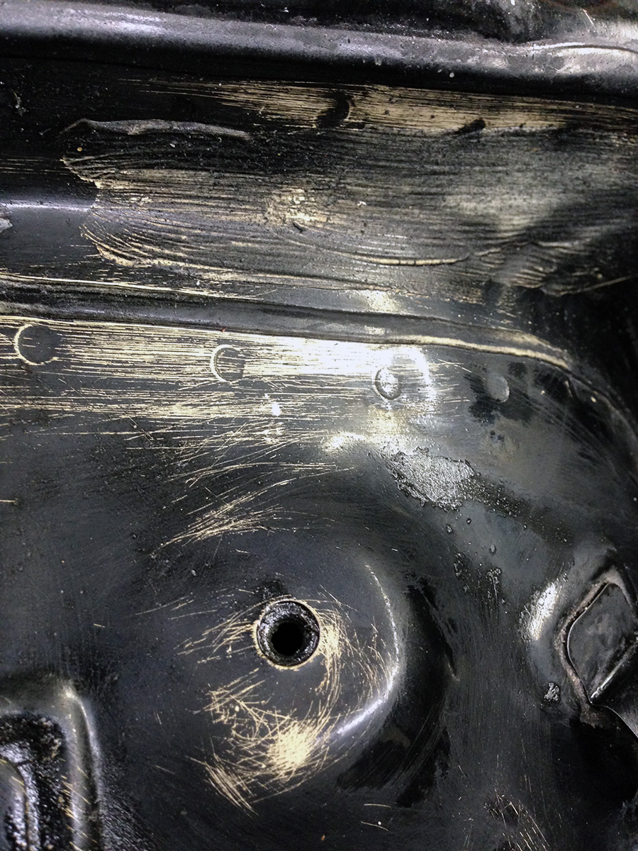

Mocking up oil pan placement

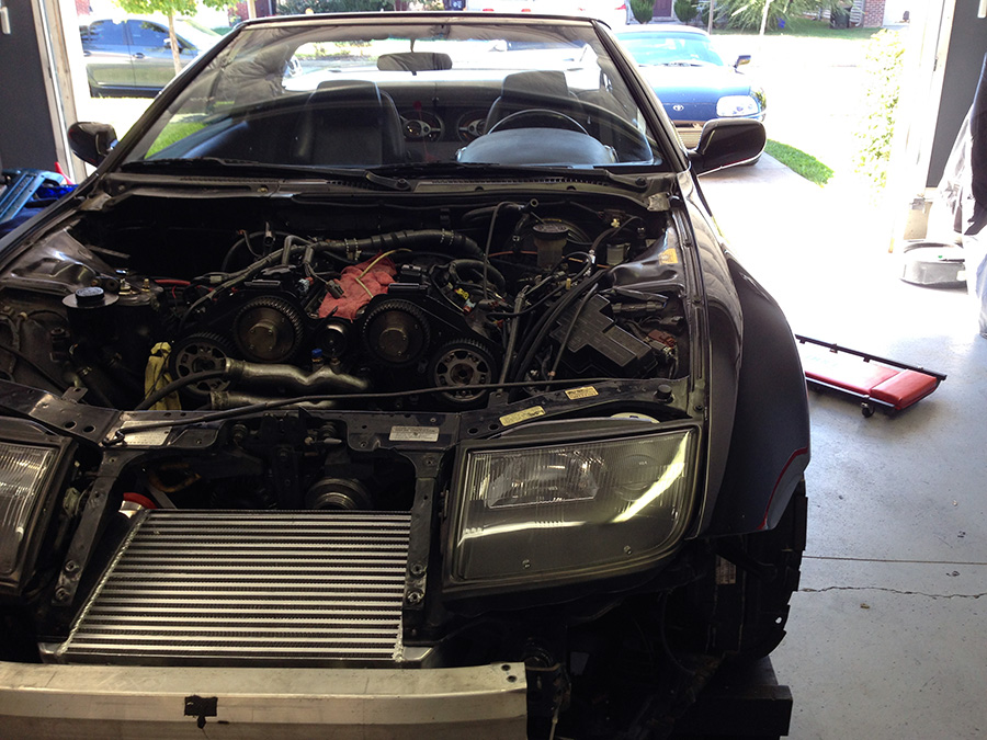

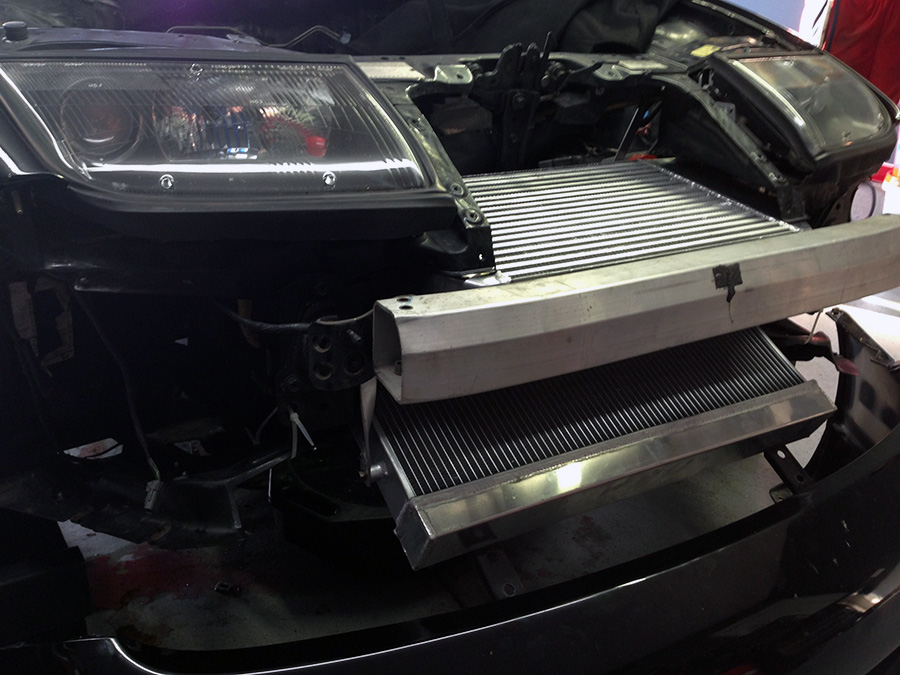

Mock up of the new V mount setup to accommodate the 2J

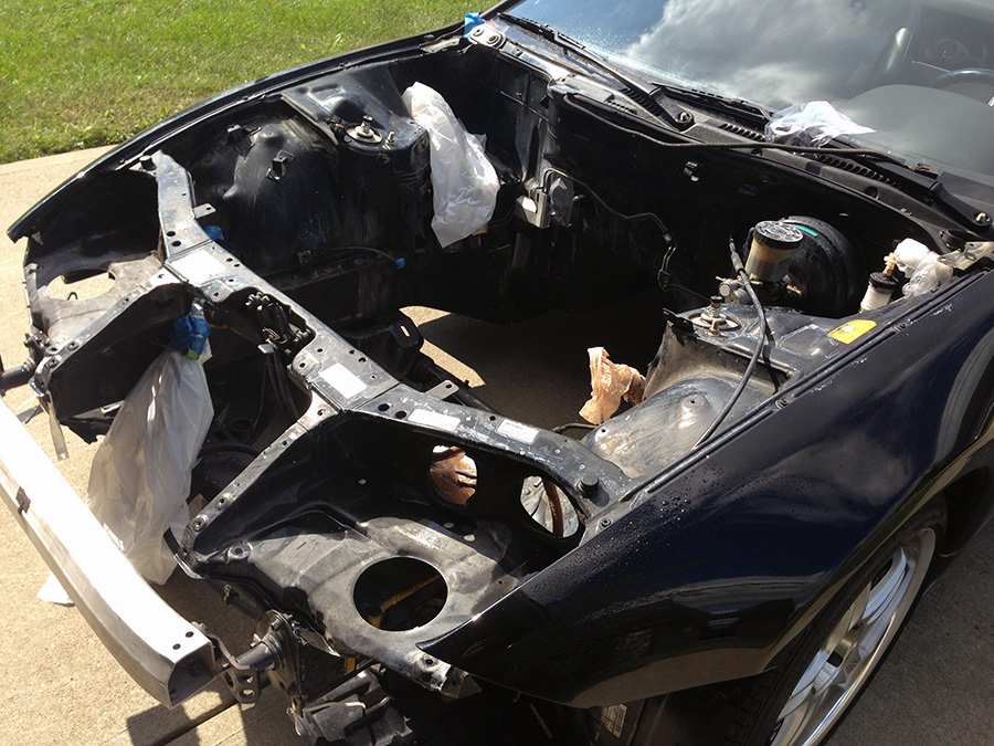

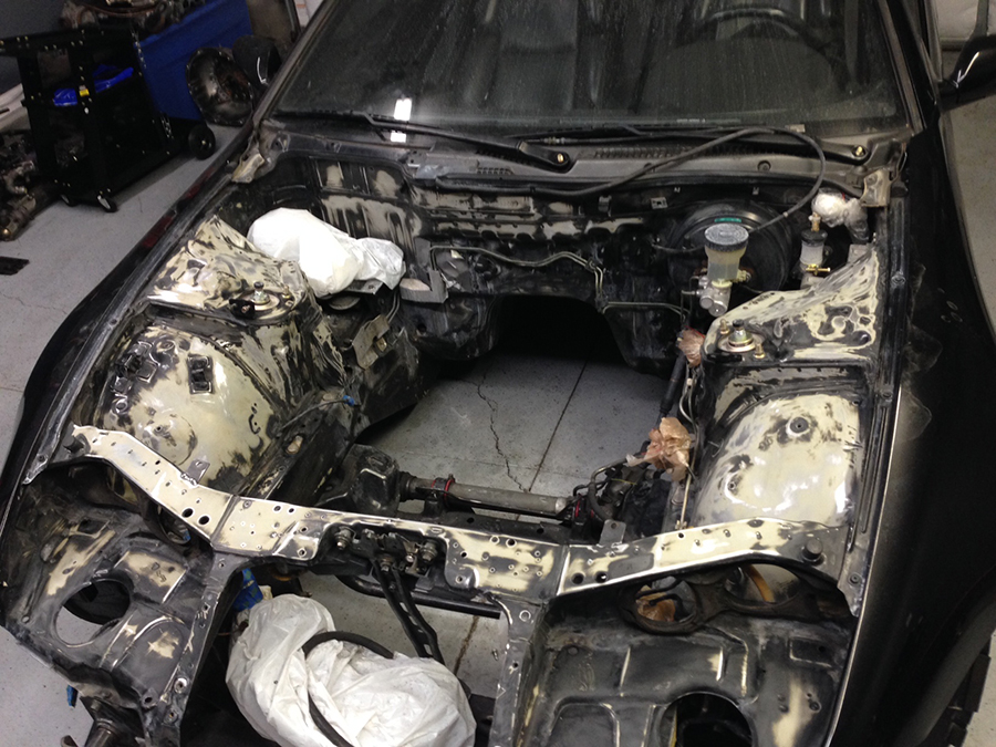

Starting the prep on the engine bay for paint...Justin was hell bent on just WD40'ing everything and being done. Don't know why he didn't want my first attempt at painting to be on his engine bay :)
We have the front and rear sump....still playing around ideas on how to fit everything up

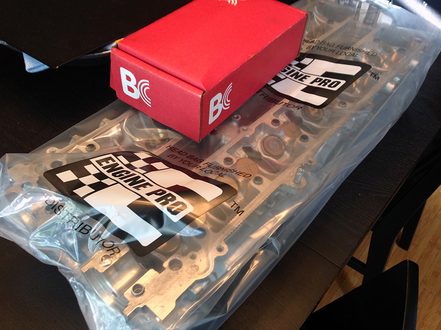

Head back from the machine shop
