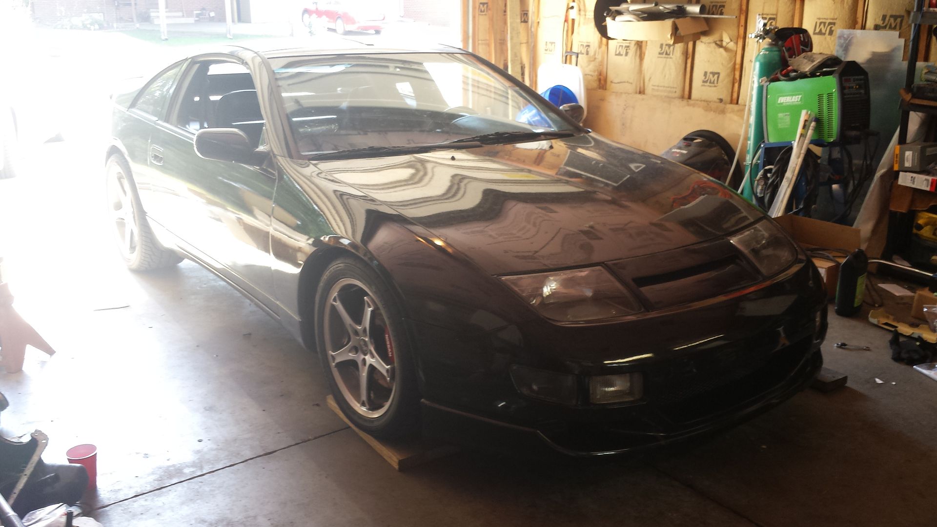

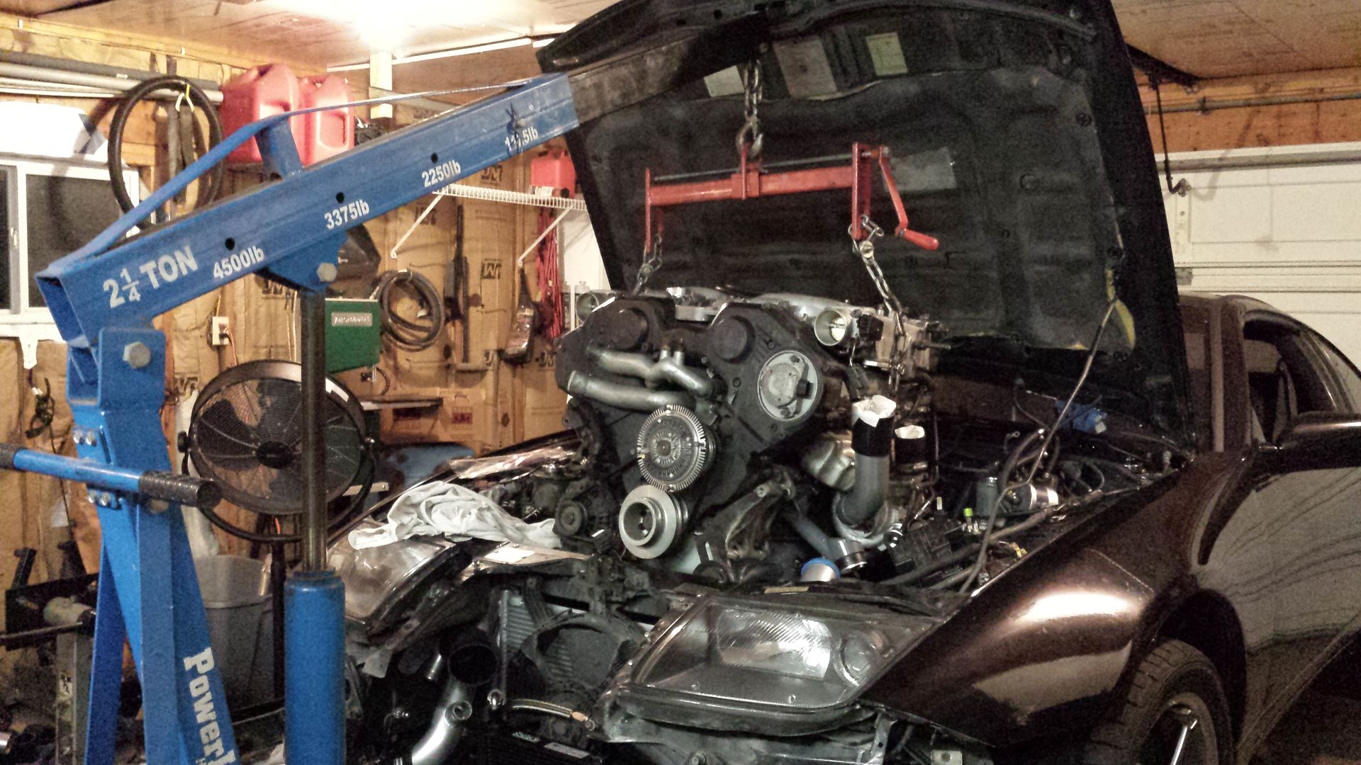

Freshly pulled in...

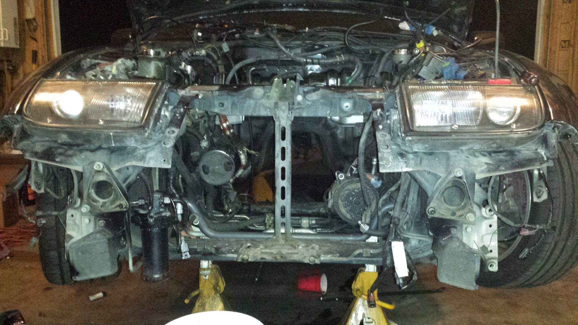

Engine Out

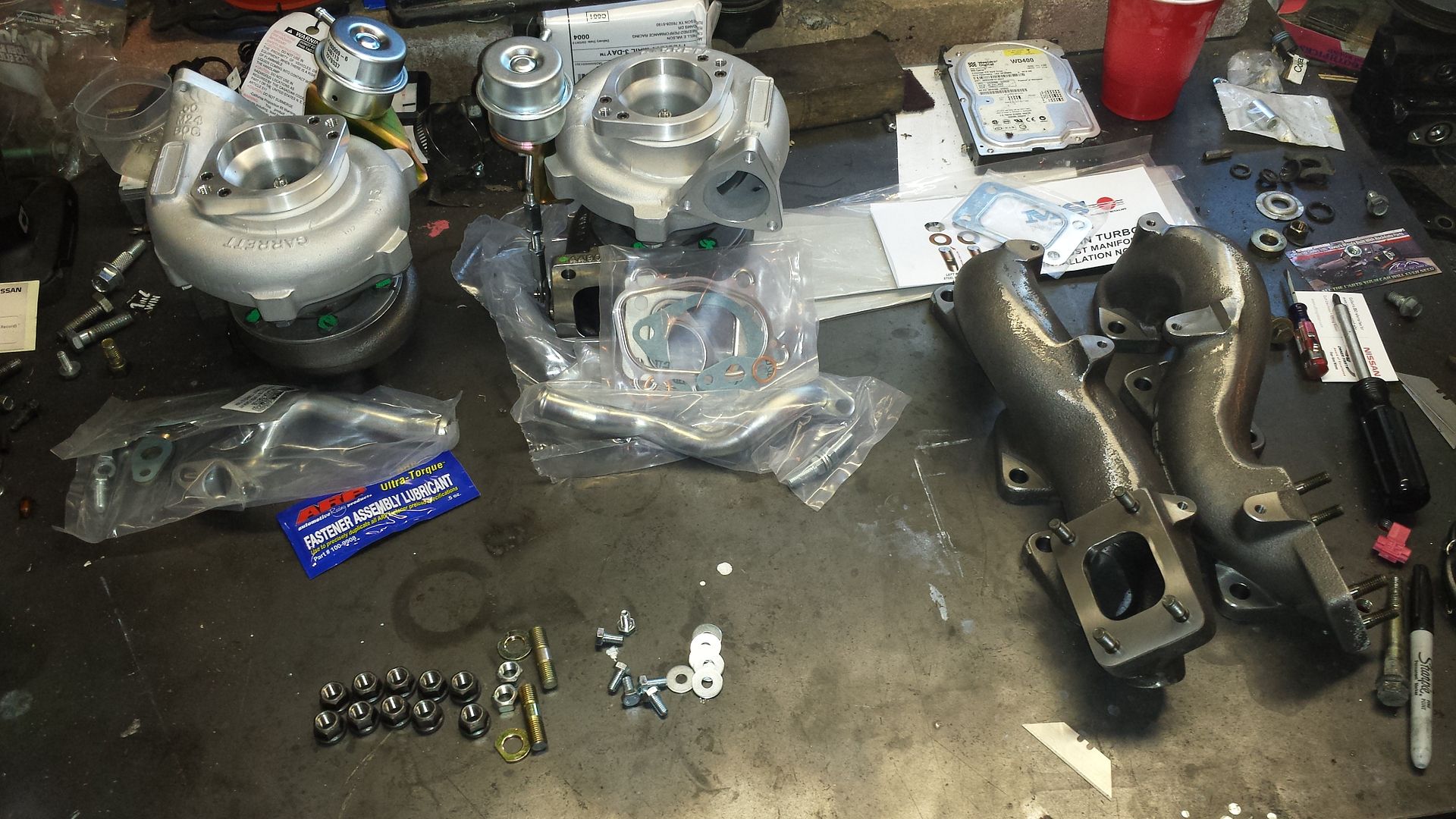

Some new goodies

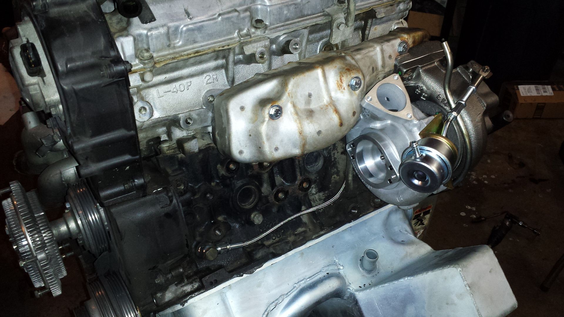

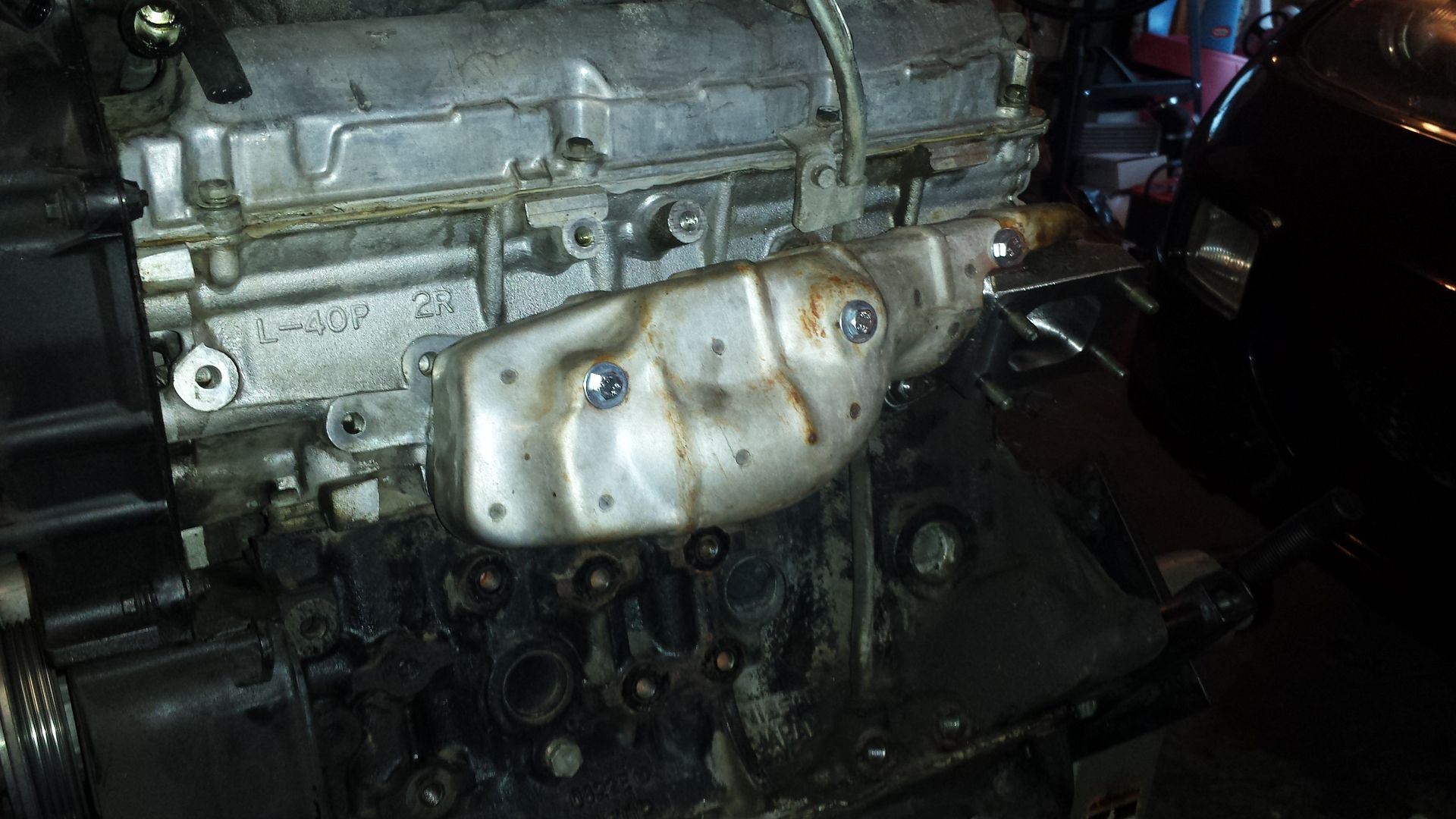

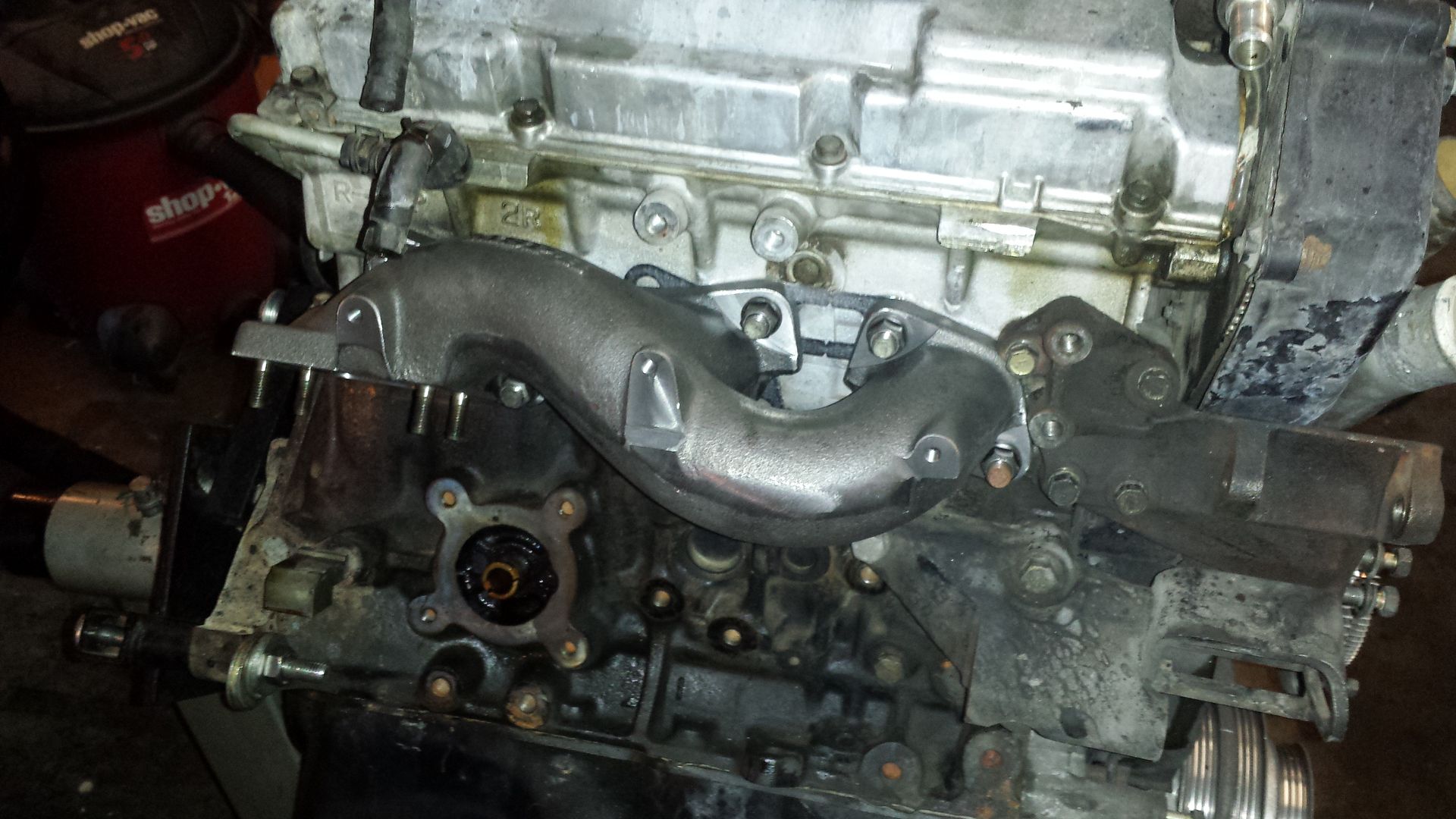

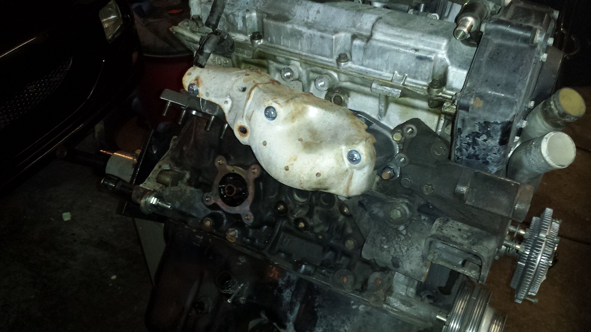

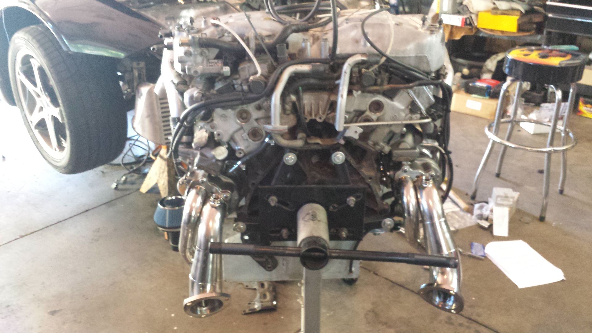

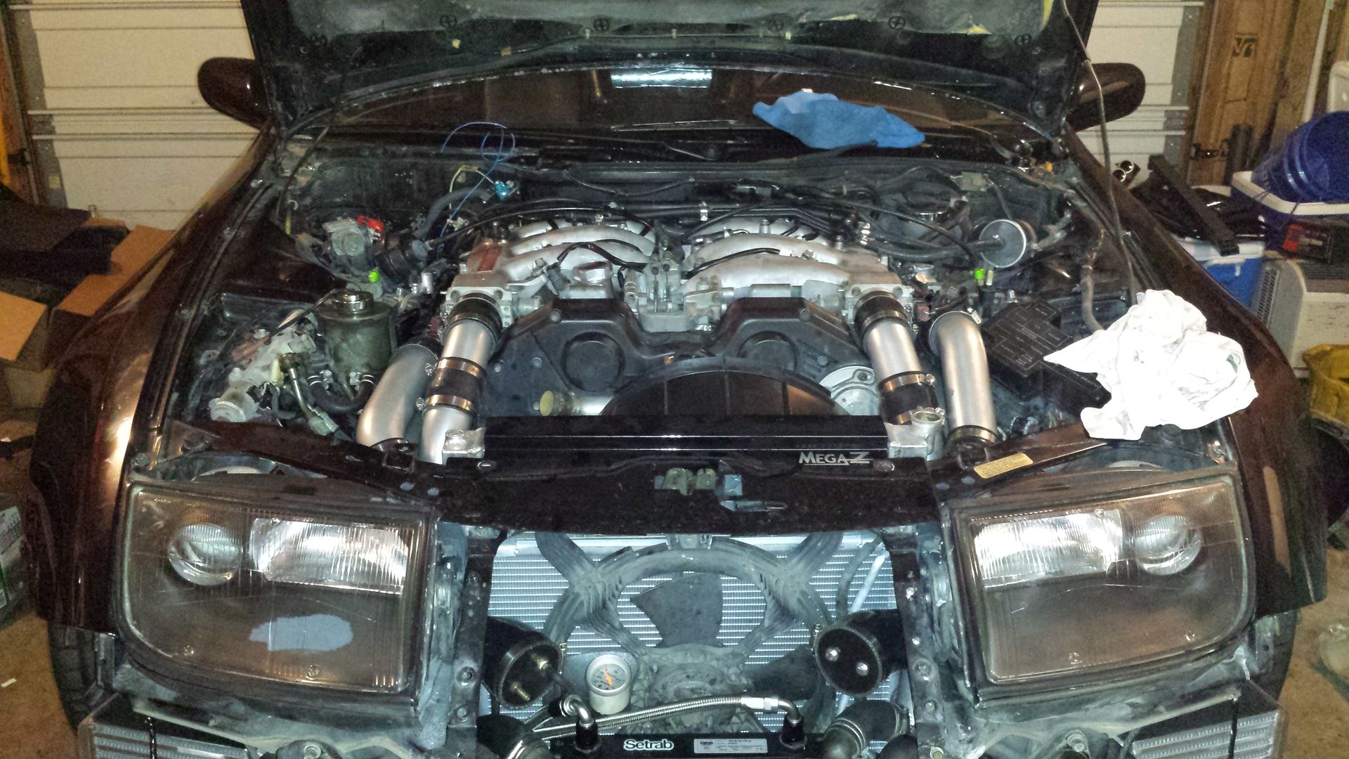

Tore off the stock turbos/manis. New stuff going on

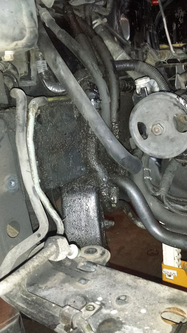

Looks like something with the PS was leaking!

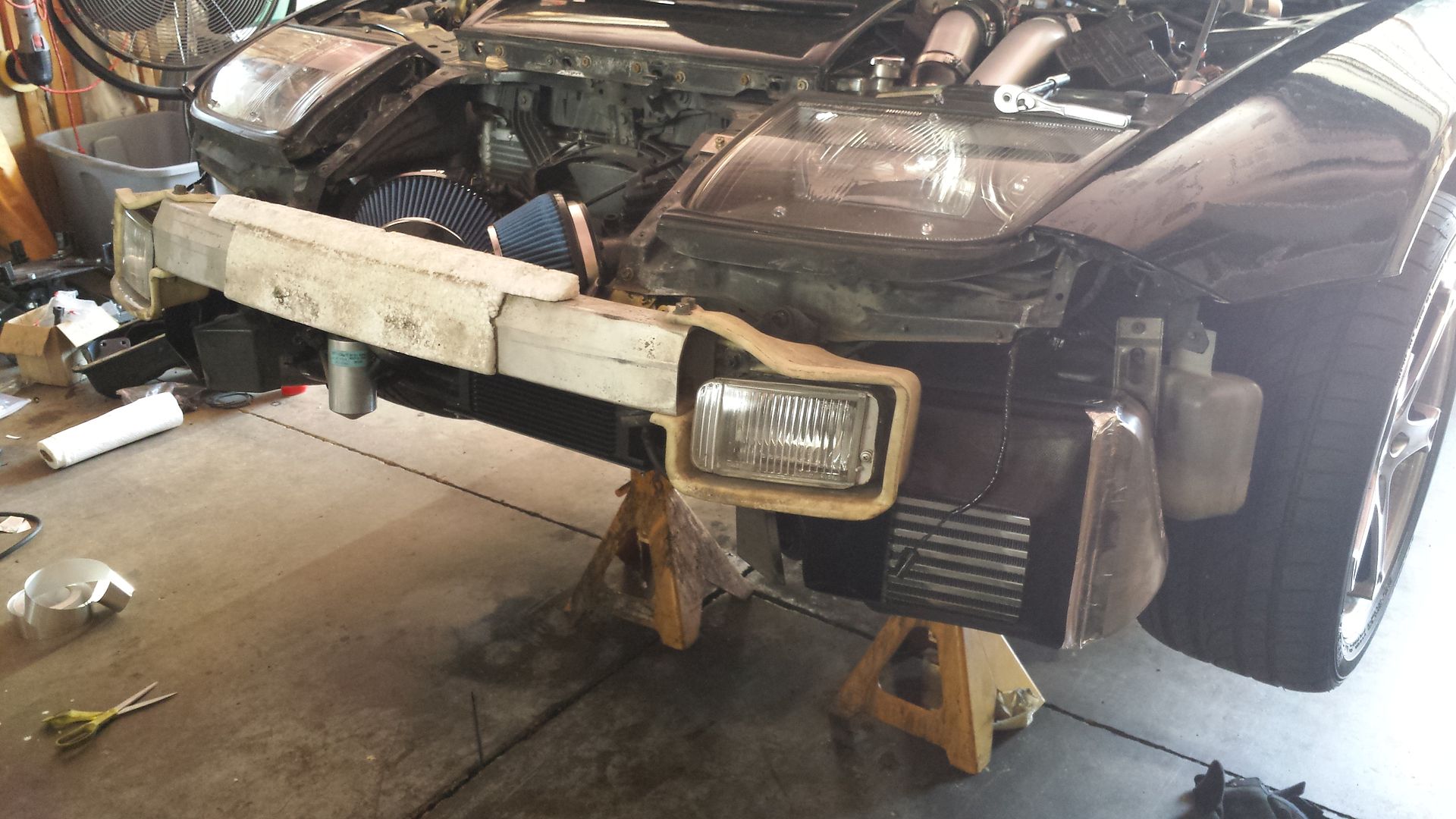

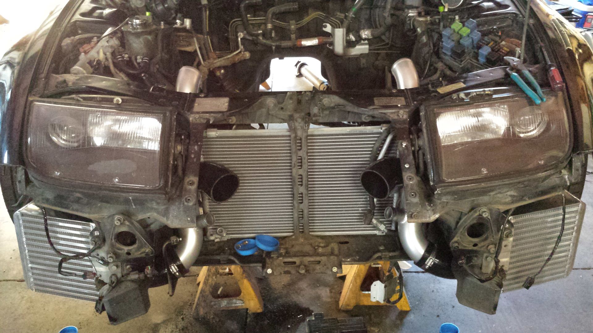

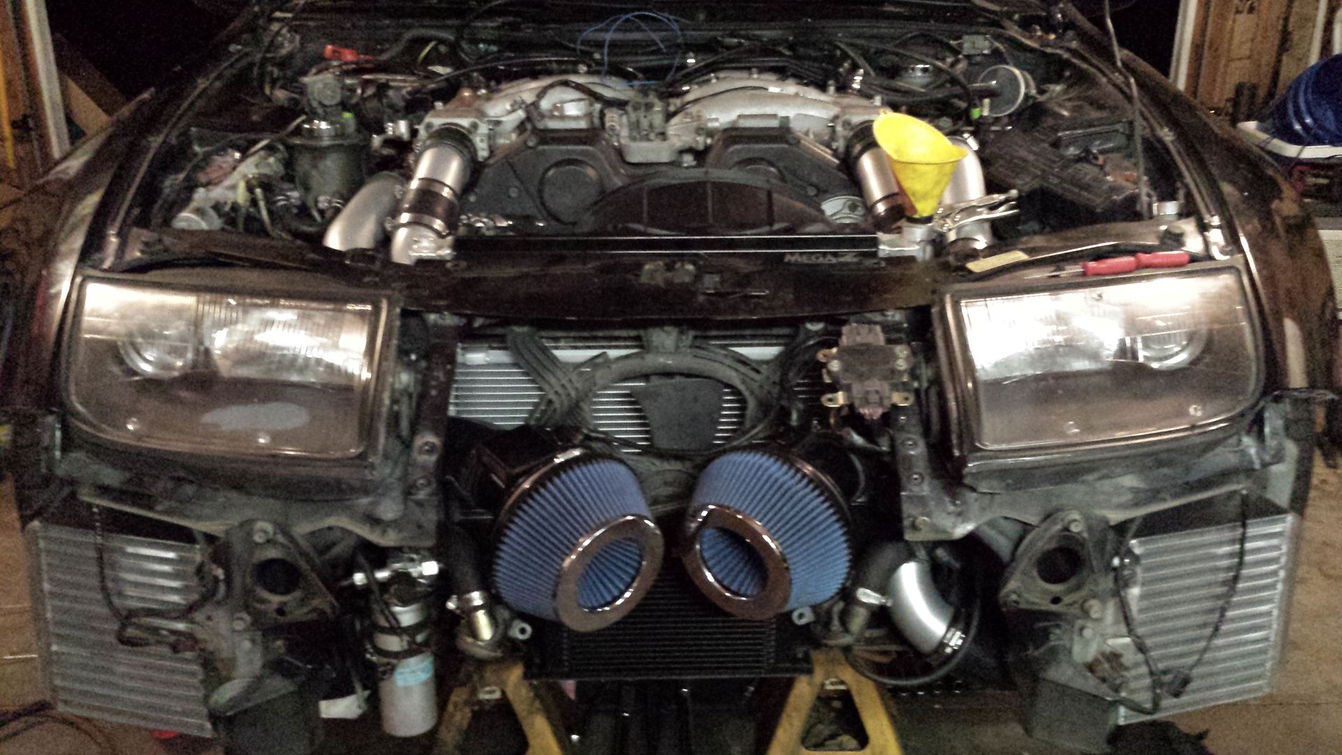

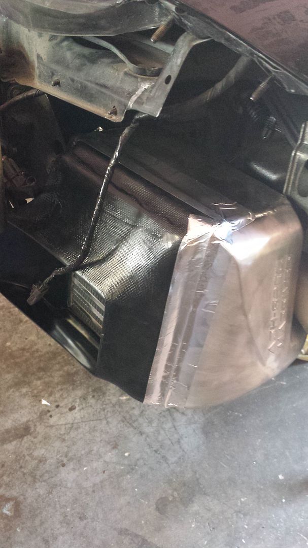

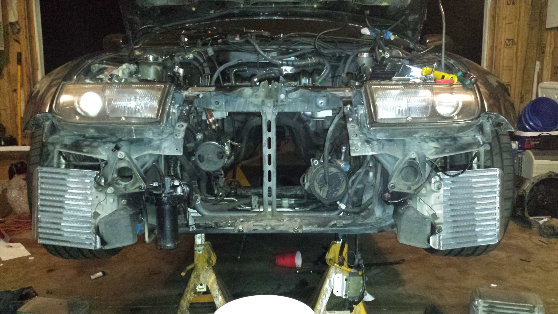

Ashspec SMIC's installed
Ashspec 2.5 IC Pipe & Planar Kit

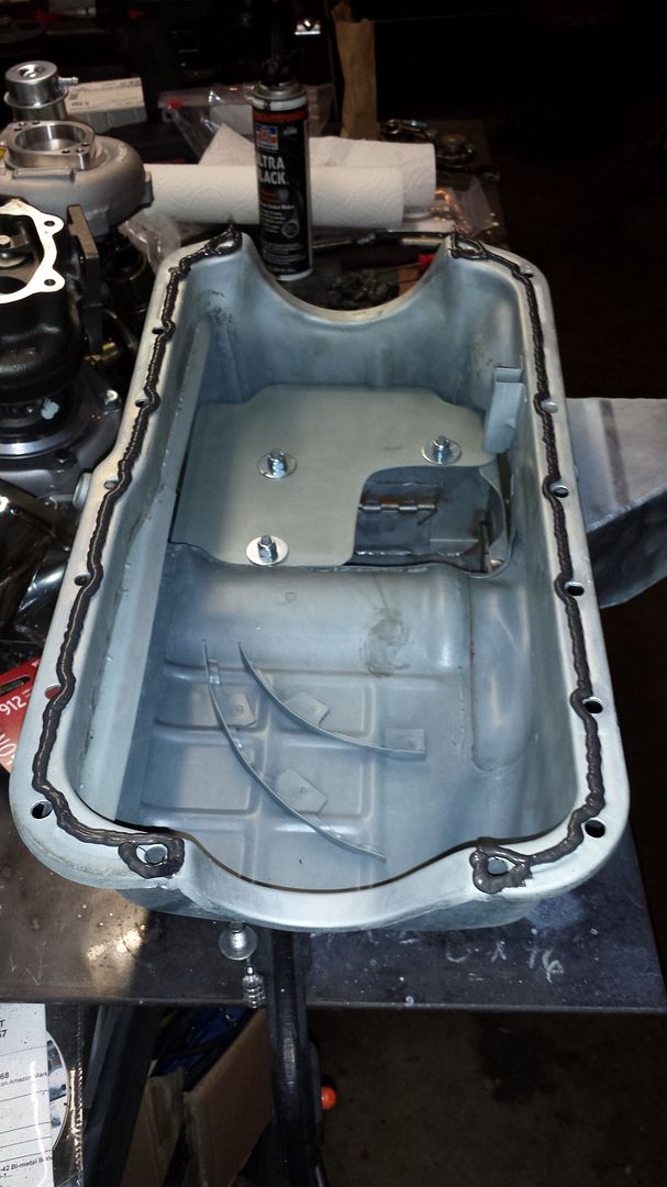

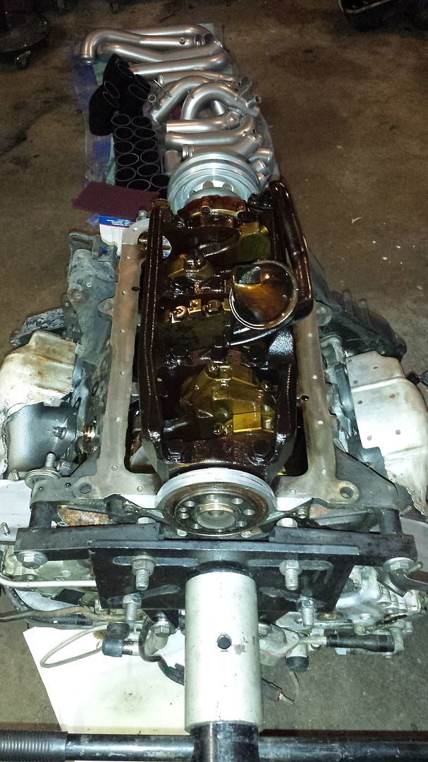

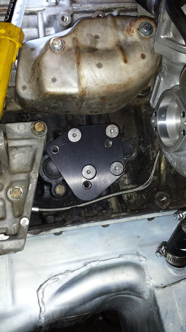

stock oil pan removed
SZ Big sump pan going on

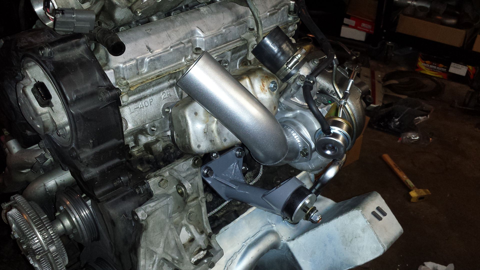

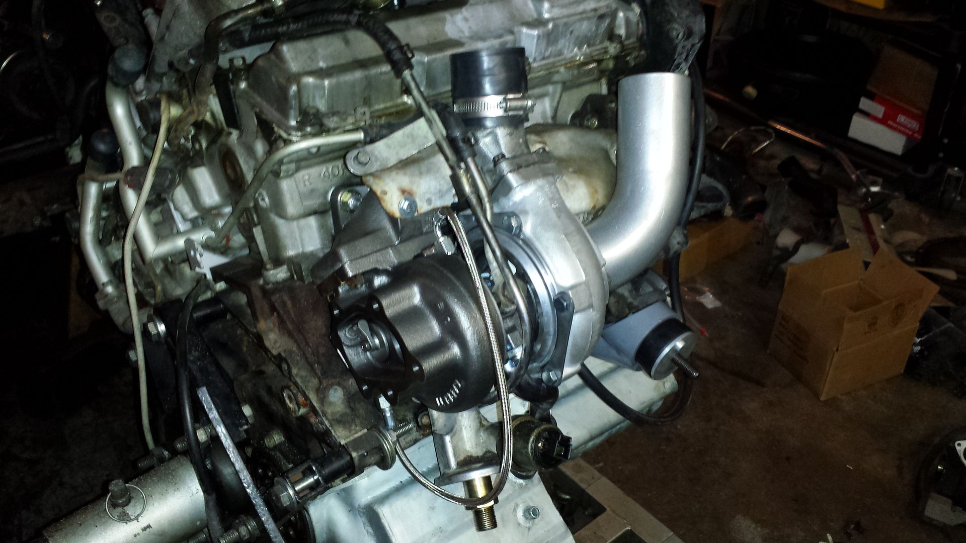

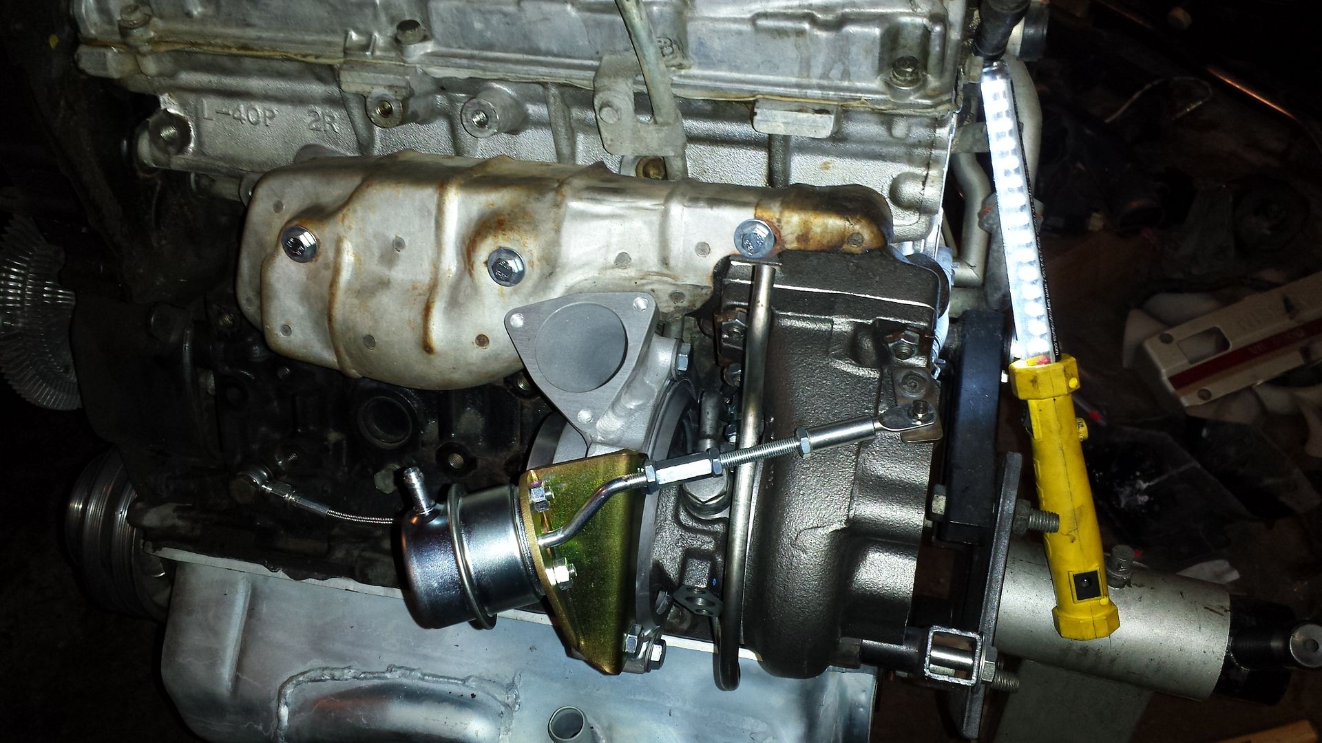

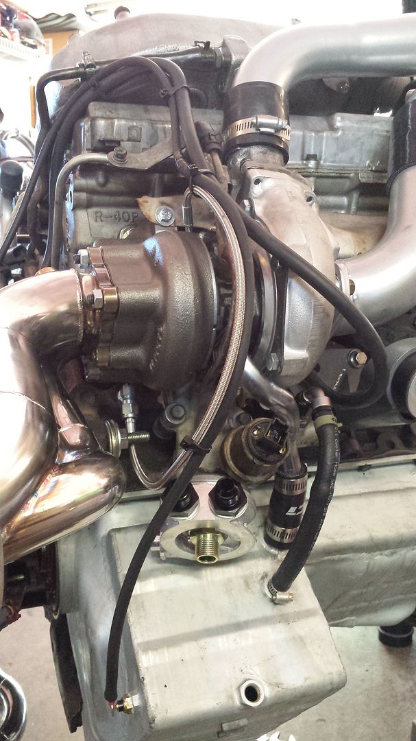

Turbos and accessories going on

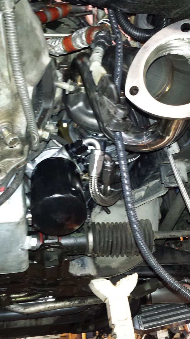

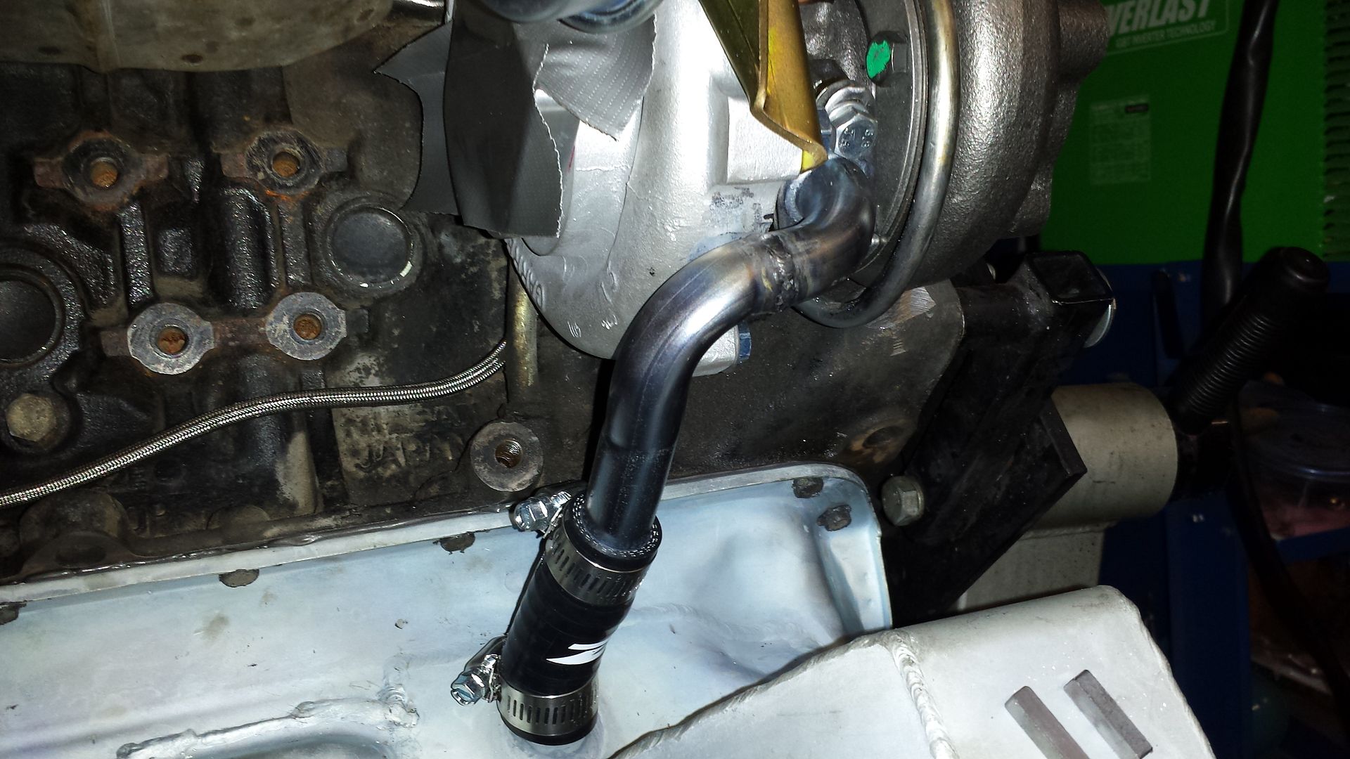

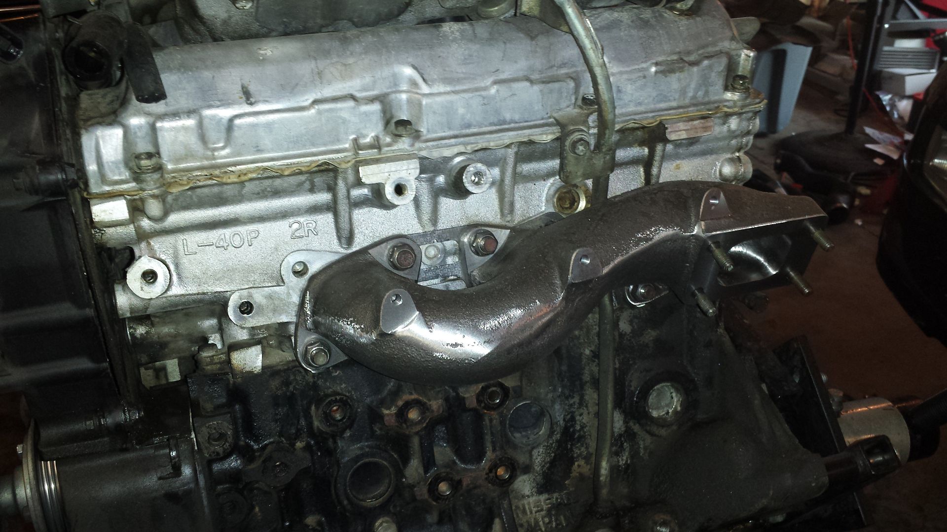

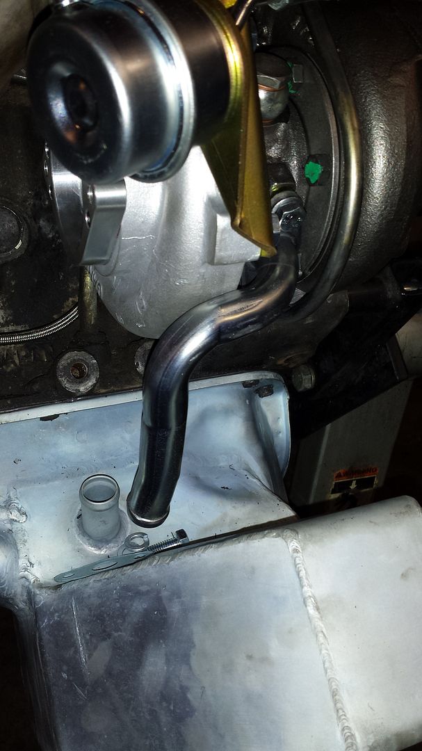

No matter how I clocked the turbos, the oil drains would not line up
Marked, Cut, TIG Welded. Much better fitment

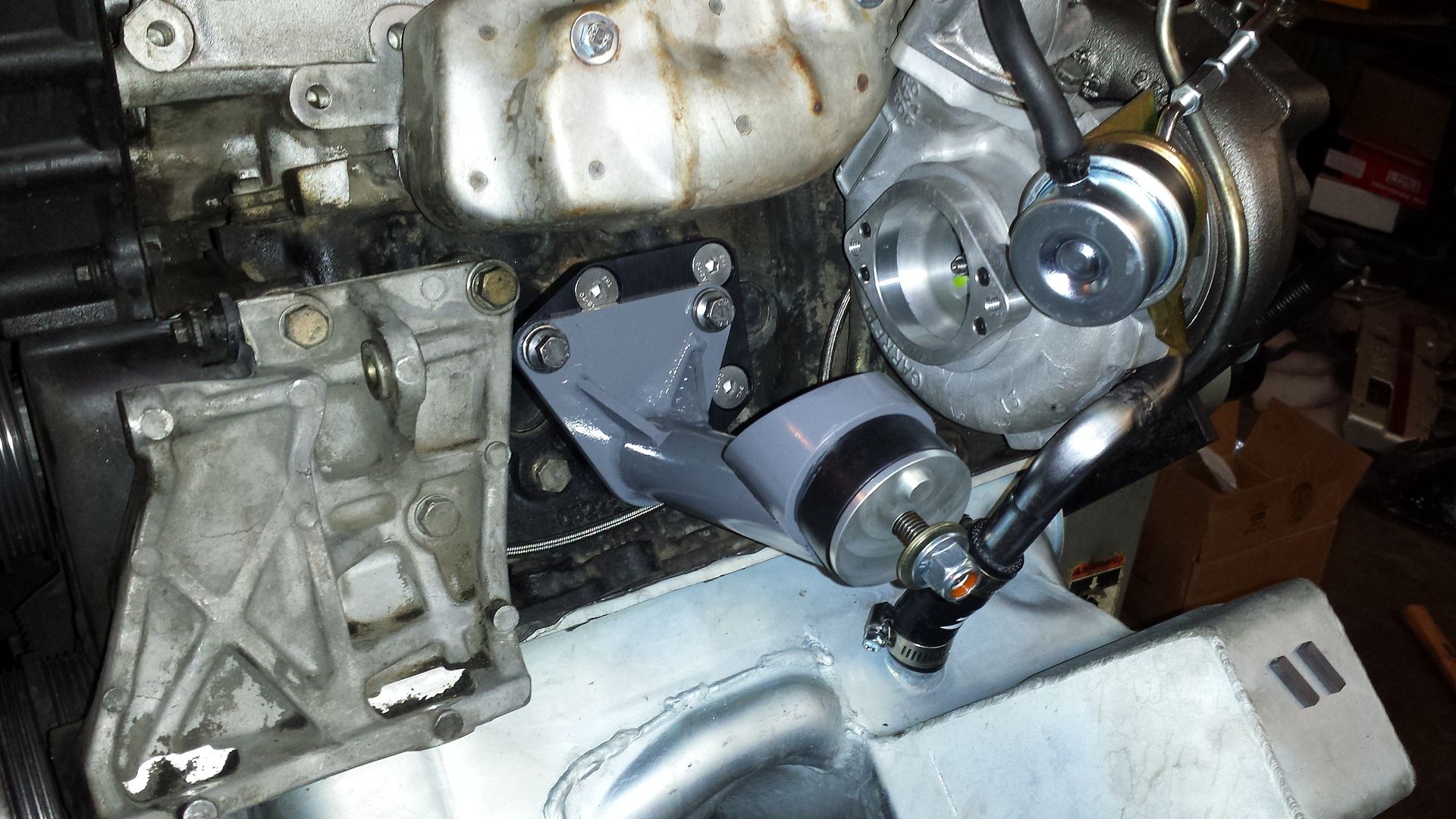

BDE mounts to give clearance to the bigger piping

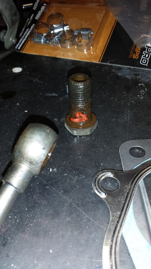

Found this.....Always use RTV sparingly!

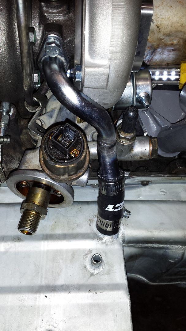

Ran into the same oil return issue on the passenger side
Pass side complete

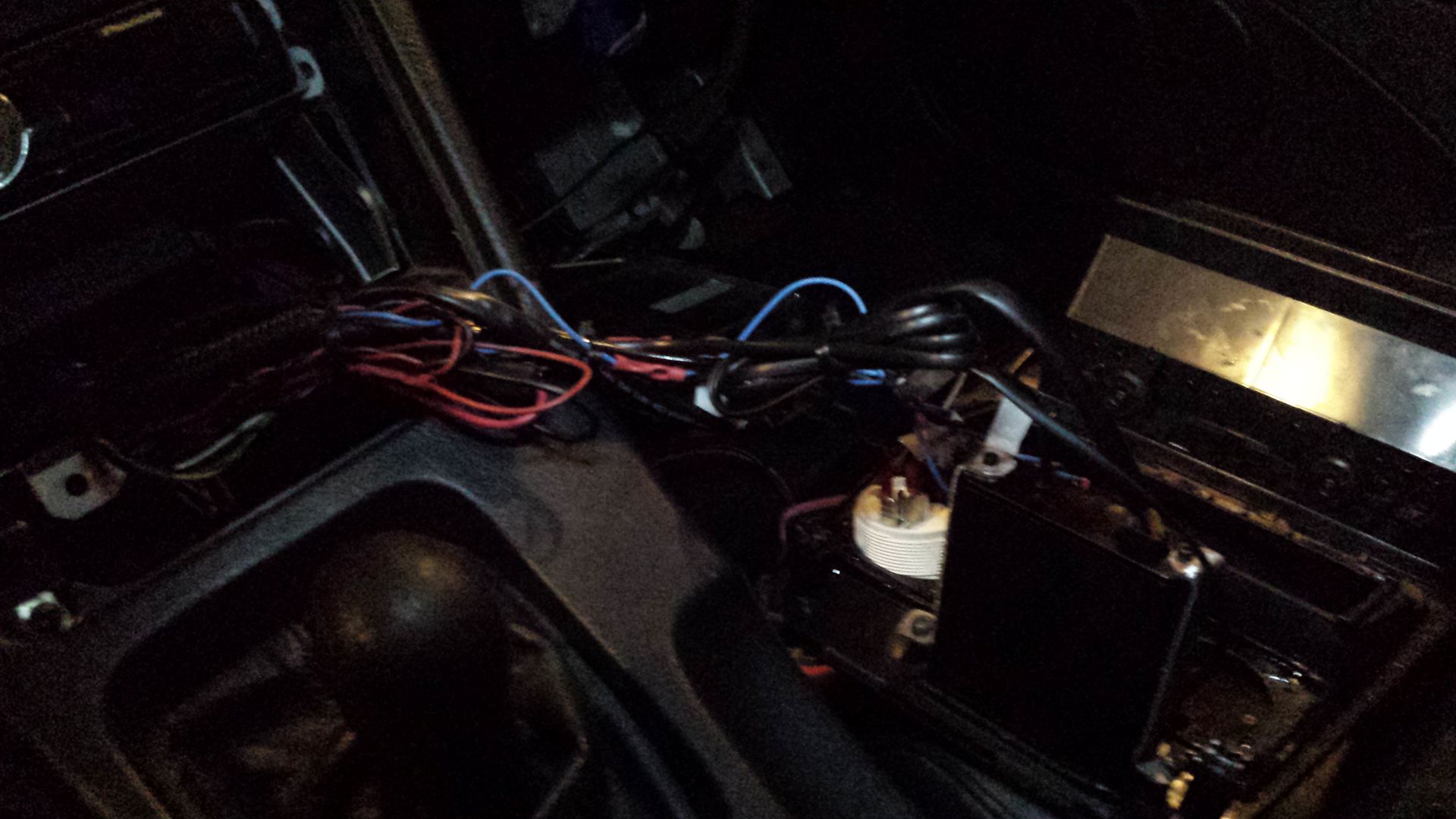

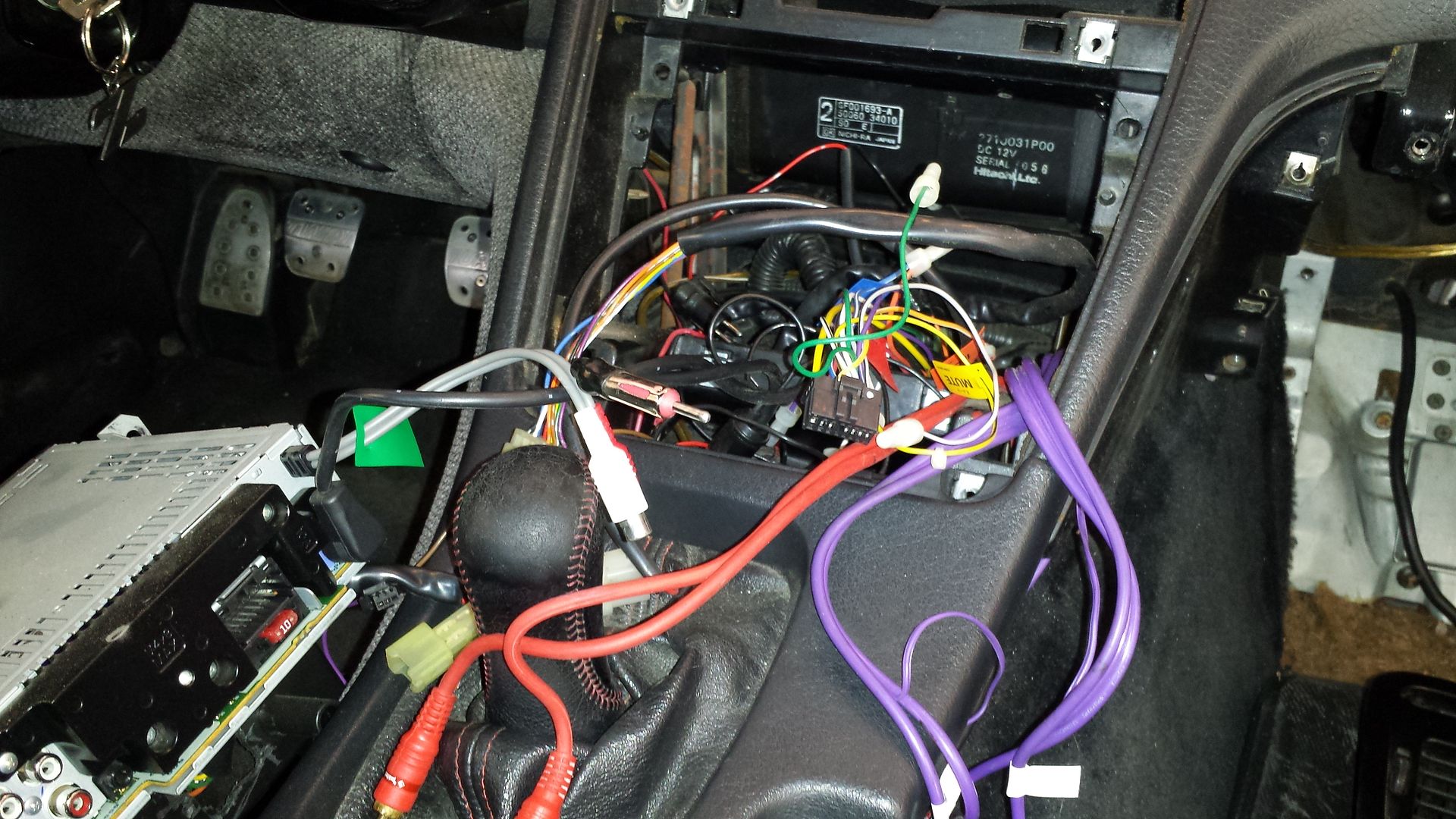

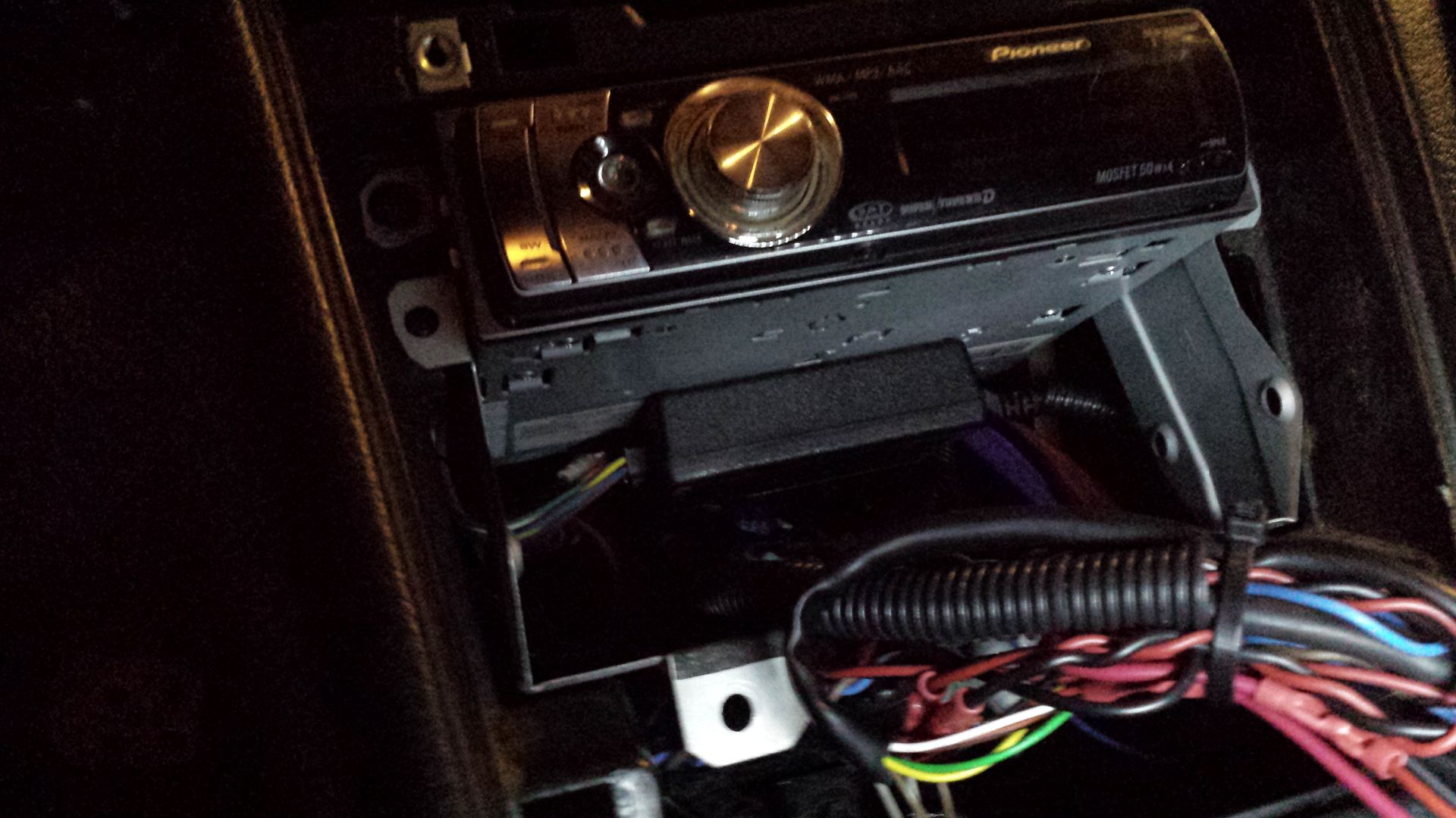

Found this doozie behind the radio bezel

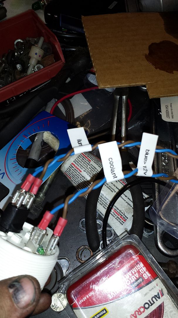

Wiring for the new gauges

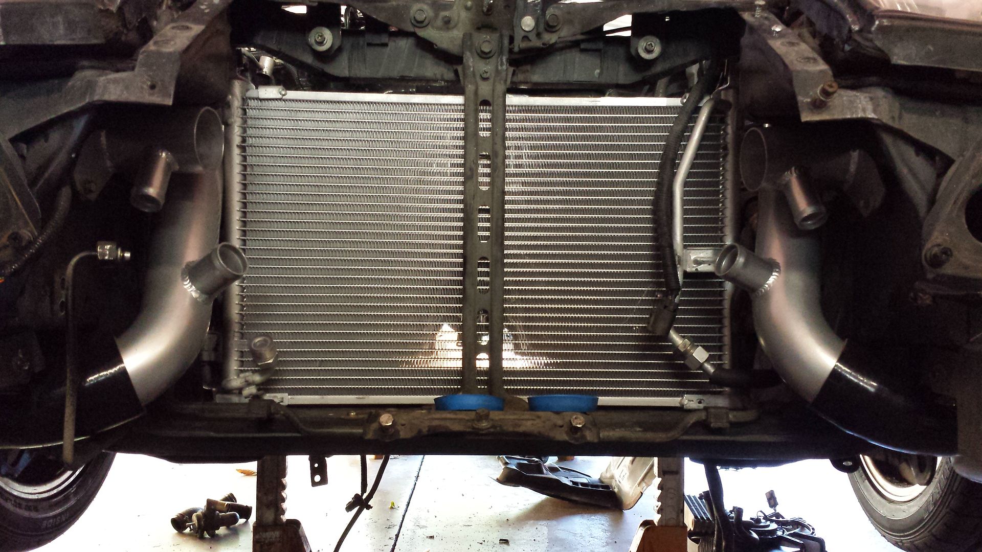

New piping and AC condenser going in

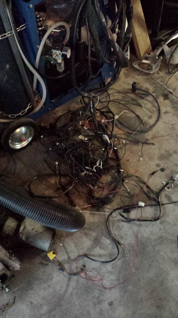

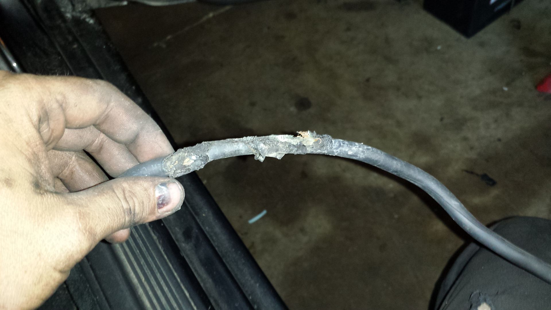

Made some new fire-wall pass thrus with good grommets. Notice the amp wire running right through the firewall sitting on bare metal?
This could have burned the car down. Glad it was found

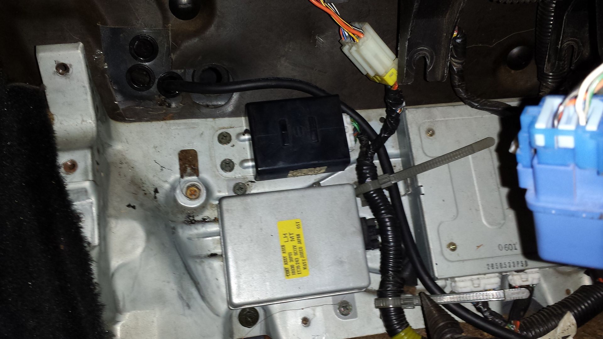

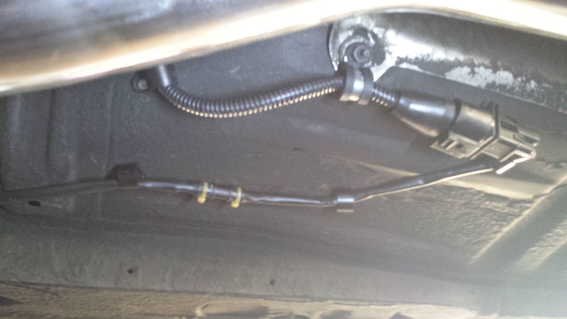

Also pulled this from under the dash

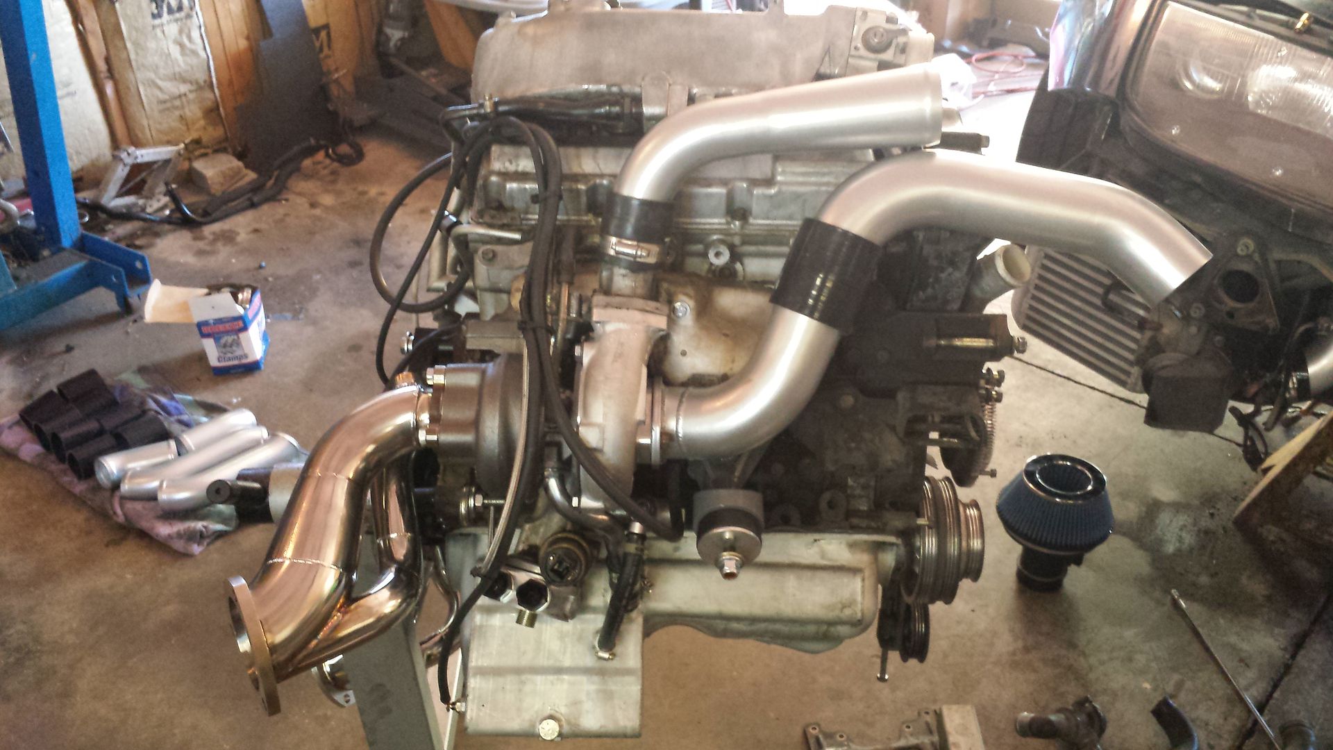

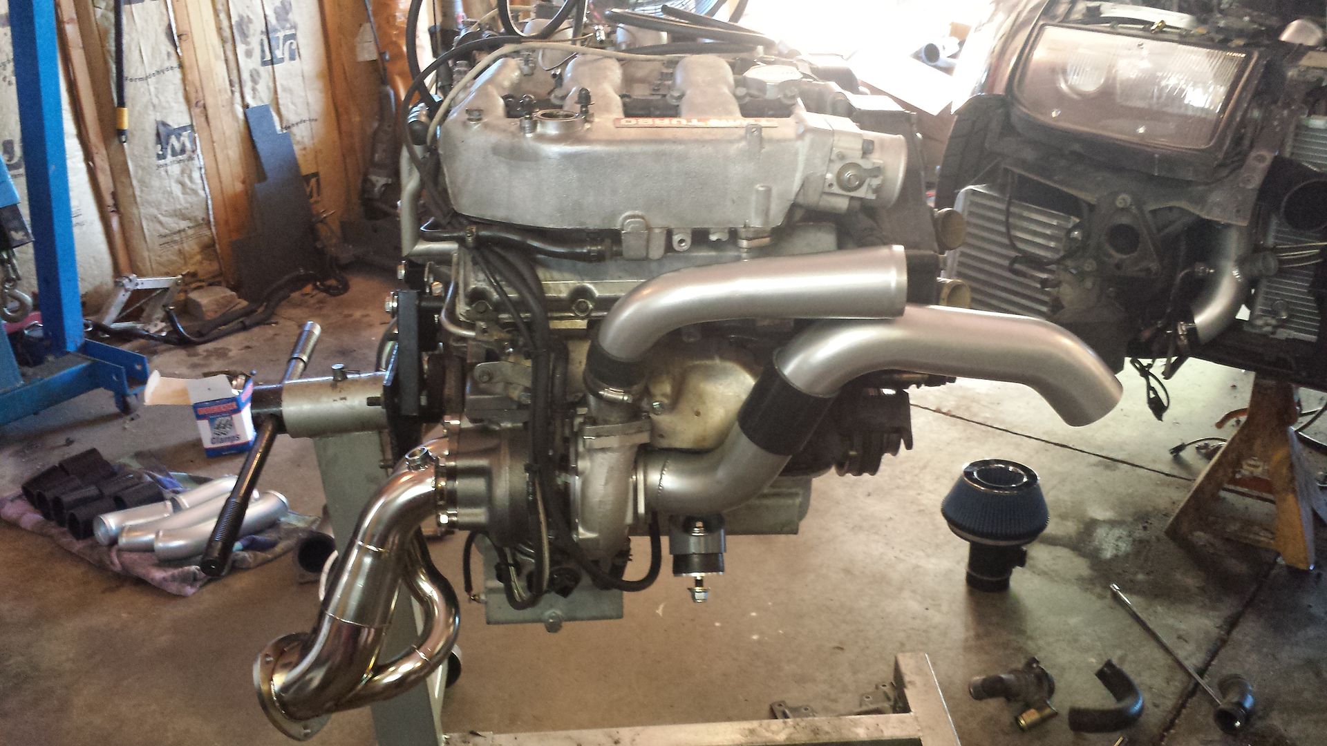

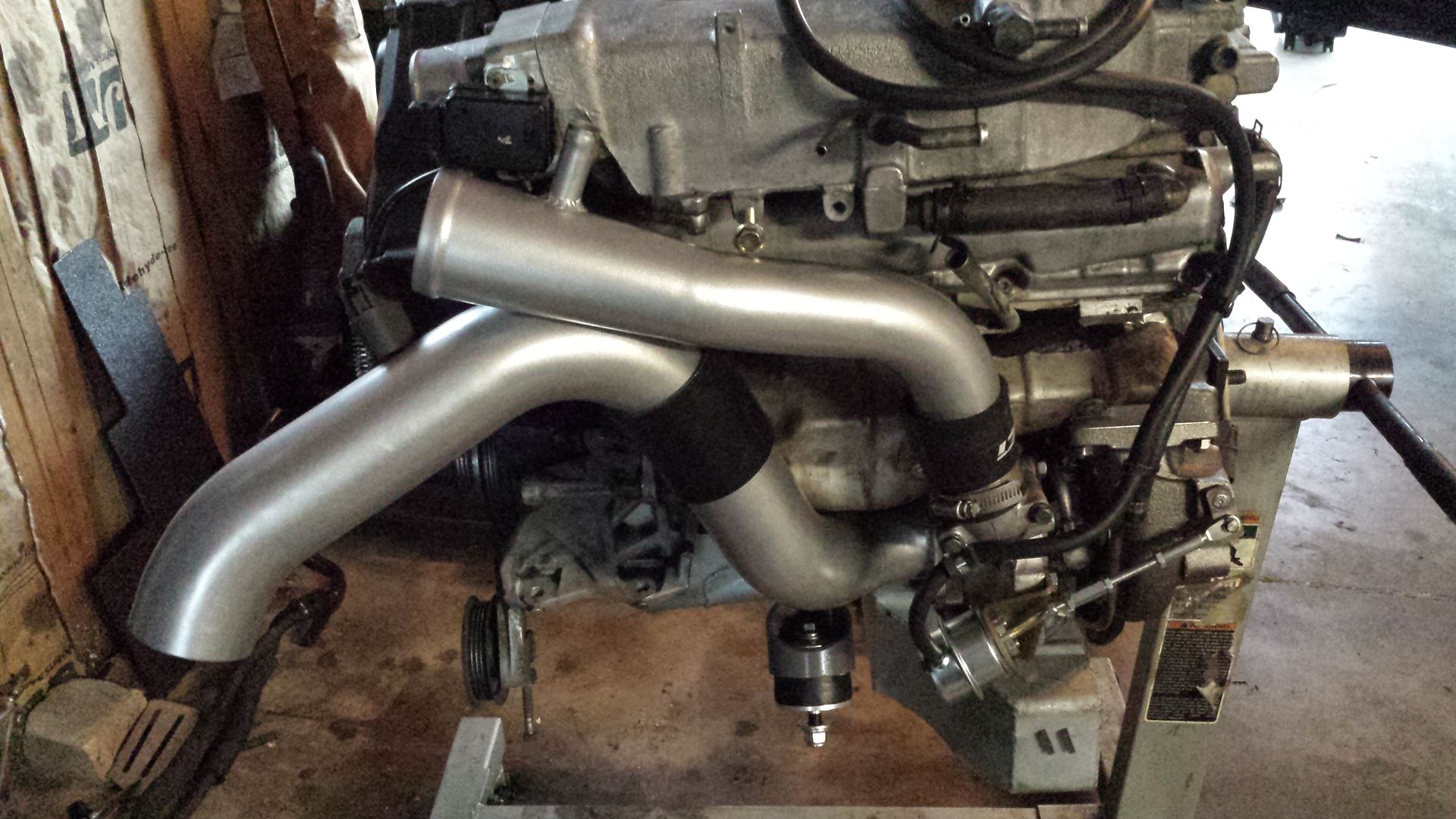

Piping mock-up

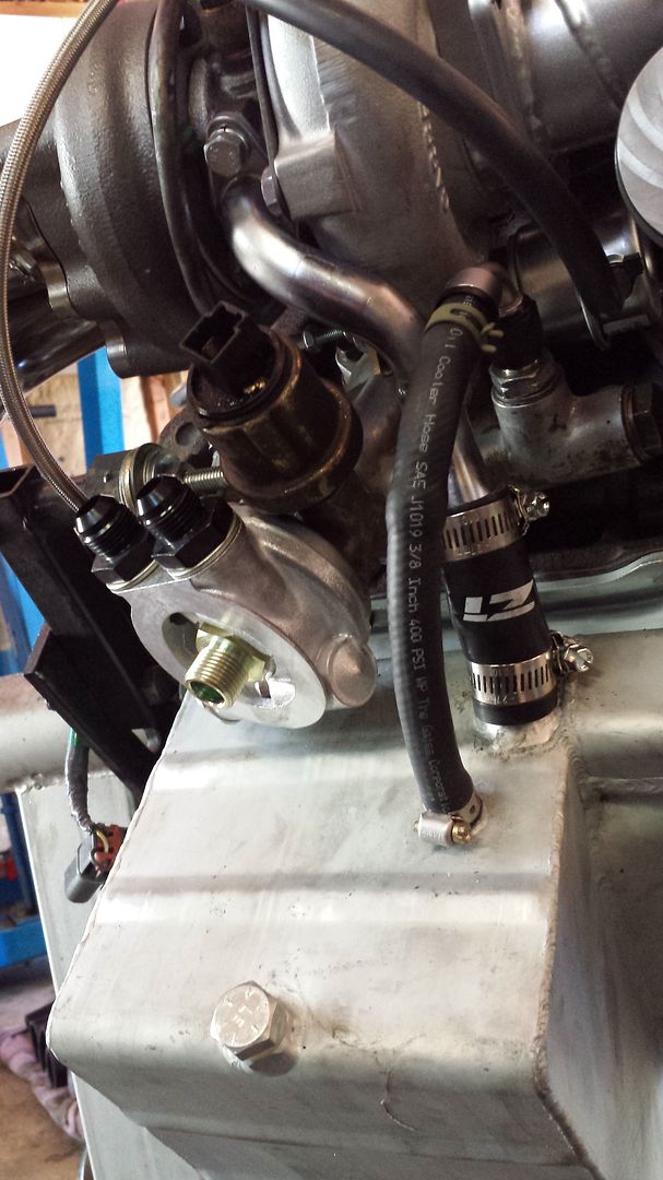

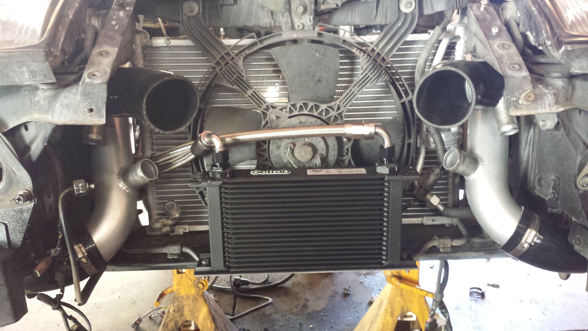

Z1 Full Flow Cooler install

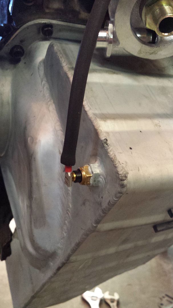

Oil temp Sending unit

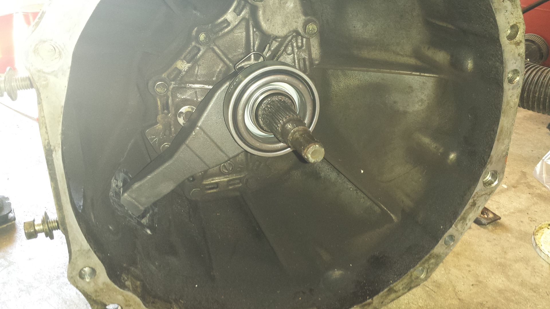

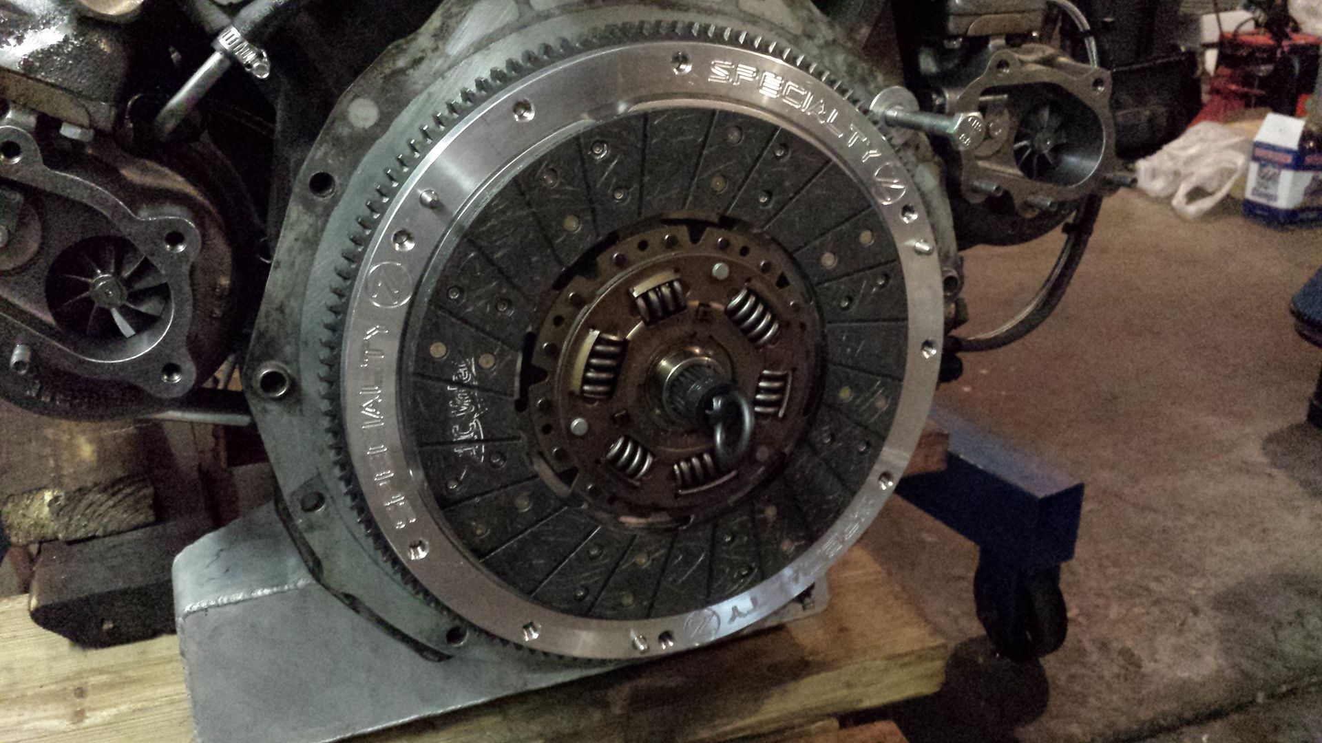

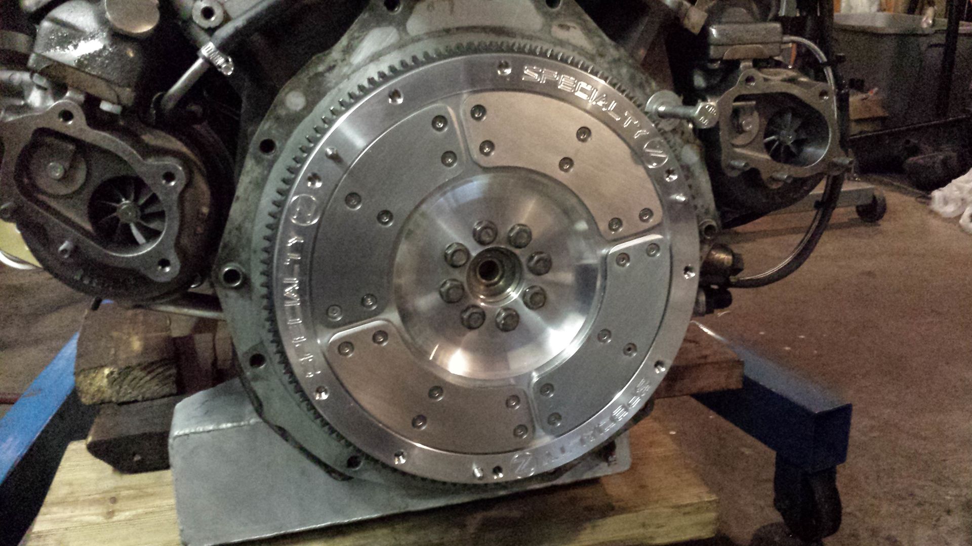

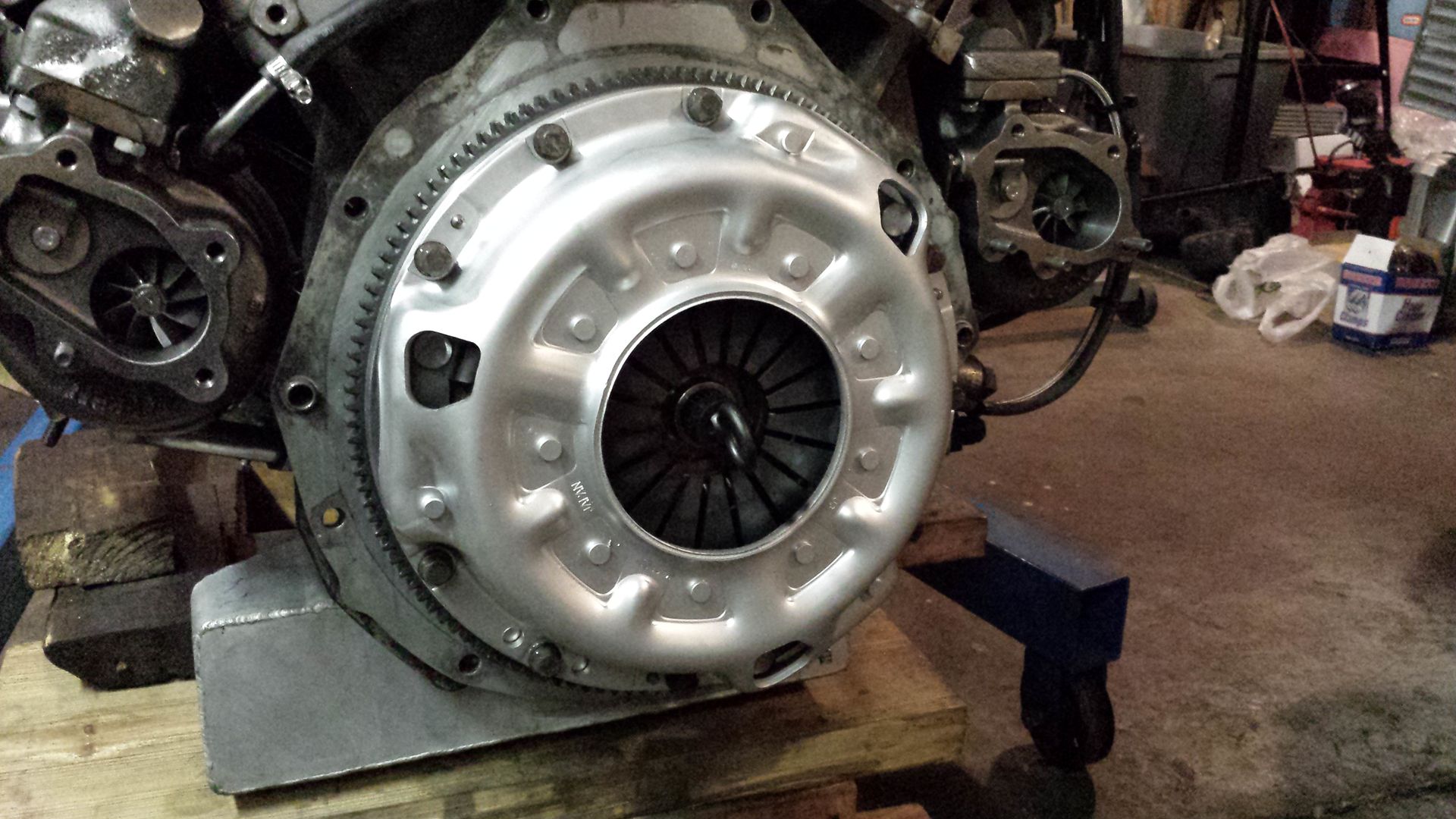

SZ FW and High-5 Clutch
Time to drp the engine in
Upgraded Clutch Fork & Pivot Ball

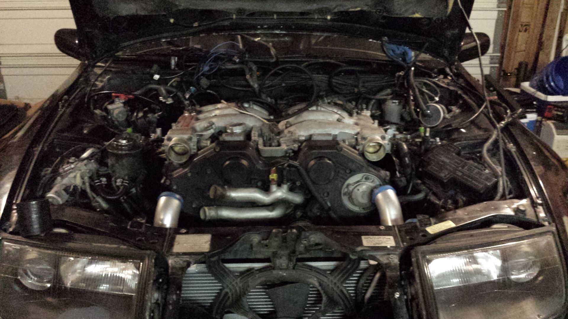

Stock recircs modified to work with bigger piping

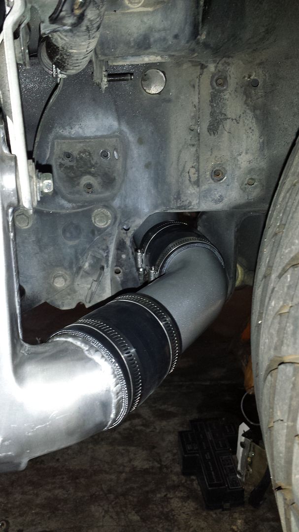

Piping installed

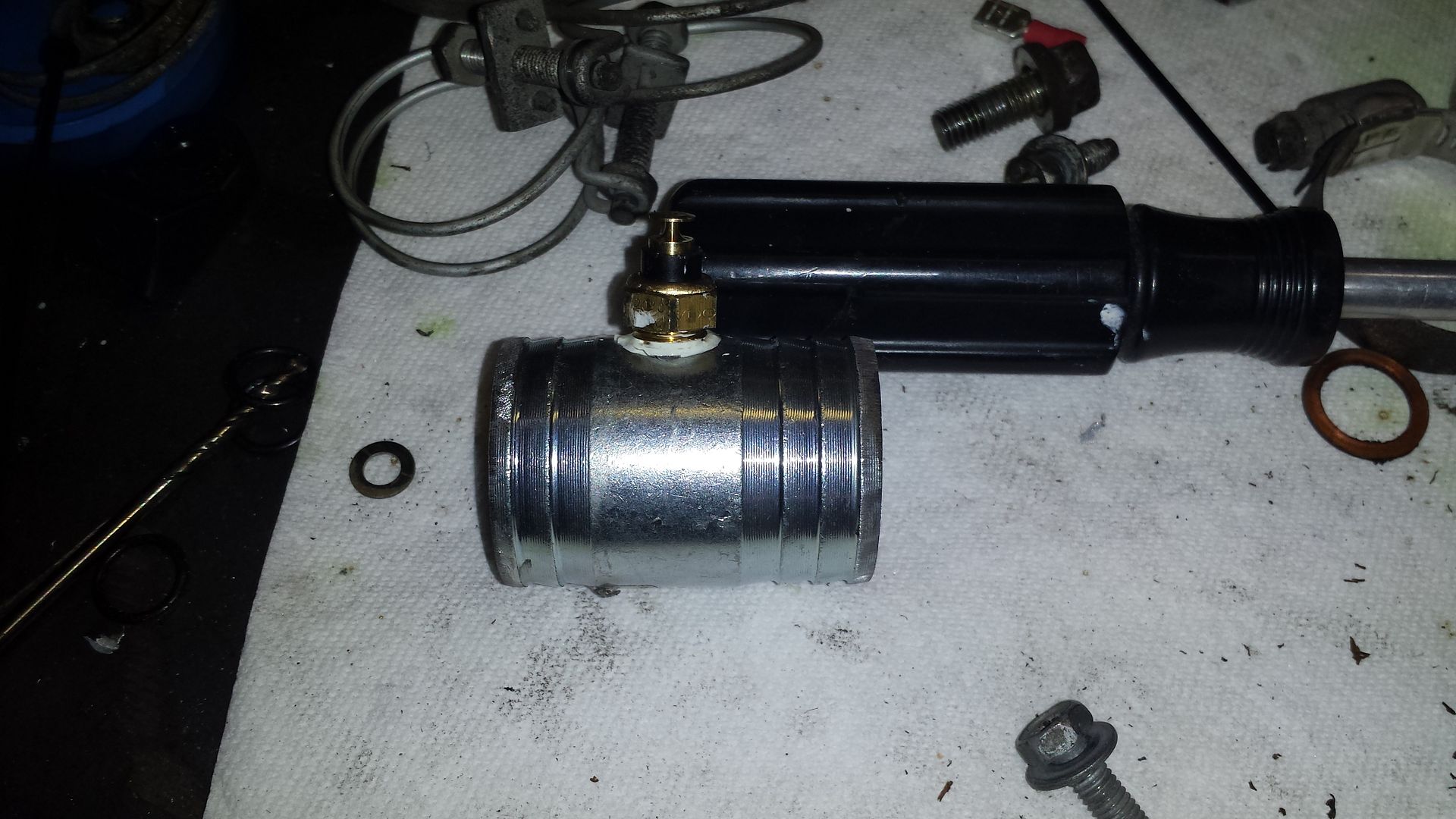

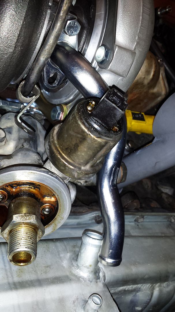

Custom coolant temp sensor pipe I made

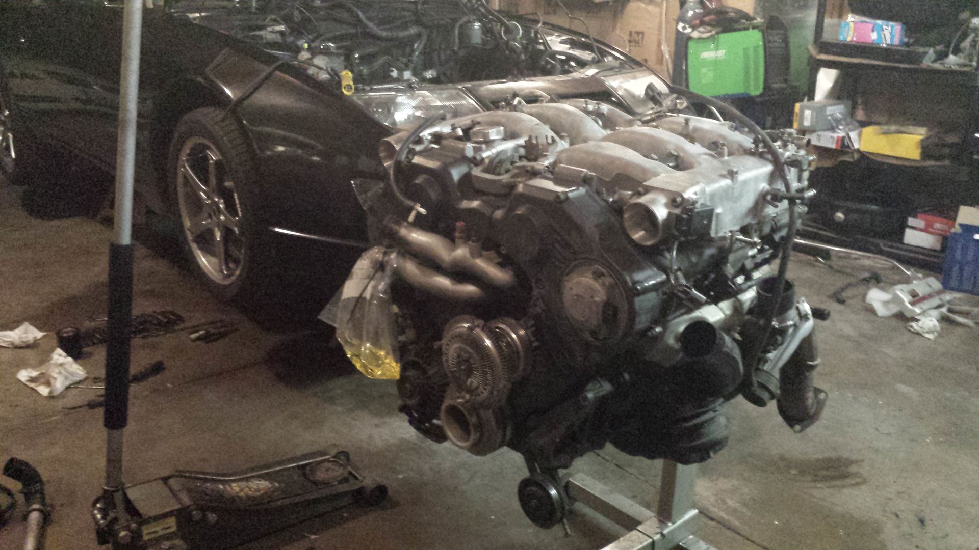

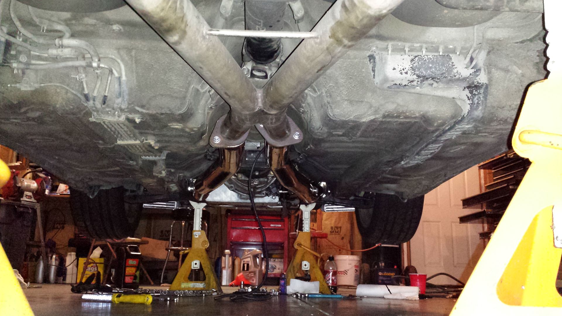

Exhaust going on

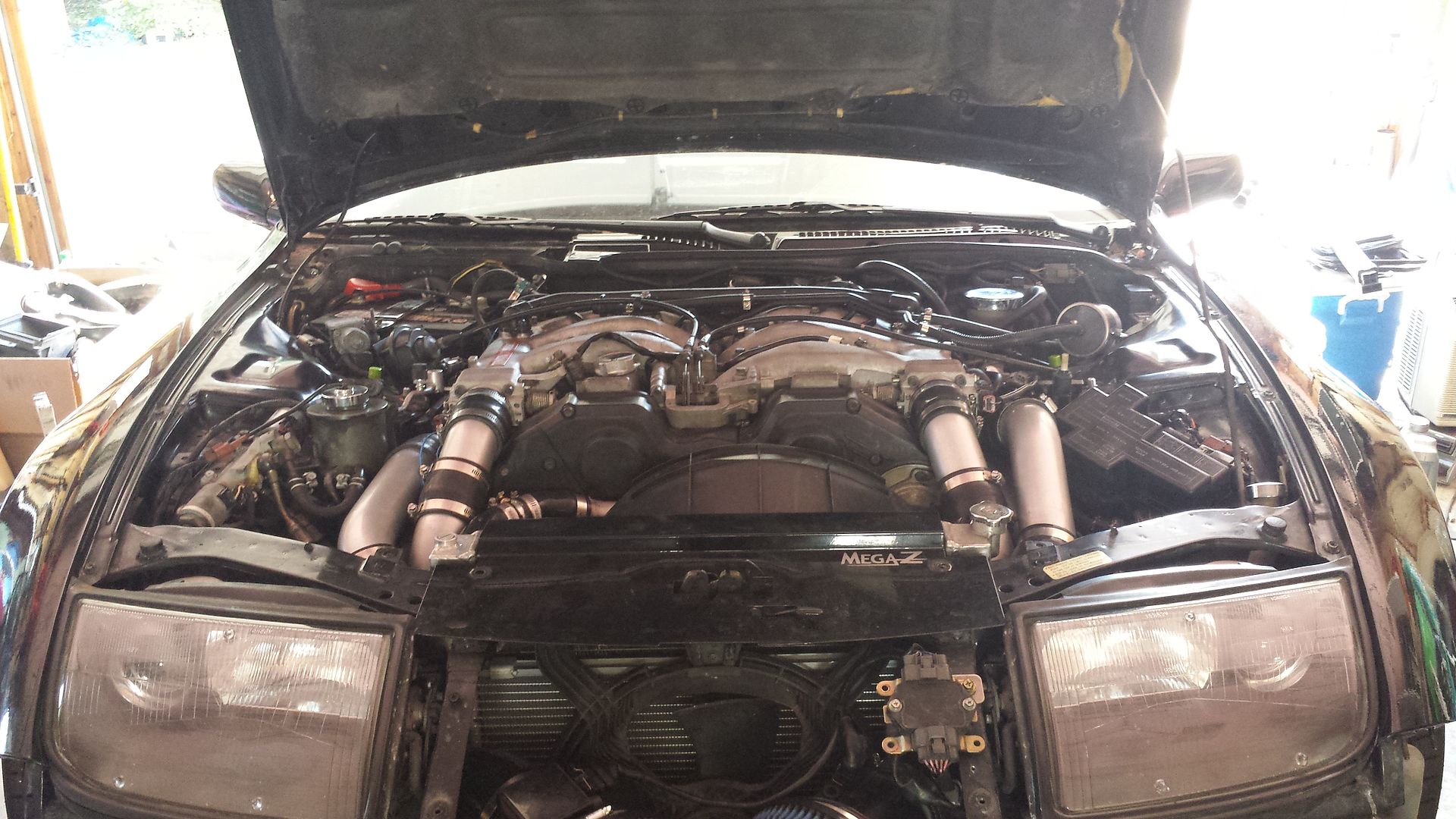

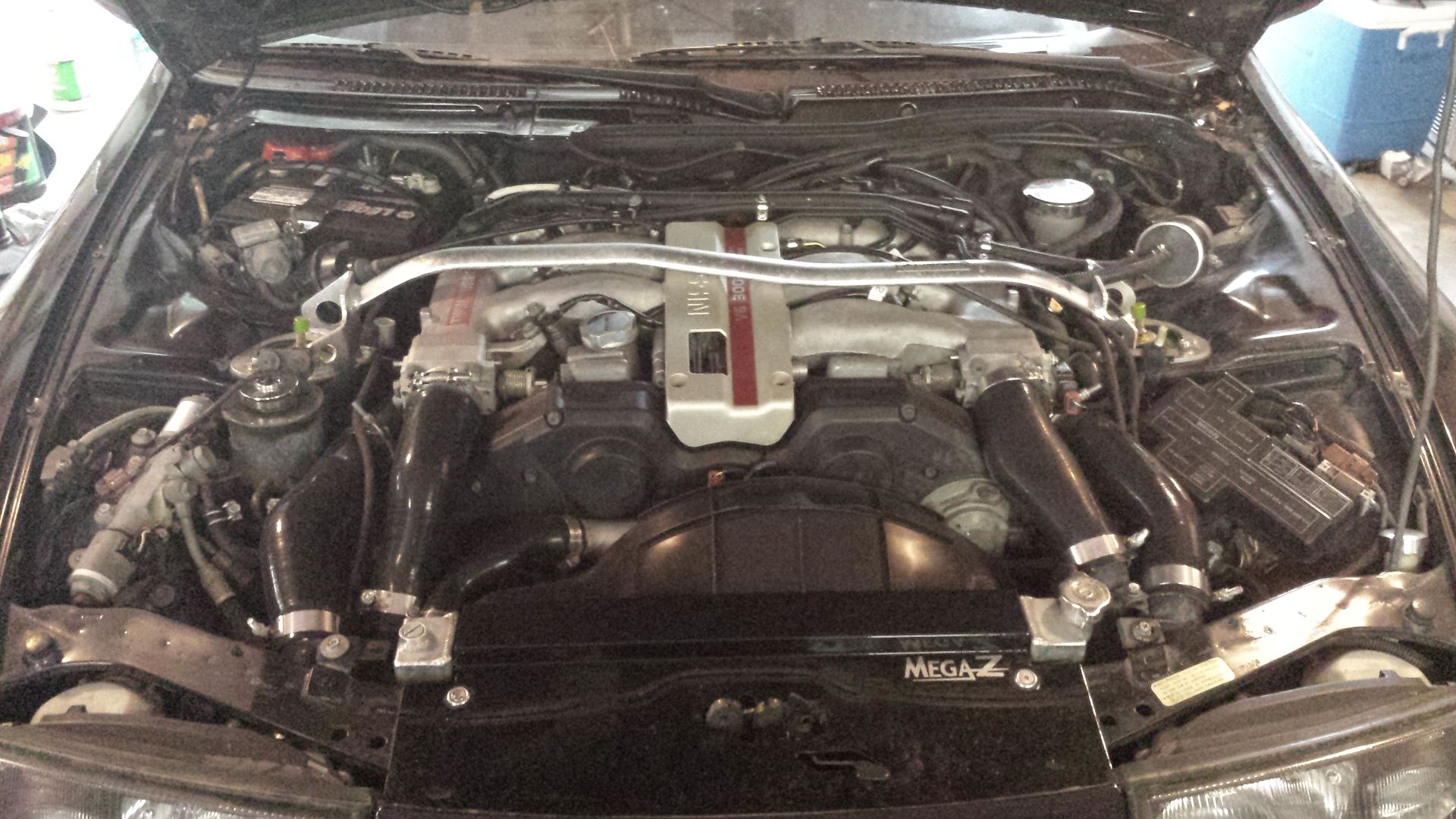

Getting close

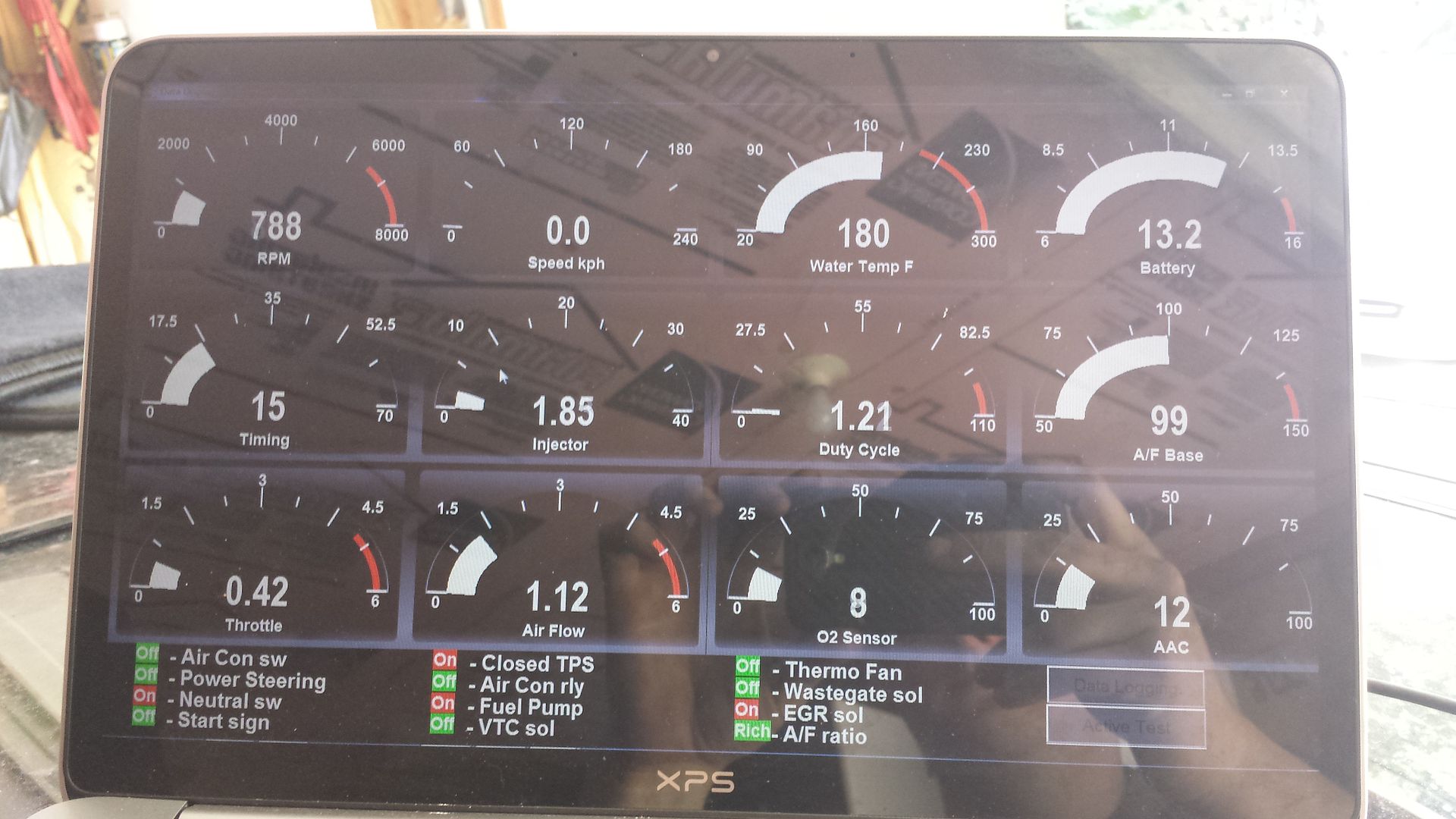

Up and running. Checking the vitals
WB02 Sensor wiring and routing

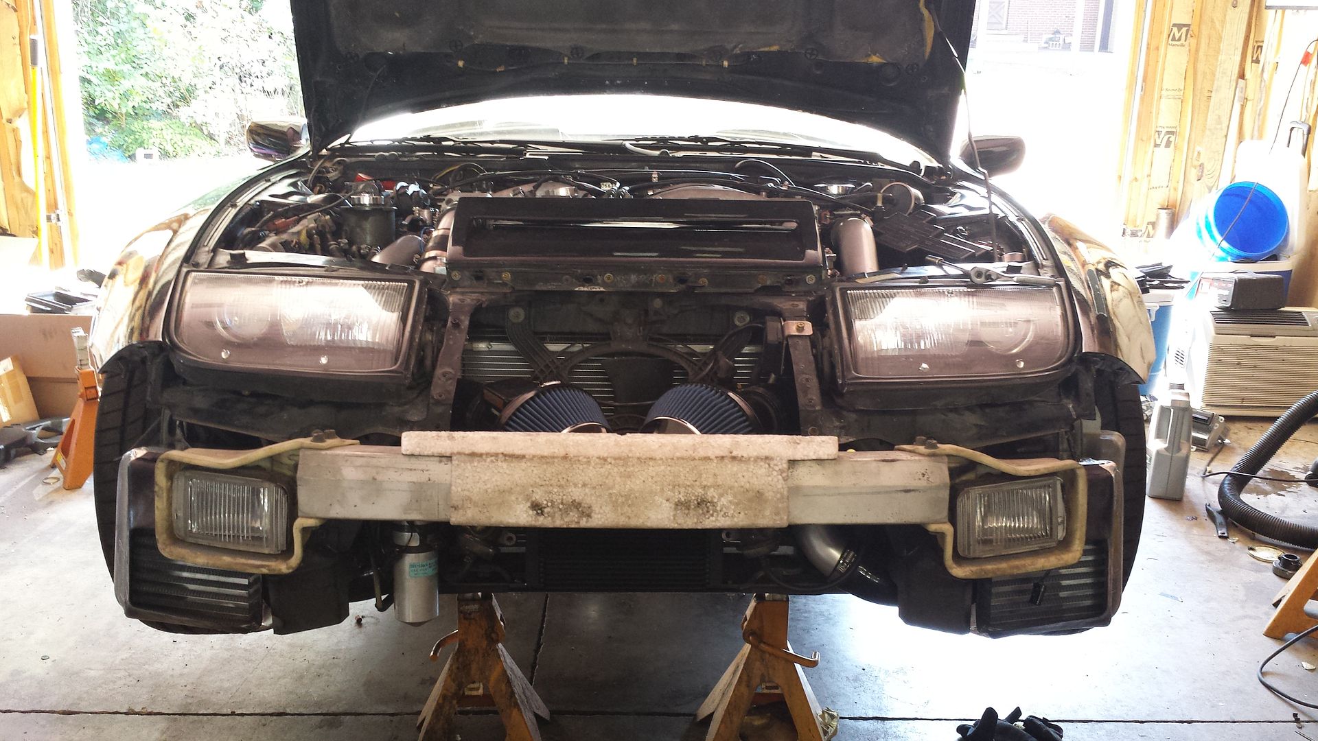

Front end going back together

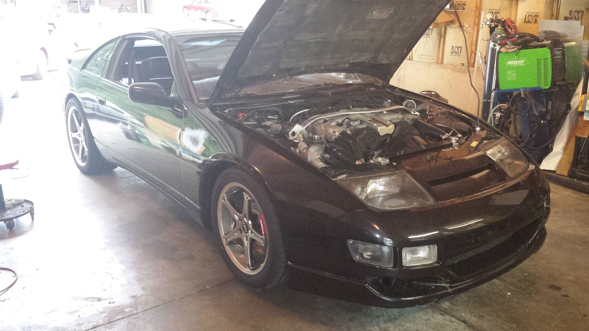

Back on the ground!

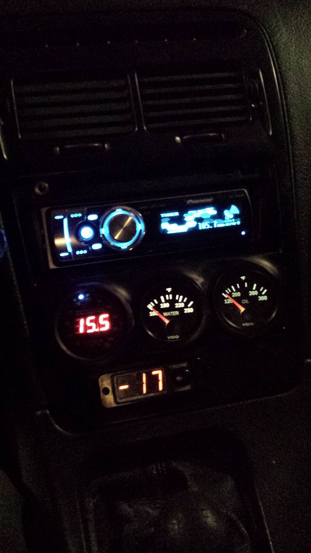

3 gauge DIN panel installed and gauges + boost controller
