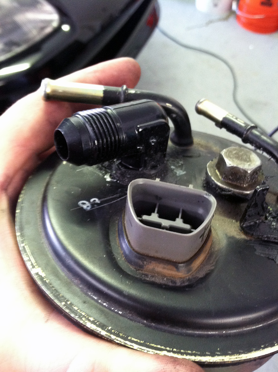

Message I would go with two 4E85's.
8an feed with with factory return
Arm the 2nd pump @ X psi once you start tuning.
Simple. And leaves you a lot of room for WHEN you upgrade :)
I did this exact setup on my Supra and will be doing the Z this fall.
Here are some pics of the setup...I joined the pumps in the tank and came out of the bulk head with a single -8AN. Much cleaner IMO
