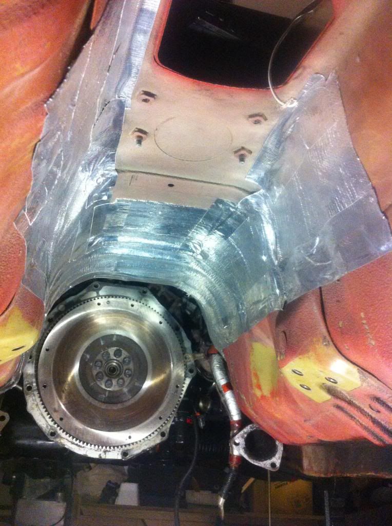

Message Definitely don't feel the heat as much as before, but I want to finish the rest of the trans tunnel. I got the cheap(er) just reflective stuff off of amazon - good up to 2000 F, or something like that. I used reflective duct tape around it just to make sure it doesn't go anywhere. Cleaned the surface pretty well too, if there is grease on there it wont stick for very long, if at all.
