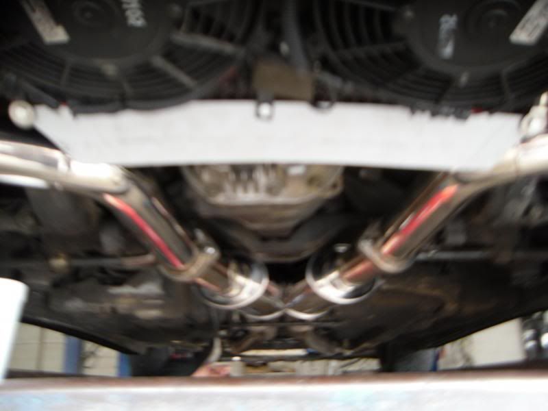

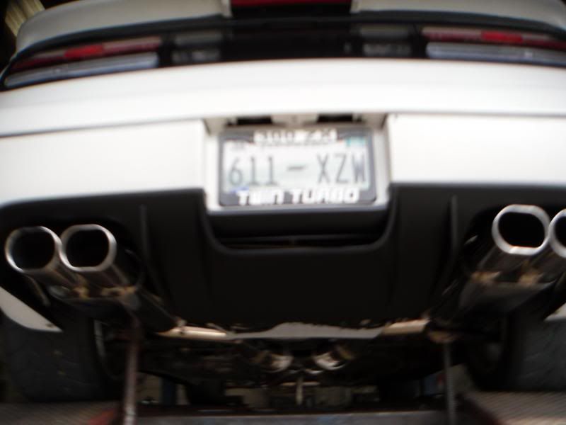

Samsung camera would not focus that day.
H pipe with large resonators

I have full 3" exhaust. SZ downpipes and resonated testpipes
Alan (TN)
20:49:39 09/05/13
Which vibrant model did you use ?
ztunerz
22:20:28 09/05/13
Vibrant p/n 1142. I'll get you some pics.
Alan (TN)
12:26:47 09/06/13
Pics would be really helpful. Thanks (n/m)
ztunerz
13:01:50 09/06/13
I apologize for the poor quality pics. My cheap -
Alan (TN)
16:36:25 09/06/13
Here is one before the resonators were installed
Alan (TN)
16:46:03 09/06/13

petedakilla did the same thing with his x pipe.
michaell32 (FL)
18:27:35 09/06/13
He used the same part number. He did not notch his but
Alan (TN)
06:02:38 09/07/13
When you notched them did you have to weld anything shut
ztunerz
22:06:53 09/06/13
I welded them shut with 304 stainless (n/m)
Alan (TN)
05:53:26 09/07/13
If you are really precise you can butt weld the two
Alan (TN)
06:09:52 09/07/13
