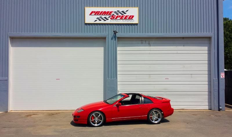

Oh, the other major mod was selling the Iforged Aero wheels to a good Z friend and getting some CCW SP500s =) (Im a wheel whore)
